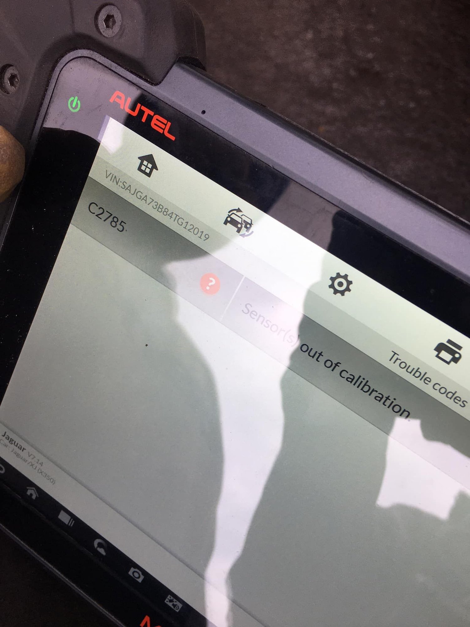

Hello, I've had a loose positive battery terminal (bolt was broken, had a vice grip on it) for a couple months now and occasionally the car would shut down and restart mid-drive. After fixing the terminal it no longer happened. The day before I took it in to get fixed however, I noticed the traction light was on along with "DSC not available text". The suspension was also quite stiff like it had been pumped up to max setting. Additionally the doors don't look with my fob. Battery is 2 years old. Took it to my indy mechanic. He cleaned the ground terminals behind the front headlights, did a hard reset and then read the codes. Only that that came up was C2785. He did try a thing on his computer for recalibration but it required a code on the top of the steering shaft. Not sure what to do from here. The x350 fb group suggested I use the code from an ebay listing to try and recalibrate it, but maybe its something else?

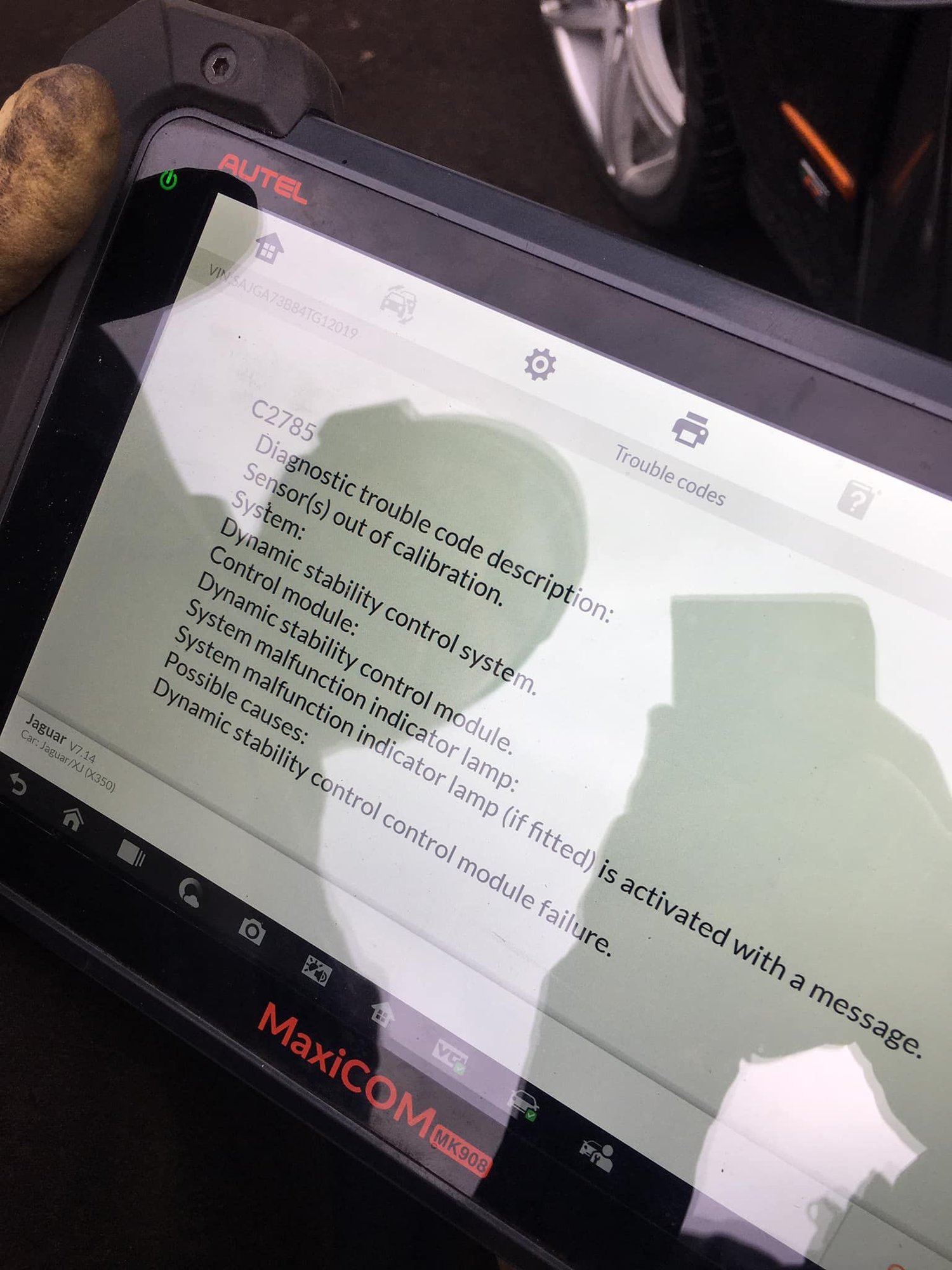

I think the approach is wrong, the DTC C2785 does not affect the steering angle sensor, but the Yaw Rate sensor. It is located in the J-Gate assembly on the right side and there is no need of codes from the steering column. .
First the vehicle should be read out with SDD (original Jaguar OBD software). If SDD confirmes the DTC C2785 particular pinpoint tests are provided in the WSM. The sensor is measured electrically and i.e. checked for power supply, ground fault, high resitance. SDD provides the test information and is able to calibrate the sensor.
The sensor is not necessarily defective, but it delivers implausible values. Cause can also be a ground fault or a too high resintance at a connector.
I would look for an independent workshop that deals with Jaguar vehicles of this decade and has access to genuine OBD equipment.

Another vote to get the car hooked up and read by an SDD. Your code points to a bad YAW sensor but I hate to throw parts at the car until we are sure of the problem.
