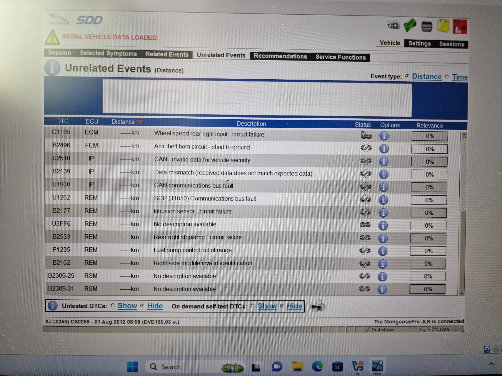

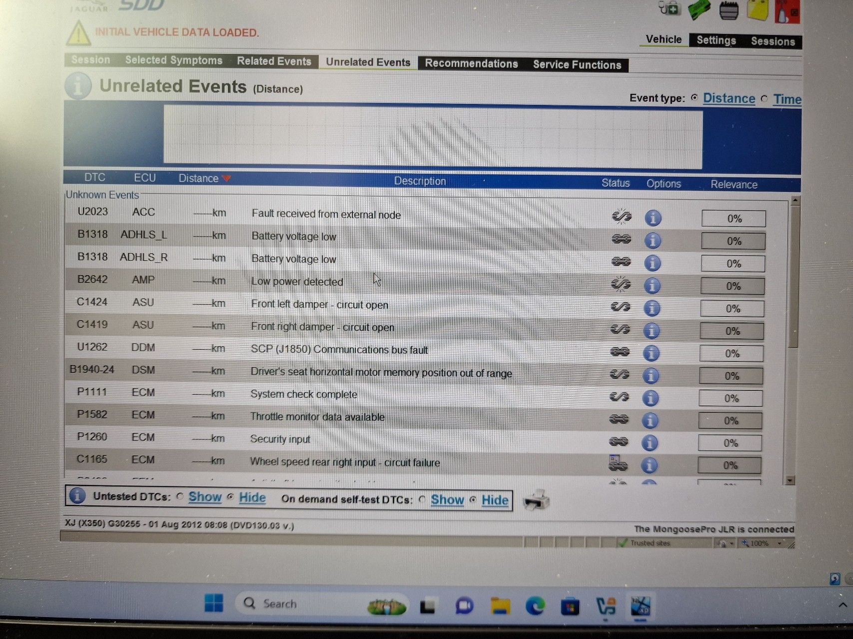

If it can be of any help, please find attached below the SDD DTCs during issue '5' where the car immobilizes itself.

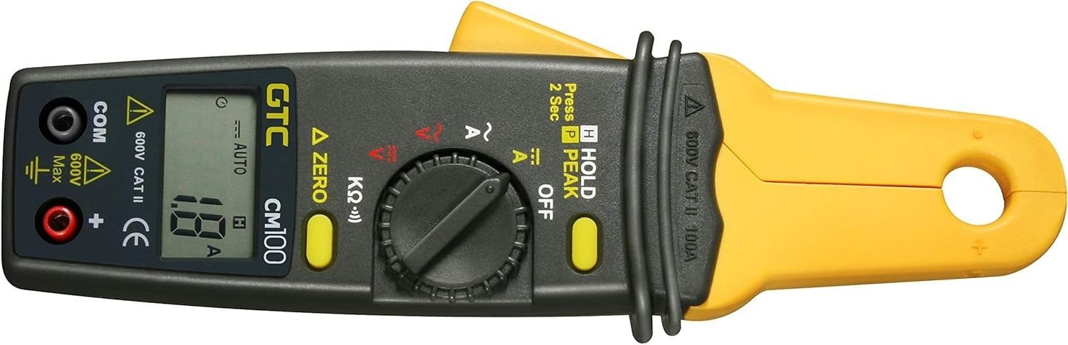

Have you seen the Jaguar "VEHICLE QUIESCENT CURRENT TESTING" document? I have attached it. Gives some current drain specifications for different Jaguar models.
I don't use the old fashioned method of putting your meter in series with the battery cable to measure current draw. One it's real awkward and you will be always waking the car up so you need to start all over again with waiting for things to go to sleep. But the worst thing is it exposes your meter to potentially high DC currents that can burn the meter out or pop the fuse in seconds. The better meters like Fluke will have re-settable circuit breakers to protect them.
That can't happen with the clamp on meters. Plus again the ease of use as you can rapidly go from wire to wire without disturbing the car. You do want one that can read low ma DC currents as that's what we are looking for.
I use this GTC meter as it will measure down to 1 ma DC. It's a GTC CM100.
But there are others that should work just as well.
It can be a big job and I have spent hours tracking down current draws.

  2. The drainage issue still persists and at the time of this original post (April, 2025) I put my Brymen BM869s multimeter in between the negative battery cable of the Jag and the battery itself. I measured twice for roughly 12-16 hours via an optical datalogger on Windows, connected to the multimeter of course. Once when the battery voltage was at it's max (12.8+ volt) and once when it was lower (12.6- volt). This yielded in the following results:
With lower battery voltage the car experiences HUGE peaks in current while it should be asleep. These peaks can also be measured via my external bluetooth voltage monitor which I have installed on the car battery. During such peaks the car's battery voltage drops by a large amount (e.g. 12.5 volts to 12.25 - 12.3 volts). Of course these peaks can also unsettle the stable module thus resulting in lots of logged error's. So far I have focused my attention on: "B2496: anti theft horn output circuit short to ground". As far as I understand in the electrical diagrams this is connector EC36-20 (FEM / Connector EC36 / Pin-20). The FEM is able to activate the "horn relay circuit" by switching to ground. The horn, which is actually a dual horn system, is on a LHD car like mine located at the left front wheel near the bumper. The horn itself is connected through ground point "G1AR" (which was severely corroded). The FEM can call upon the horn circuit in case the alarm system is activated. Hmm...
I haven't yet been able to run SDD on the car now that the ground point should be fixed, but according to my wireless volt meter the issue is still present. I disconnected the trickle charger and low and behold the car almost immediately broke itself and all electronics froze - due to the voltage drop caused by running on a healthy battery at 12.8 volts instead of 13.5+ volts of the trickle charger @ 5A. It then showed the exact behavior (no central unlocking, no crank, etc.), but battery drainage was only 0.05 volts per day. This is interesting information, because it probably means the issue is purely related to electronic issues (e.g. modules powering on circuits when they shouldn't), instead of physics problems such as a bad/defect diode in the alternator for example. The main suspects are the FEM/REM who also control an additional switched power supply circuit.
I've also confirmed that the battery backed sounder for the security system is working correctly (located in the wheel arch / liner at the rear right wheel). This seems to be a common issue on older Jaguar's (XK100, X308 and below). Of course I won't be entirely sure if there isn't any corrosion or other shenanigans, but the alarm goes off if power is disconnected and the beeper also beeps if I lock the car with an open door. Functionally they seem to work as expected.
Currently I'm out of ideas how to further proceed with investigation. I have pulled fuse F25 (Horn circuit), which should have made the horn circuit non functional. If there really is a short to ground causing issues, then this should yield in interesting results. Athough the short might be solved now that the earth points have been fixed. My gut tells me the most logical step to proceed is to either physically inspect the FEM for possible corrosion and start measuring pins, or by utilizing SDD to find interesting information about the wake-up statistics of modules, possible voltage issues etc. If it really is the horn circuit causing issues somehow, then the car really told me what the root issue was via it's computer system all along. All the other SDD DTC codes are presumably due to low voltage or noise on the SCP-network. I feel like the short circuit B2496 is a valid DTC which shouldn't be ignored or caused by low voltage.
Once again, thank you all so far for taking the time to write extensive replies and sharing your own experiences/thoughts!

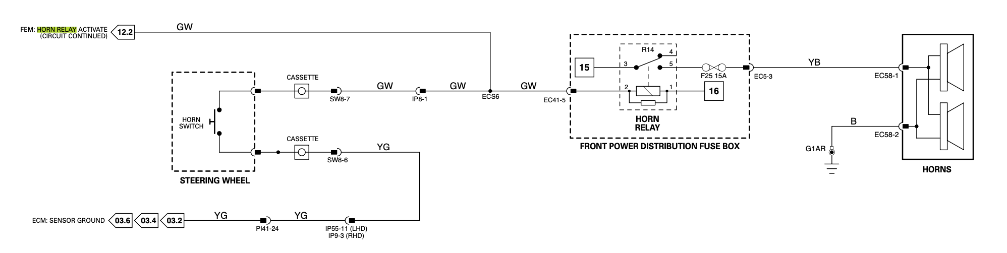

Many (most?) 'short circuit to ground' faults are caused erroneously by low voltage. I would not worry to much about the B2496. Even if it is an actual fault the draw should be small and consistent.
Old Dec 25, 2025 | 03:34 PM
OldKarz's Avatar
Joined: Apr 2019
Posts: 539
Likes: 129
From: Ontario
Just for the heck of it jumper your hood/bonnet switch and see what your voltage/current does over a period of time. They can be intermittent and keep the car from sleeping properly.
