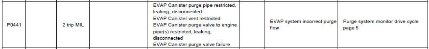

Hi Peter,
Here are the definition and possible causes of P0441 from the Diagnostic Trouble Codes Summaries, which I am attaching.
For the location of the purge valve, see pages 27-28 of the Technical Introduction, which I am also attaching.

Hi Wingrider. I have not had the time to explore this further. The engine light is still on after clearing codes. P0441 Evaporative Emission System Incorrect Purge Flow. If the purge valve hose is disconnected as shown with blue arrow, woudln't that cause a vacuum issue? I had the tube off but no change. Could it maybe be the Evap Emission Canister Purge Value itself? I could hear something with the stethoscope but hard to know if that is what I am hearing. I heard that to replace the charcoal canister the rear differential would need to be dropped. Is that right? I thought starting with the valve might be a cheaper route.
Any thoughts? Thanks. Peter

Looks as if evaporative canister purge valve might be under the left front fender
Look on you tube
