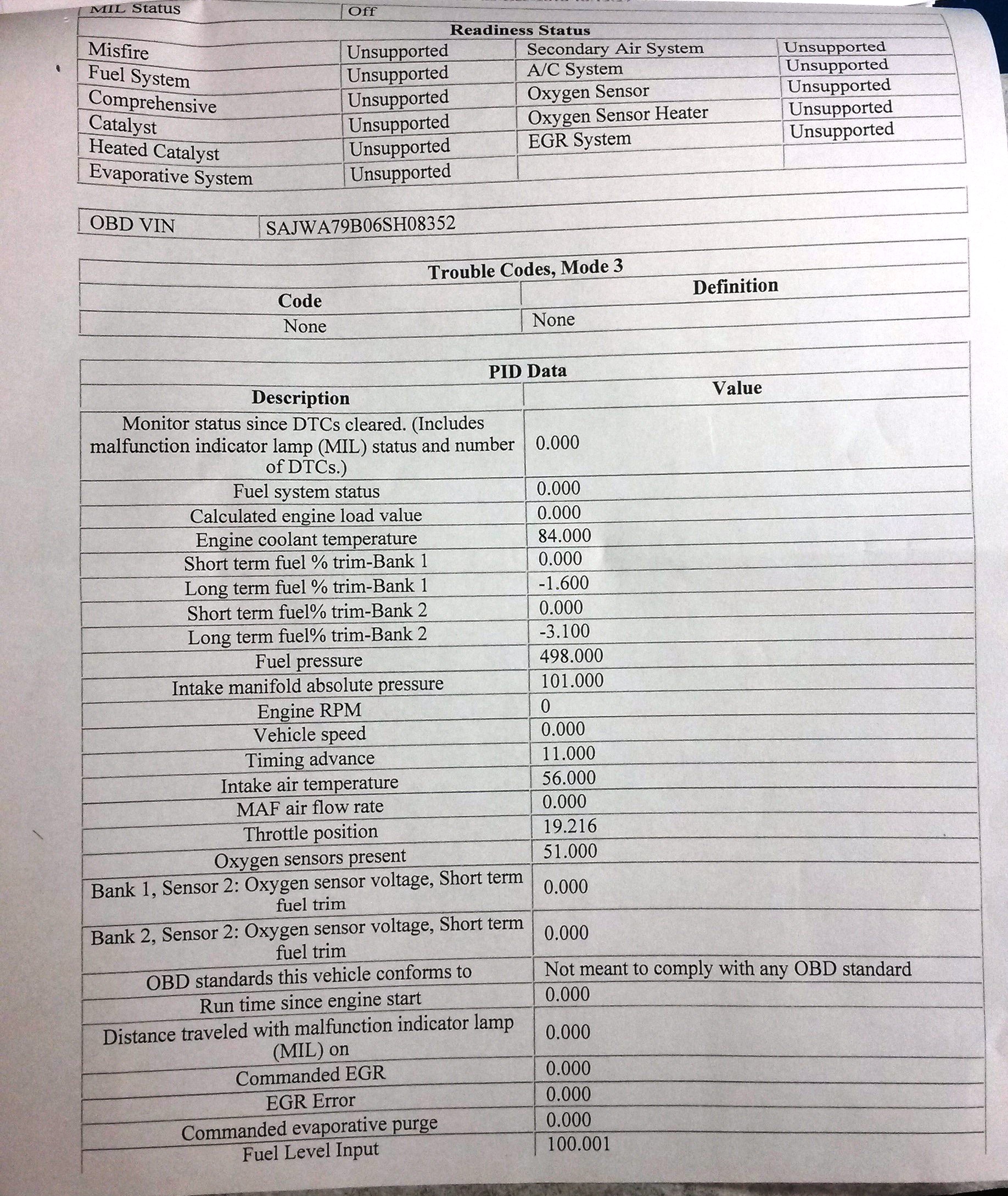

These are the printouts the smog referee gave me, I don't understand them yet...

In about one minute the Pep Boys technician with his cheap pocket scanner on the "I/M" (Inspection/Maintenance) page found the readiness monitors reading "n/a" which happens when no car-to-scanner communication.
That exactly duplicates what the California smog referee found the readiness monitors reading "unsupported" due to no car-to-scanner communication.
The Jag technician with all his training and expensive equipment couldn't find this simple problem I will have to show Jaguar how to do it!!!

The readiness monitors are not reading on a pocket scanner or California state smog referee's machine. This seems pretty clear to be a car side problem and embarrassing for Jaguar their technicians with factory equipment can't find a problem that a Pep Boys employee can find with his cheap pocket scanner.

Even the cheapest code reader will display P1000 and P1111.
P1000 means one or more monitors not ready.
P1111 means all monitors ready.
