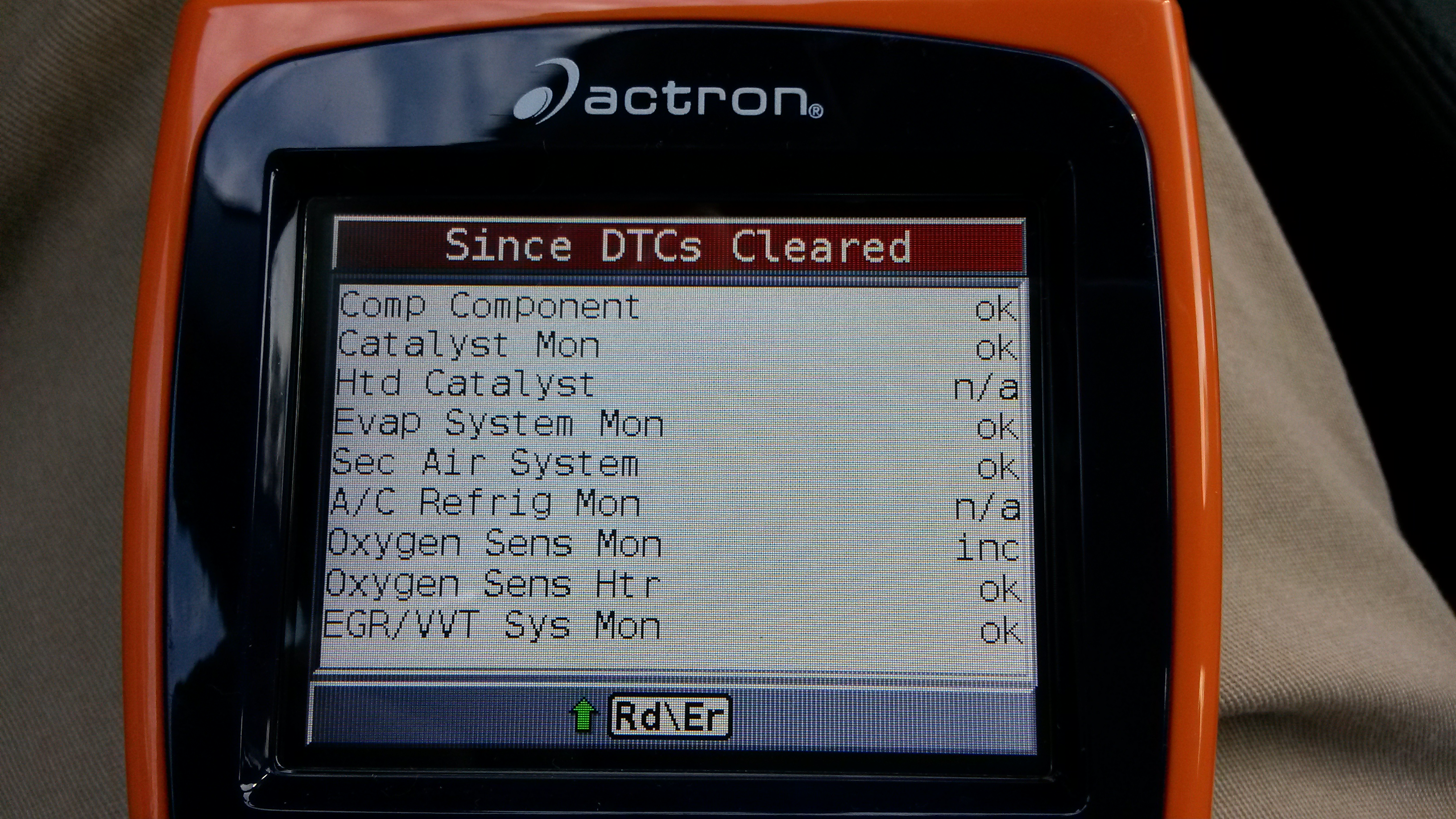

Purchased a code reader with live readout for $141. I read reviews of the recommended $5 ELM units and they said need to purchase additional software for phone or laptop, some of that software contains viruses, and want a simple and reliable cable connection.
Took about six minutes to hook up because connector doesn't just snap on, rocks back and forth and have to rock into position for data connection to be made.
All monitors set except heated catalyst and refrig reads n/a, and oxygen reads inc. We've done multiple dangerous freeway drives at 50mph and 3000+ rpms with the recommended 30 second coastdowns to zero mph.

Thanks God passed smog check today, this part of Jag nightmare over. Jag dealer had done a "hard computer reset" and "reflash computer" then after 345 miles "Oxygen Sens Mon" was the last one incomplete. Drove 1 hour through Los Angeles mountains in second gear which is high rpm with low speeds and aircon on, and then all monitors complete! It was about 500 miles total to set them all, and the Jag dealer said 1-3k miles is not unusual.
Now only current issue is possible overheating and will take that to another thread.
GJJ, I don't know what "Comp Component" is and mine set pretty quickly, and if you part out your car I'll take your seats because I need the picnic trays.
