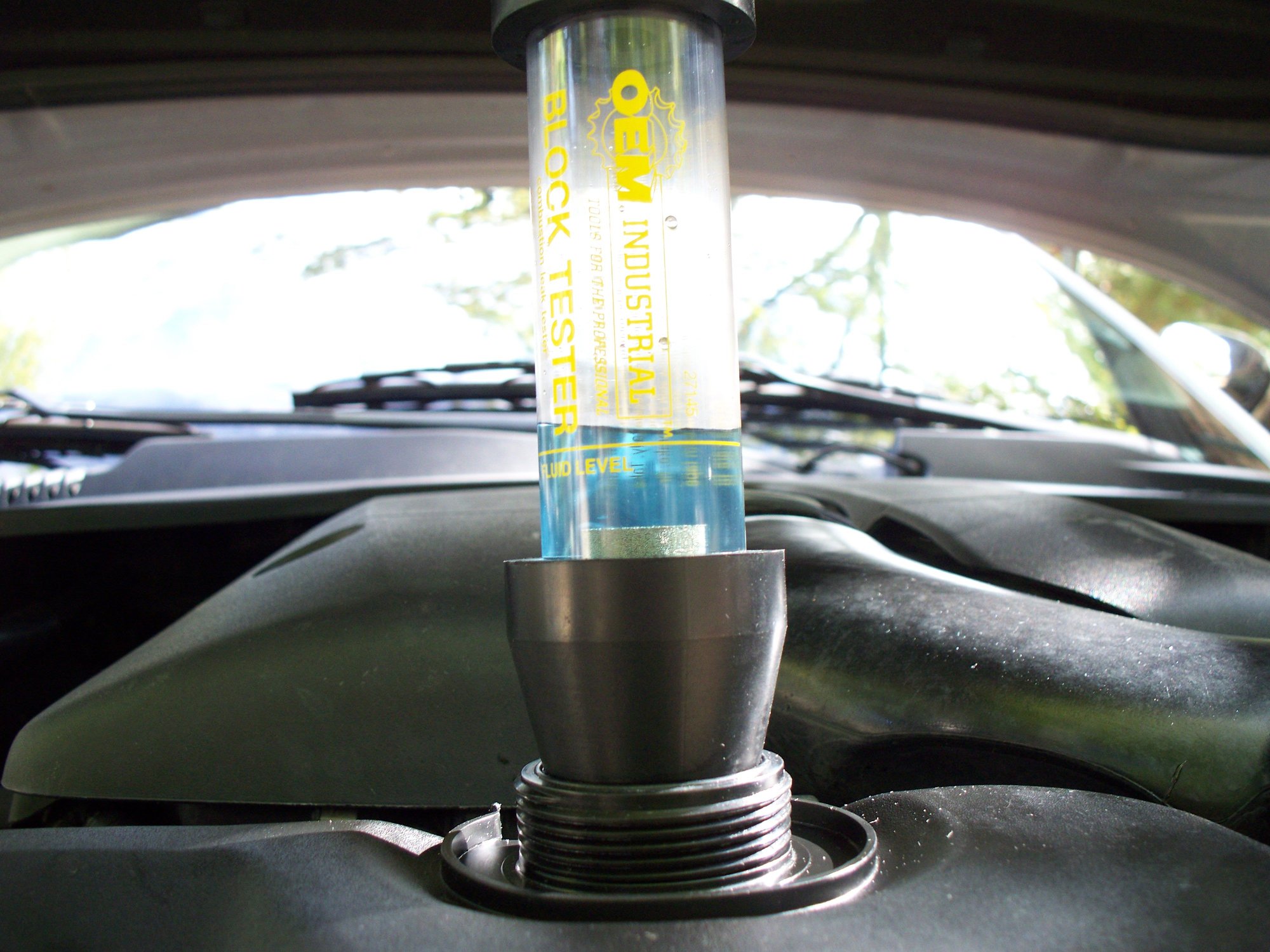

- How are you testing coolant for combustion gas?
- Beware that chemical test (eg, if dye in test cylinder turns yellow...) may give you a false positive with coolant that's been contaminated by bad head gasket (ask me how I know this)

I did use a chemical testing kit to test for combustion gasses when I was seeing coolant blown back from the pressure cap. So the gasses do not dissipate over time?

One thing to be cautious of is that while you are squeezing the bulb to draw fumes through the test fluid, if any wet coolant gets inhaled into the test tube it will turn the fluid yellow and create a false positive. I think I recall that the instructions for the kit I have (made by Balkamp and purchased from NAPA) state that the coolant level must be at least 2 inches below the end of the rubber tip of the test tube, and if the coolant level is too high, some should be suctioned or drained out to lower the level sufficiently before conducting the test.
