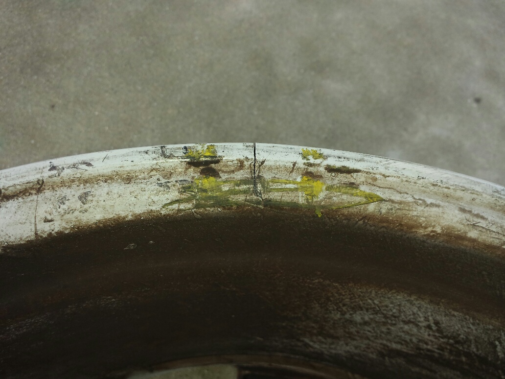

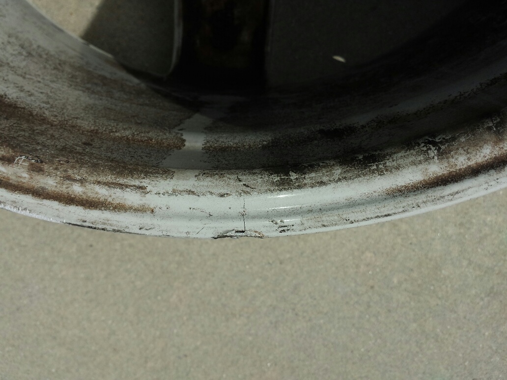

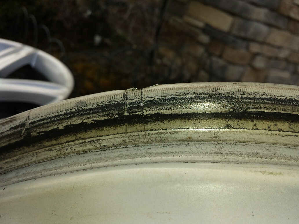

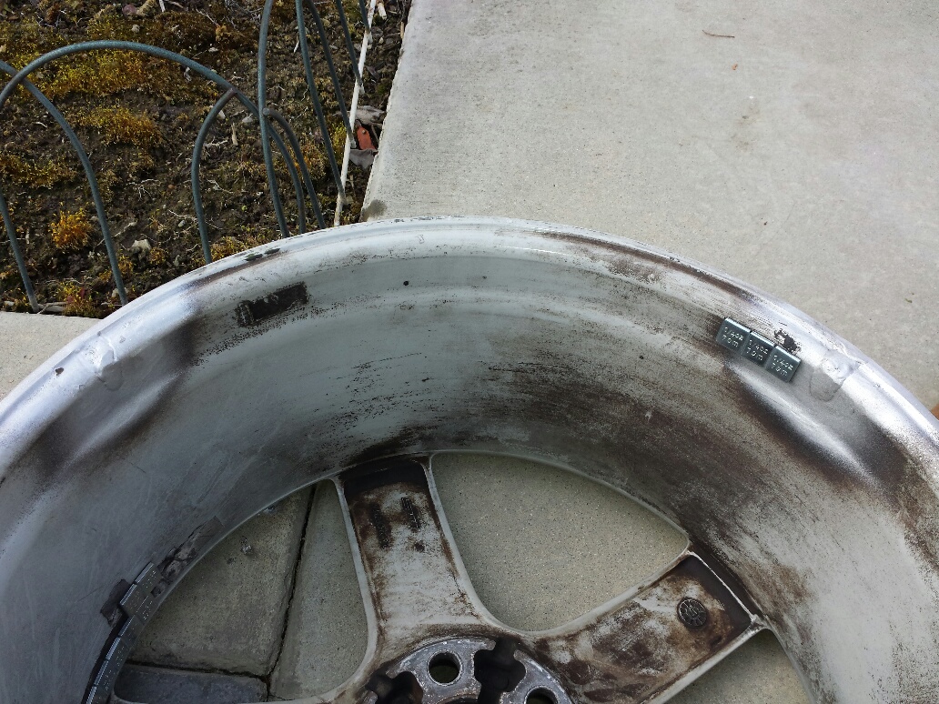

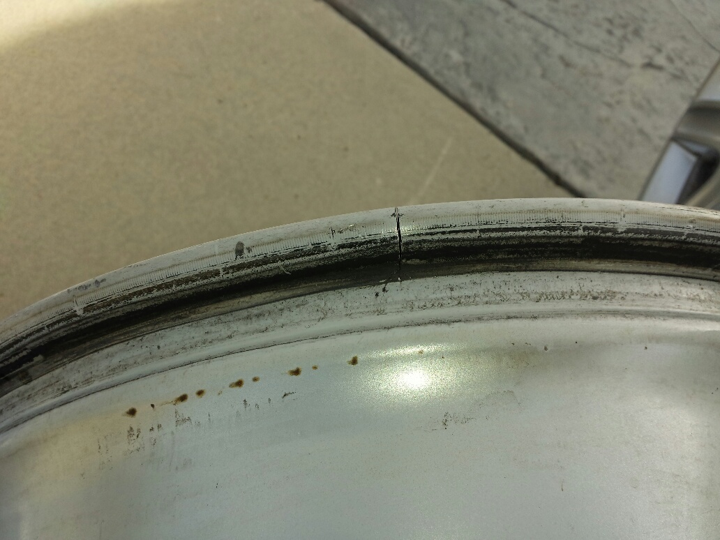

Attached are photos of the 20” Callisto wheels I removed off my 2008 Jaguar XJ Super V8, with approx. 80,000 miles.
Wheel 1 was the first identified to have a problem. On the onset of cooler weather the tire on this wheel started to go down. The problem was traced to two fractures on the wheel. This occurred on a Friday. As a temporary measure I had the tire weld repaired. The Repair shop was surprised to find the wheel perfectly round!
On the Monday another of the tires started to lose air and this wheel was also found to have a fracture.
I ended up replacing the wheels with aftermarket Coventry rims which will hopefully hold up better than the originals.
At that point I found that a third wheel also had a fracture.
None of the wheels were out of round and only ONE had slight damage at the point of fracture. I believe it is a fatigue issue, so if your tire's keep going down, check your rims for fractures!

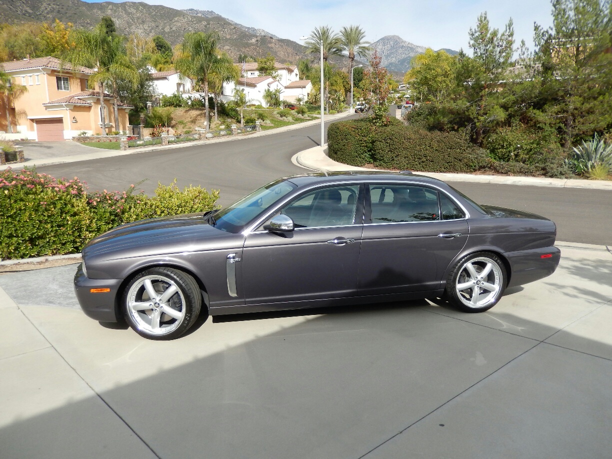

I replaced them with the Hornets because I liked the simple 5 spoke design of the Calistos...and easy to clean too!
Attached are photos with the Calistos and with the Hornets.

Very low profile tyres on large diameter wheels will stress the wheel castings as the tyre cannot absorb the energy from hard bumps.
To some extent I agree Fraser.
If I had a large Truck like SUV and put on cheap aftermarket large wheels/low profile tires, then I am asking for trouble.
However, if I have a luxury car with highly sophisticated suspension, and wheels that retail at $1200 each, I would expect that a good degree of engineering would have been done to make sure that this problem does not arise.
Looking at the number of issues all luxury car manufacturer's seem to be having with this issue, and jaguar by no means appears to be the worst, I presume the industry does not meet my same expectations.
