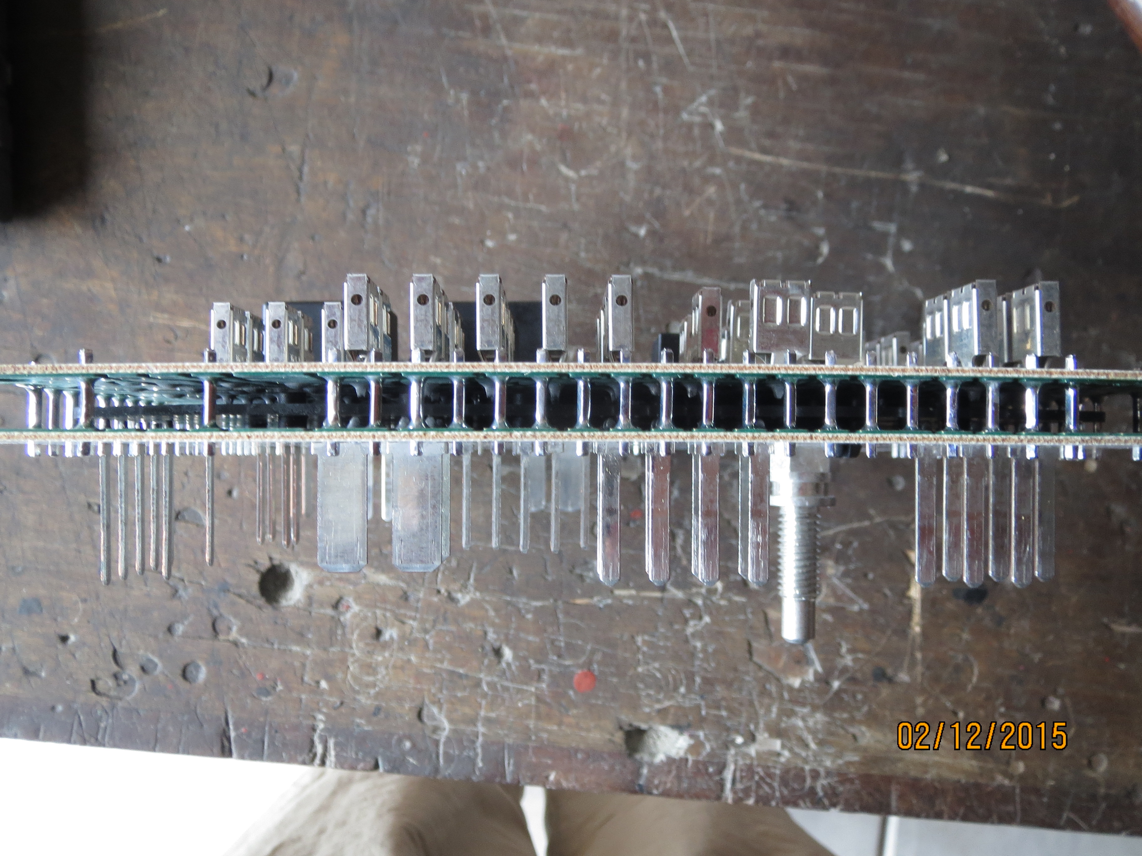

Does anyone have any pictures of the Front Power Distribution Fuse Box circuit board from an XJR
Im interested in Relay 12, which has failed

Hi
I have a spare fuse box. Without checking I think it is a rear one and the Jag model is
unknown but it is for an x350.
Removing the pcb is easy it just clips in but there are two soldered together with pins
about 1 cm apart. There are many, many pins.
Personally I would not attempt to separate them to gain access to the non servicable relays
which is I assume what you want to repair. However if you have a nice modern soldering iron with a tiny anvil
(which I don't have) I guess it could be doable.
pics attached.
Good luck

Thanks for that
From your pic they look easily repairable. Worth a go as a new one is not cheep
