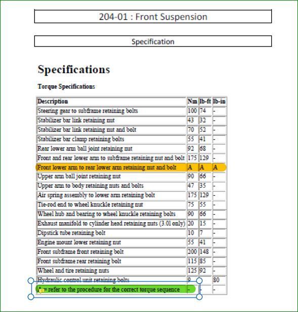

Dear Forum, I think I am going to need to get the curved arm out of my way to replace the shock bushing.
Please could someone explain what the highlighted bit on the attachment actually means?
Thank you, my torque wrench is ready and awaiting your welcome response!

EsRAy, if your question regarding "A" see highlighted in green
The correct torque procedure should be described in assembly section of shop manual. something to effect of:
The 'torqueing procedure' is for references. I am not sure I took it from appropriate section.
