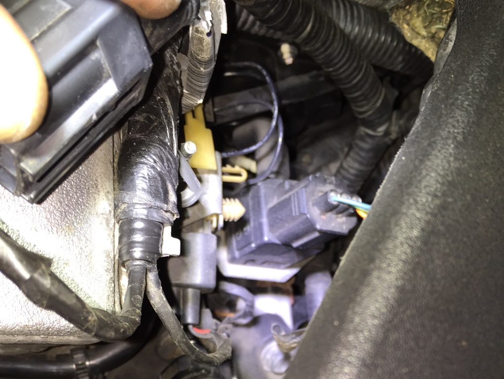

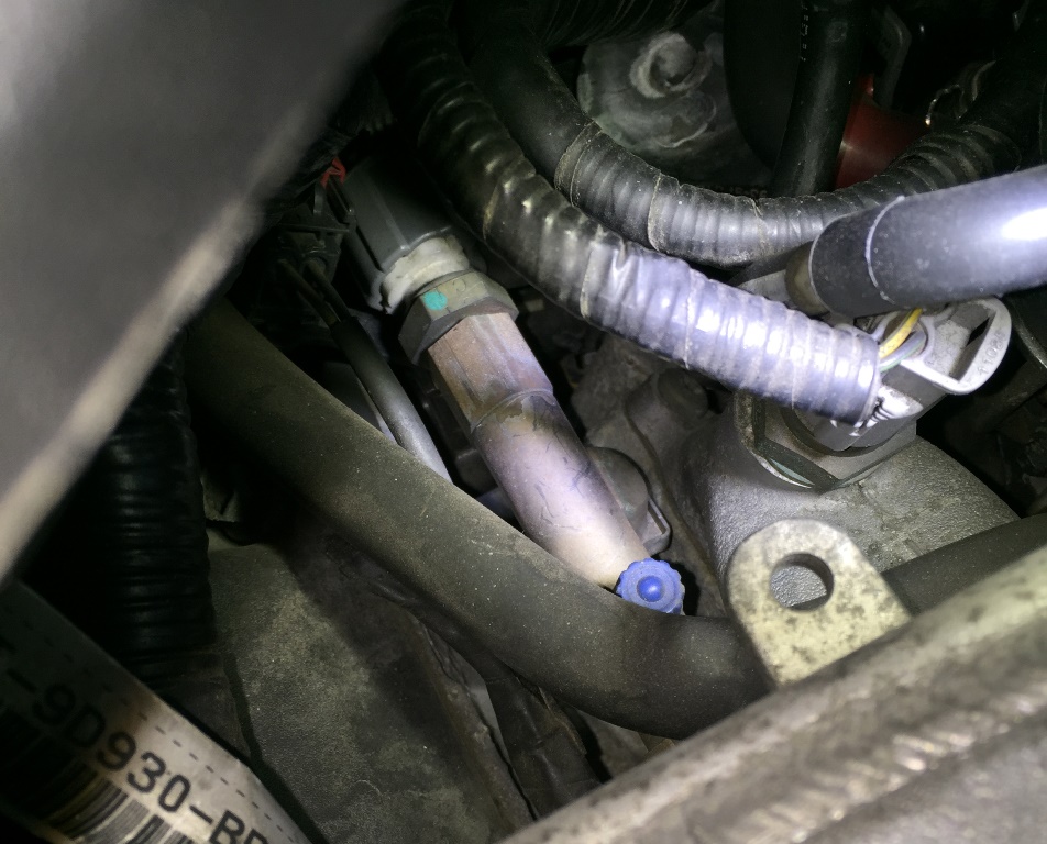

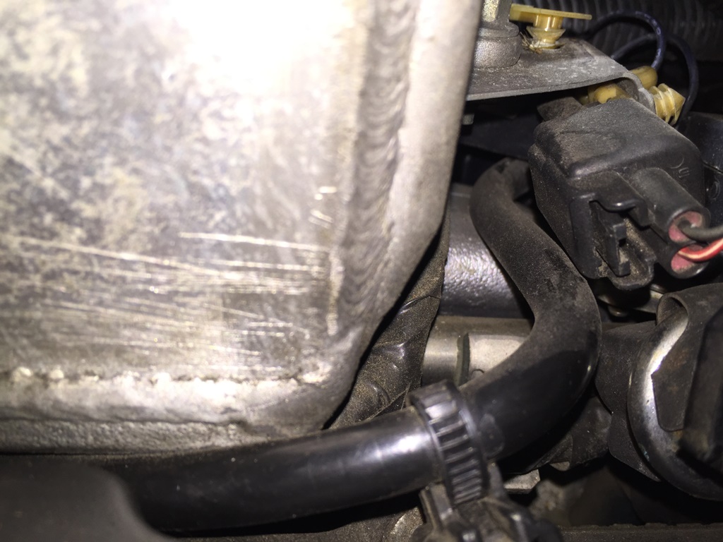

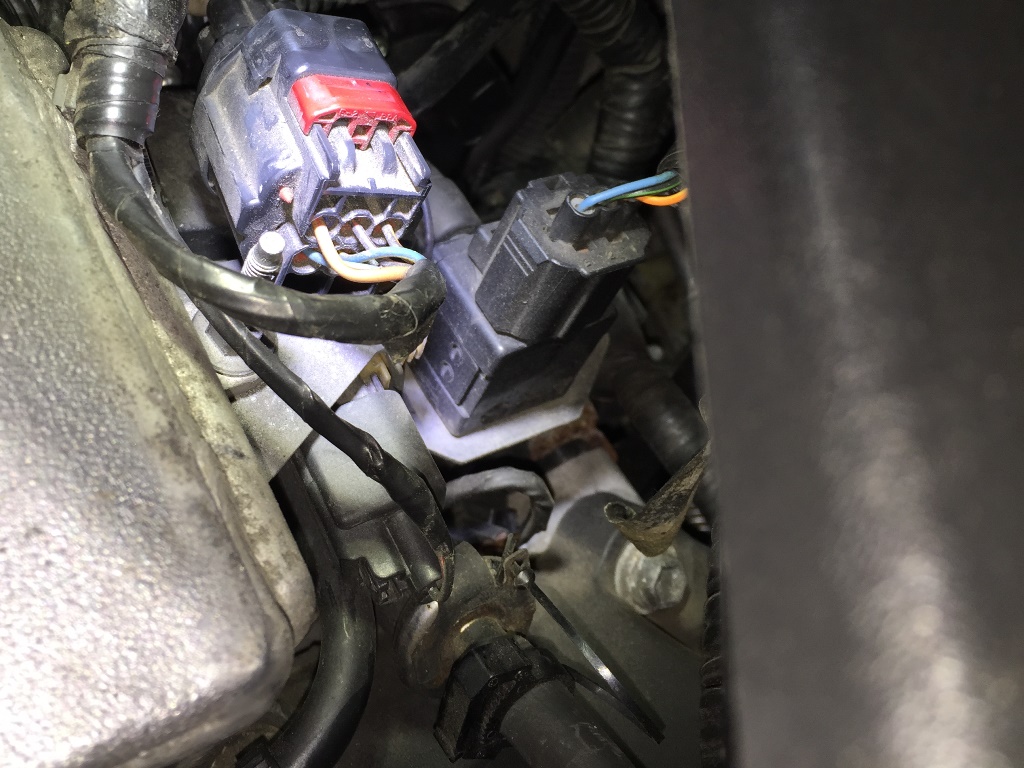

OK so it actually shouldn't be too hard to get a gauge on the line. It was staring me in the face the whole time. I was looking for the schrader valve which threw me off.
The hardline changes to a soft plastic line with a push-lock connector, you can see it in the left of the picture. The schrader valve isn't on that line. There is a 2nd line which looks like a return of some kind, I guess for the emissions. It's low pressure by the looks (plastic clamp) compared to the molded high pressure line on the left.
The high pressure line disappears into a black hole behind all those connectors, but I imagine it connects to the fuel rail back there. Funny because the JEPC shows the incoming fuel line goes on the rail below the pressure sensor, and outwards, not inwards. I dunno...
The pressure sensor is at the back of the engine on the left side looking forwards (not the right front like the XKR, or earlier XJR) and it does have a manifold reference tube. If it's meant to measure the differential pressure between the fuel rail and the manifold e.g. 15psi boost, 70psi fuel pressure = 55psi as per the books then getting 70psi shown on the SDD wouldn't be right? Maybe the manifold line is blocked/crushed? Maybe the sensor is duff?
The schrader valve is on the opposite side, on the other fuel rail (the little blue plastic cap) and you can see the fuel temperature sensor on that rail (grey connector)
If I was going to put in a gauge it would be on the incoming hard line, the scrader valve is virtually inaccessable....
But yeah, i'm wondering about the fuel pressure measurements.
Should be displayed as 55psi, not higher, right?
And it occured to me that the drop that I saw could be because manifold boost is dropping off in the high revs? (overdriven Eaton, loses boost in the top end?)
I think I need a better understanding of how the pressure sensor works. If it's meant to be measuring 55psi and it's not, that's something to look into further...
