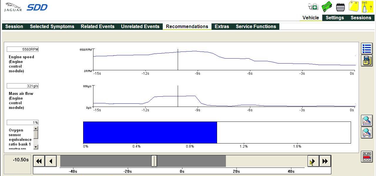

But you can see forum attachments, here's one, the rest of the pics look the same except 330ms further along.

The problem with the images not showing may be that they are
not publicly visible to someone without the user credentials. They
would be visiible to you since you have the credentials cached on
your own machine.
Turning to the one image I can see ...
I would log the following:
rpm
air mass
throttle position
absolute manifold pressure
ignition timing
fuel injector duty cycle
closed loop status
Having those datum in a synchronised timeline would be useful
in seeing any anomalies in the ECM view of the world as well
as identifying where you are at particular points of the test.

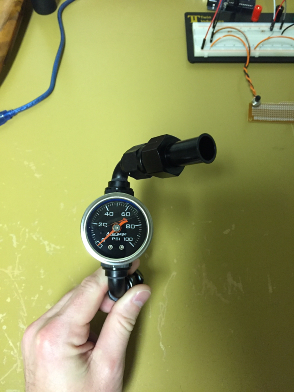

It is possible, given a sufficient quantity of AN fittings, to put a mechanical gauge in line.
What the EPA has against Schrader valves I could not tell you.

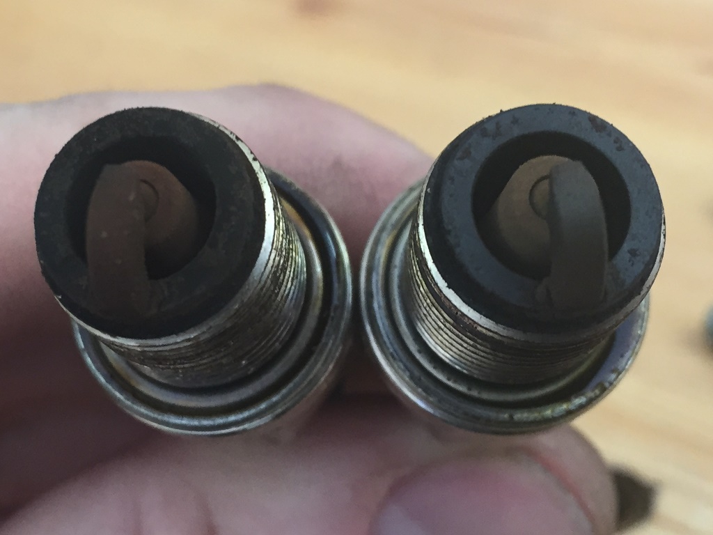

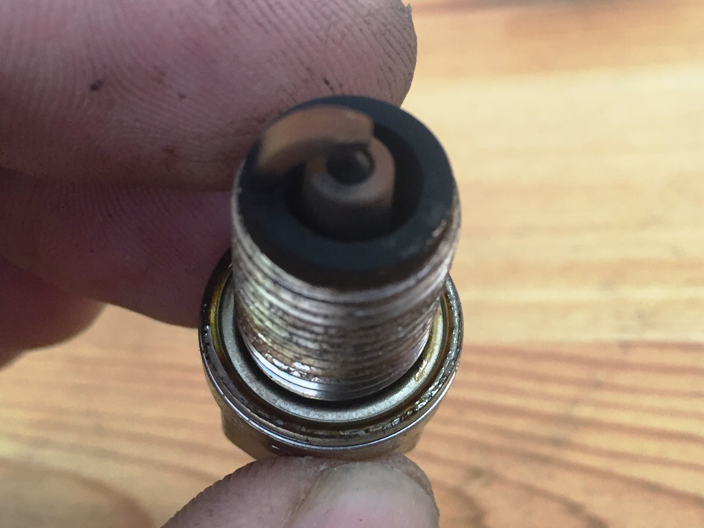

Plugs, coils and O2 sensors arrived today, pulled the old plugs;
Fuel starvation and massive detonation - RESOLVED-img_0628.jpg Fuel starvation and massive detonation - RESOLVED-img_0629.jpg
Fuel starvation and massive detonation - RESOLVED-img_0630.jpg Fuel starvation and massive detonation - RESOLVED-img_0631.jpg
Oops I forgot to take a pic of one of them...it was also sooty, not much brown unlike #1 & #8
The 3rd pic is #1 which is the same plug as previous pics, you can see the difference in colour and deposits compared to before. I guess that's the detonation at work...
4th pic is #6 (left) #8 (right) surprises me to see such a difference in the cylinders.
Detonation of the magnitude you're mentioning does not result in plugs that look like this nor does it appear that the engine is running lean. If anything it's way rich.
Are you sure there's detonation?
Old Mar 23, 2015 | 01:00 PM
  #115
MoscowLeaper's Avatar
Posts: 613
Likes: 356
From: Israel
Yep. For me the plugs looks like the AFR is pretty rich, no evidences of the detonation can be visible on the plugs.
For me it looks like there's no detionation, but it is possible that there's pre-ignition of the mixture from a carbon deposits in the cylinder(s).
If it was a one of my customers cars - i'd take a good look into the cylinders with a scope.
I agree that it is generally rich, always has been. Which is one of the reasons why i'm changing out the upstream O2 sensors.
What surprised me was the colour change and clumpy deposits on plug #1 compared to a few weeks ago.
The car has only done less than 30km since this all started, and most of those have been on the motorway with some WOT runs. So the colour change kind of makes sense. But the variation in colour between the cylinders is what has me wondering...
I've had a couple of cars in the past that pinged, so i'm pretty sure I know the sound. But it could also be pre-ignition like MoscowLeaper says.

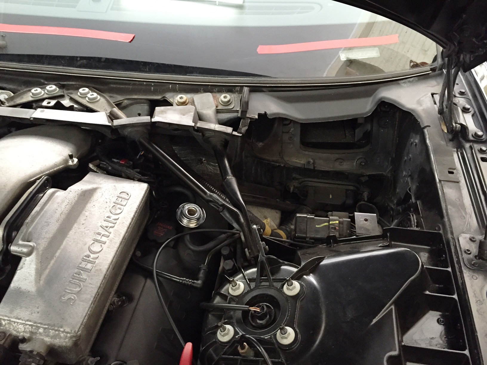

OK so I put in the new O2 sensors, and couldn't help myself, had to go for a drive.
So this is with new plugs, coils and O2 sensors. Still waiting on the fuel pressure sensor to arrive, probably another week...
The scuttle removed, no wipers, no cabin filter.
So it sounds awesome inside the cabin, except for the pinging...
Here's a recording, it's an .m4a file off an iphone, but I had to zip it in order to upload to the forum.
New Recording 2.zip
