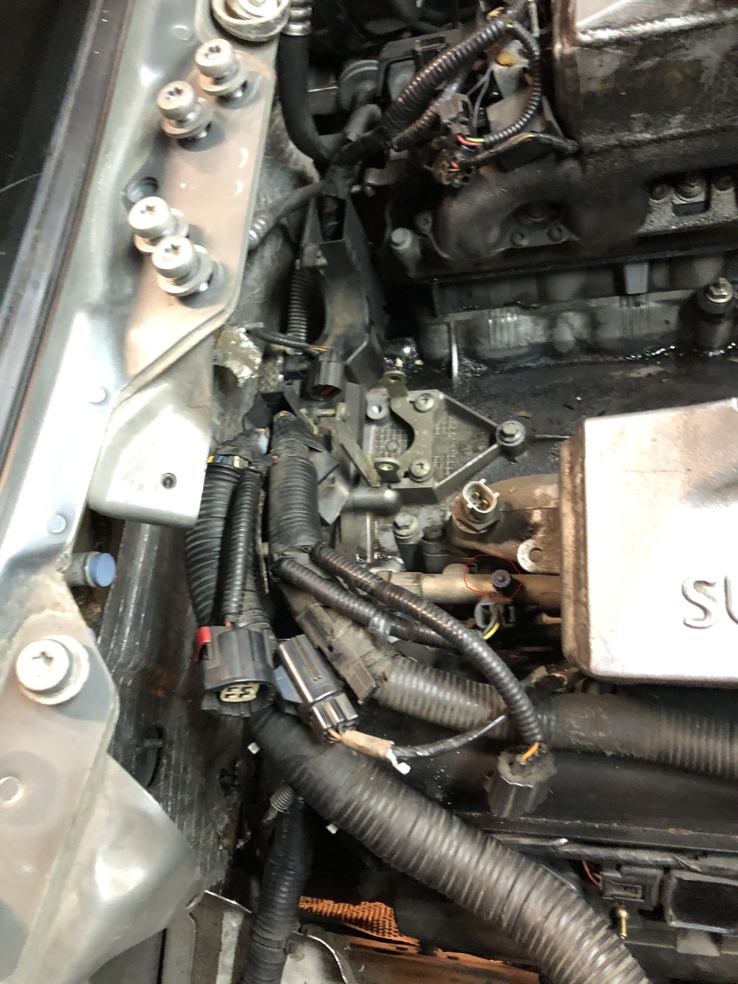

The fuel rail should have a valve (I think it is called a "Schrader valve") on the fuel rail where you can connect a pressure gauge, at east my SV8 has one and it is located on the right hand side of the engine towards the back of the fuel rail.
You can see it in the following picture, I have circled it in red. On my car the valve has a blue cap.
I assume that also the n/a engines have this valve.
