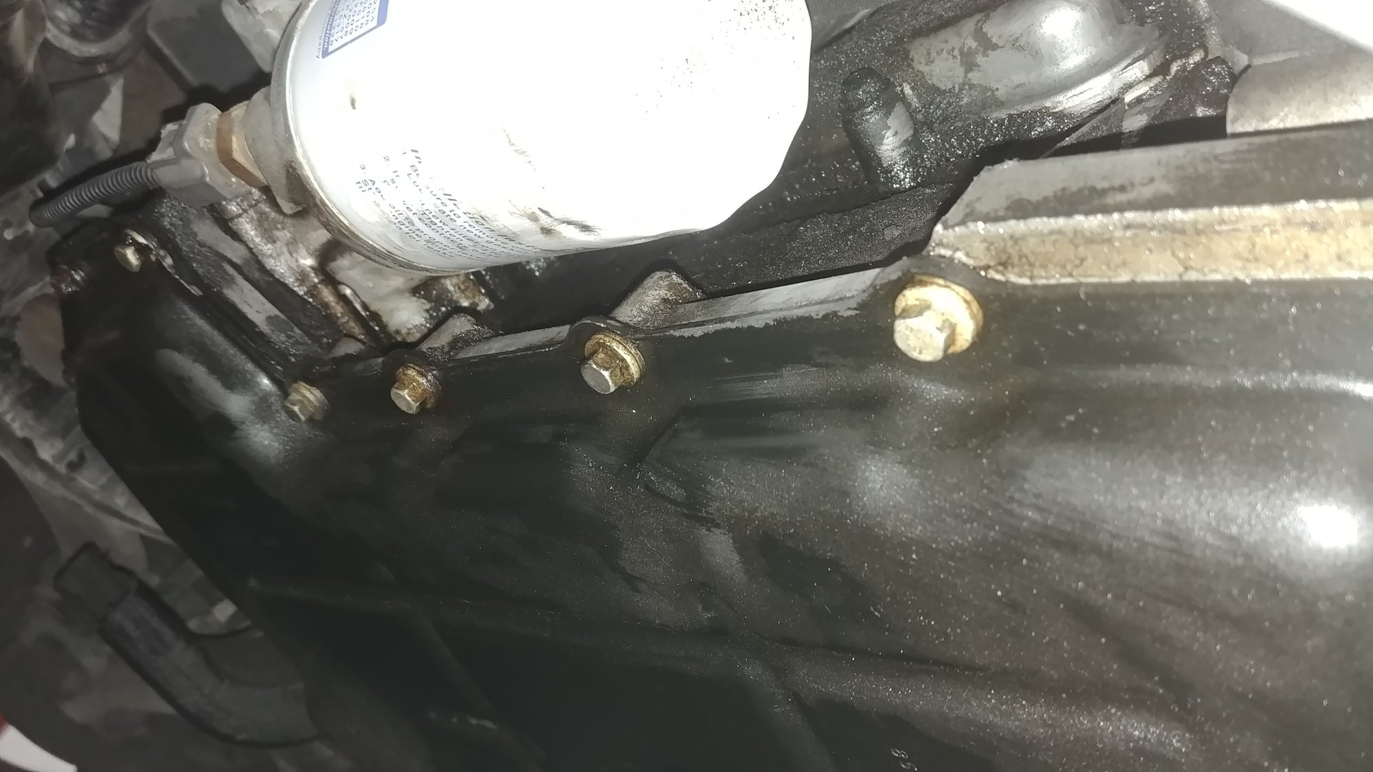

1. I noticed pretty bad oil leaks that would trails driving from the driveway to garage from my research about this car, the oil pan gasket is notorious for leaking, however when I look underneath, is that the upper Oil pan Gasket leaking as well??
How hard is it to fix? is there any direction on this forum?

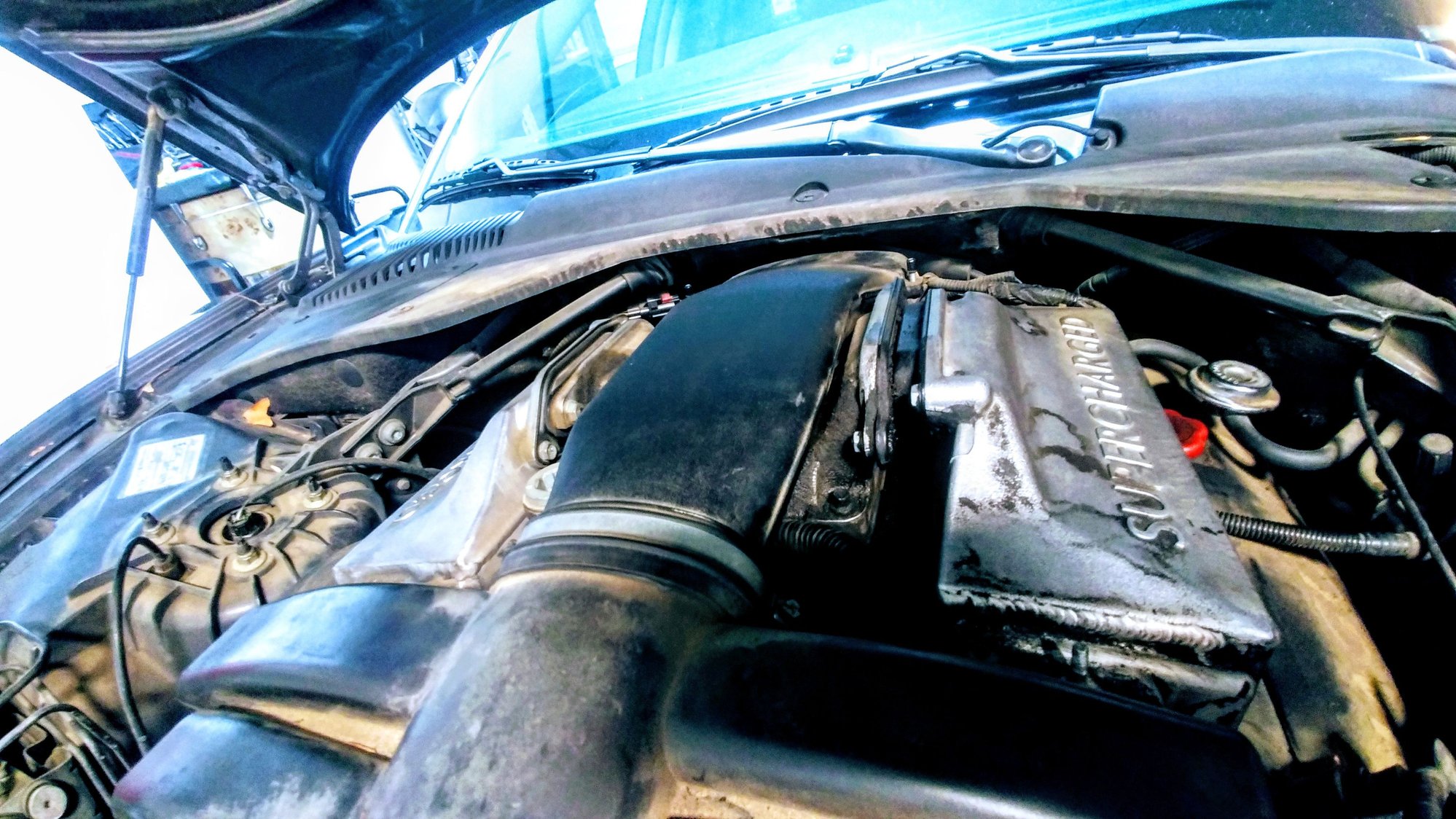

2. The last picture shows Supercharger shows a lot of grimes from what appears to be gaskets...looks simple to change (4 bolts) can you guys confirm this? also any direction on part number would be much appreciated

Notice the upper part of the oil pan, looks wet
Look at the gaskets on the SC

I am replying to your post but I don't have any answers except:
The oil above the filter could well be from the supercharger leak at the top of the engine.
I suggest that you may want to have the engine steam cleaned (not water) and then
you will be able to see more clearly what you are dealing with.
The people who do car detailing may be able to advise you on this to avoid any electrical problems.
-It does seem like you have oil leaking from above the oil pan for sure. Where its coming from, could be several places. If you are mechanically inclined, it wont be anything terrible. Once these cars get up in miles, a lot of the rubber gaskets become hard and brittle and will leak (any car, really). The cost for the gaskets wont run too much either if you source them on Ebay. If you have a leak coming from your valve covers, supercharger, vac hoses, you should see bank 1/bank2 too lean codes. If you don't have that, and your fuel trims are normal, then you might be ok. !!!The first thing I would start with is cleaning the engine up safely like meirion said. Once its clean you will be able to identify the origin of the leaks when they start to leak again!!!!
-These are simple to change:Manufacturer Part Number:
Will run about 90 bucks for the set.
AJ86892
Yes Thank you for the advice, I am moderately handy with cars...I have an XK8 that I worked on myself as well...I am just getting to know the XJR and I appreciate the advice....I will clean the underneath pronto hopefully I can find the source soon.
I'll be back to report any findings and updates
