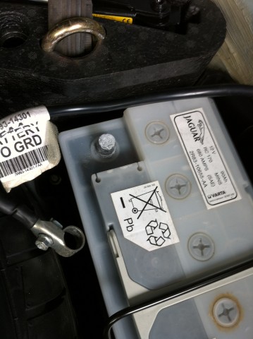

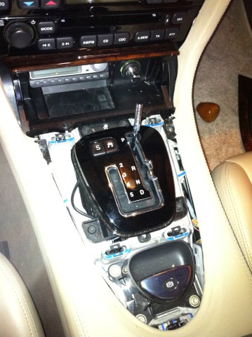

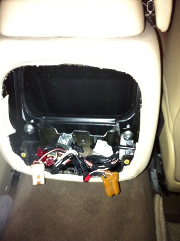

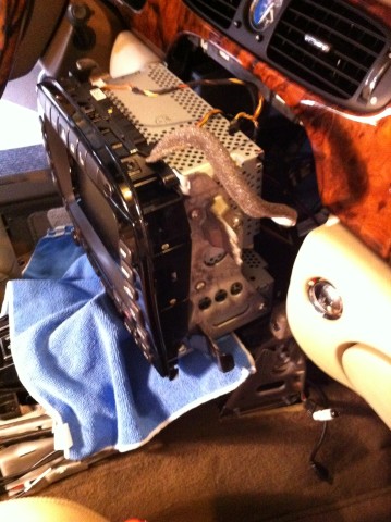

Mattrains and 45wheelgun -
Nice call on the replacing the switch unit. Bought one on ebay as suggested.
Put it in this afternoon in about 90 minutes.
(Had some additional fiddling to do as a result of the ACM cables in the console, but otherwise straightforward.)
I was glad to see both the original unit and the replacement unit both had a "B5" sticker. The car's sticker also had the notation 52/04 and the ebay unit was tagged 11/03. I am guessing this indicates manufacture date week/year of the component.
Thanks-
mag
