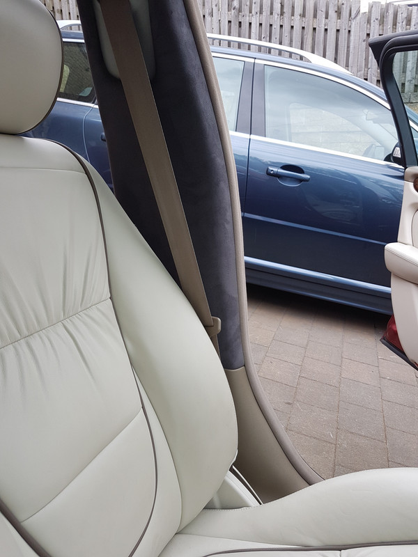

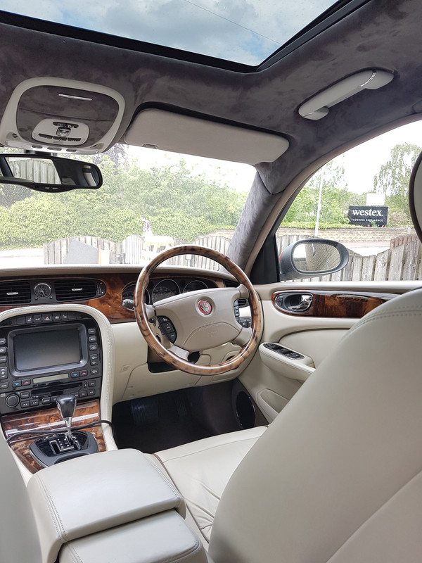

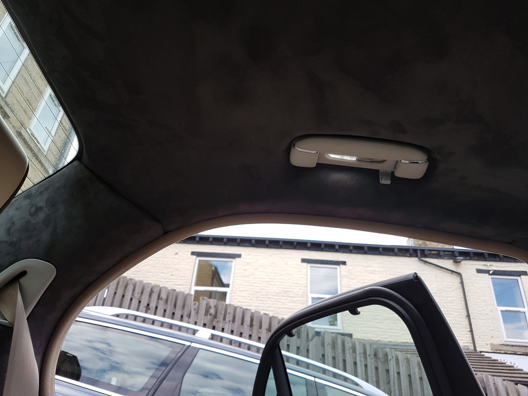

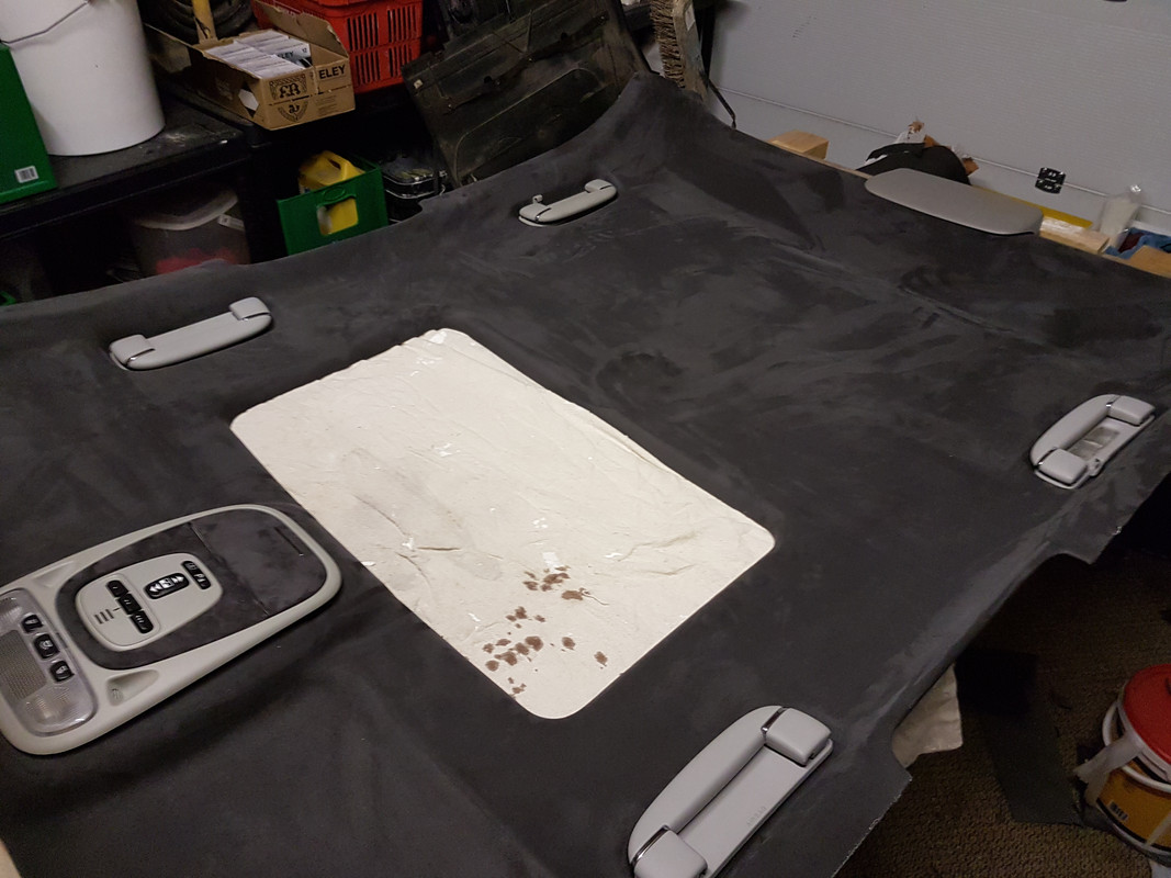

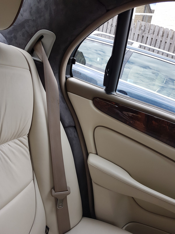

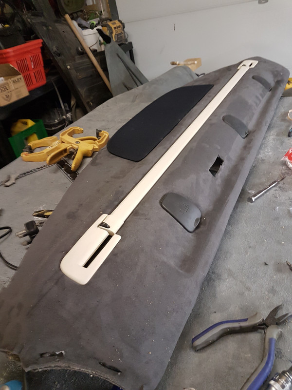

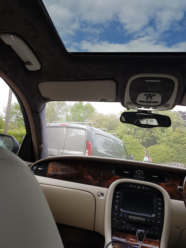

Redid mine in dark grey, A,B,C pillars and rear shelf to match

The head liner will come out of a SWB car thru the rear door with some care and a helper,it flies out of a LWB but you do need at least 1 of the front seats out, the cloth needs to be super stretchy and no joints are needed,all the roof furniture is removed and refitted.

MCFastybloke - Thanks for the pictures. Looks great. I was wondering about the front, middle, back pillars. Were they easy to pop off. Any tips or insights on removing them since the seatbelts run through them. Thanks again

The A and C pillars need to come off any way, the B, just undo the seat belt at the seat and unthread it, the height mechanism needs to be removed for recovering but its easy enough. Mt top tip when disassembling trim,look on ebay for same part for sale and study the photos of the latches and tabs.
