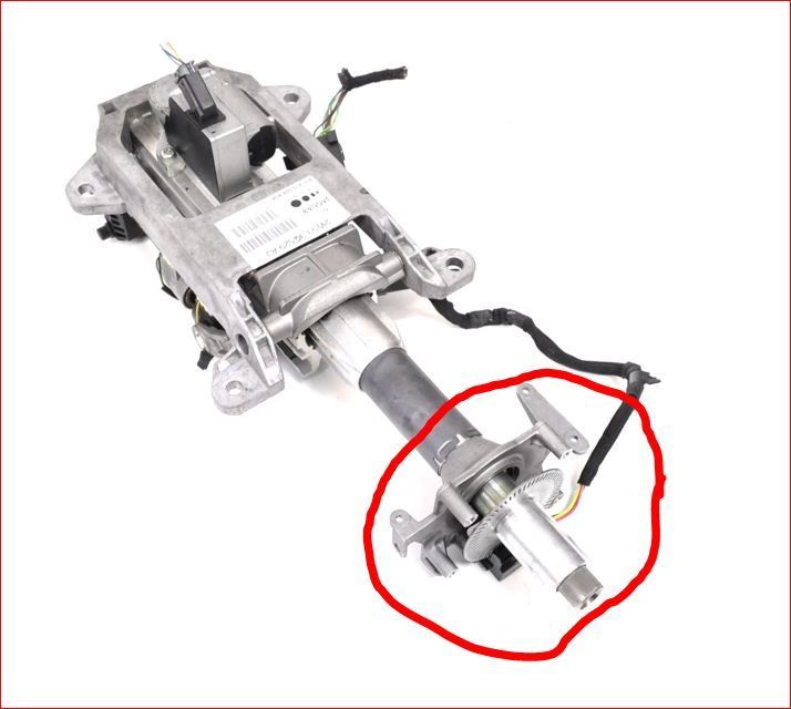

It has been 20 years since I worked with steering torque sensors...
It MAY be your root cause: There is a such thing as steering torque sensor seems it is highlighted in attached pic
optical steering sensor
This is a digital sensor, sends out pulse train. I am not sure about technology integration here. The sensor's output, or lack of it, can definitely interfere with amount of assist provided.
Big K.
