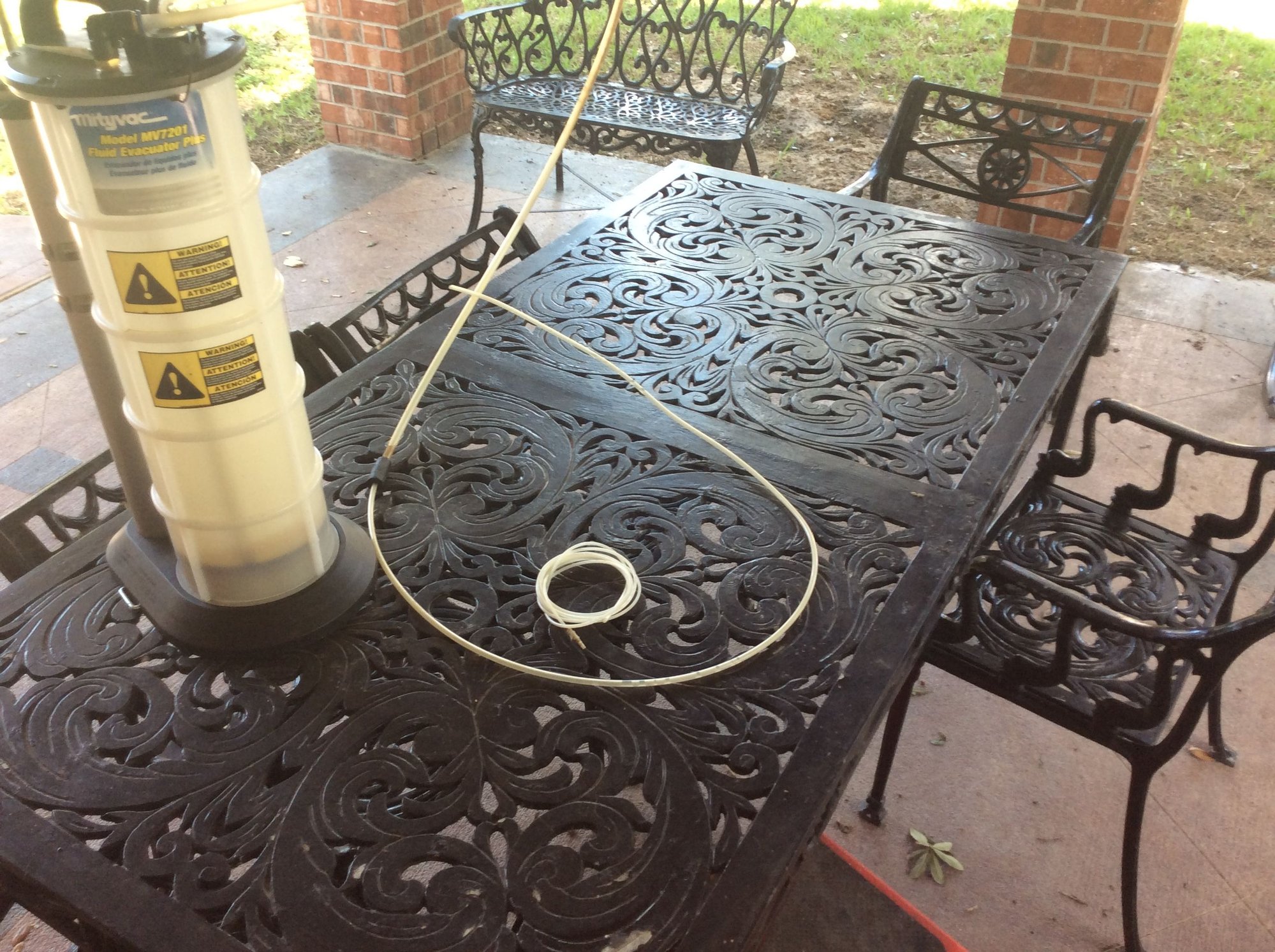

Hi Mark
I am really sorry to hear about your issues. Being that it is a Super v8, I think it is worth saving. One of the first things I would do, even if it is unrelated, is to clear out all of your sunroof drains. The fronts are super easy. All it would require is locating the holes in the front inside of the sunroof track and run a small stiff wire, or better yet, a weed-wacker line with the end melted into a small ball. An obstruction here is the likely culprit for your pooling of water. I prefer to remove the a-pillar panels, front sun visors and grab handles on each side of the vehicle to gain direct access to the hoses that go from the sun roof frame down to the drain, but I understand that kind of job might not be in your comfort zone. The rears can be a slightly bigger job, but it is doable nonetheless. There are several threads here that can give you some guidance. I think it would be a good idea to resolve this issue, while you also resolve your transmission/ABS problems, especially if the vehicle is parked outside and may sit for extended periods. Best of luck!

I had the same issue where after a transmission service the 3rd gear was stuck! That was because not enough fluid was in the transmission (my fault entirely) - I did not follow instructions to the tee. Once I followed the proper instructions in filling the tranny with the correct amount of ZF fluid, the problem was gone. That was like 7 years ago. Never had an issue since. Don't give up. If you do not wrench yourself unfortunately you are at the mercy of others who may know even less about the car than you do.
