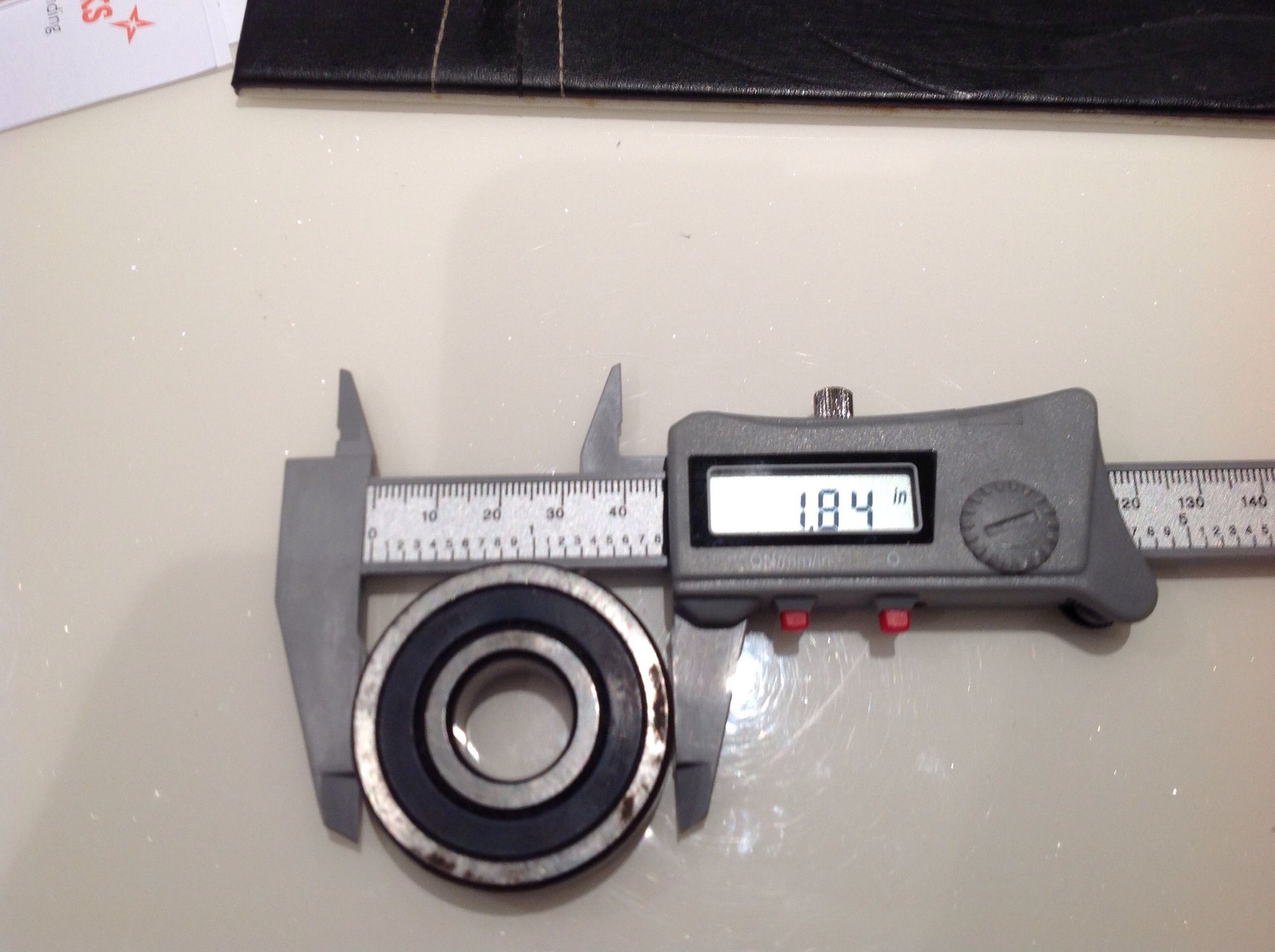

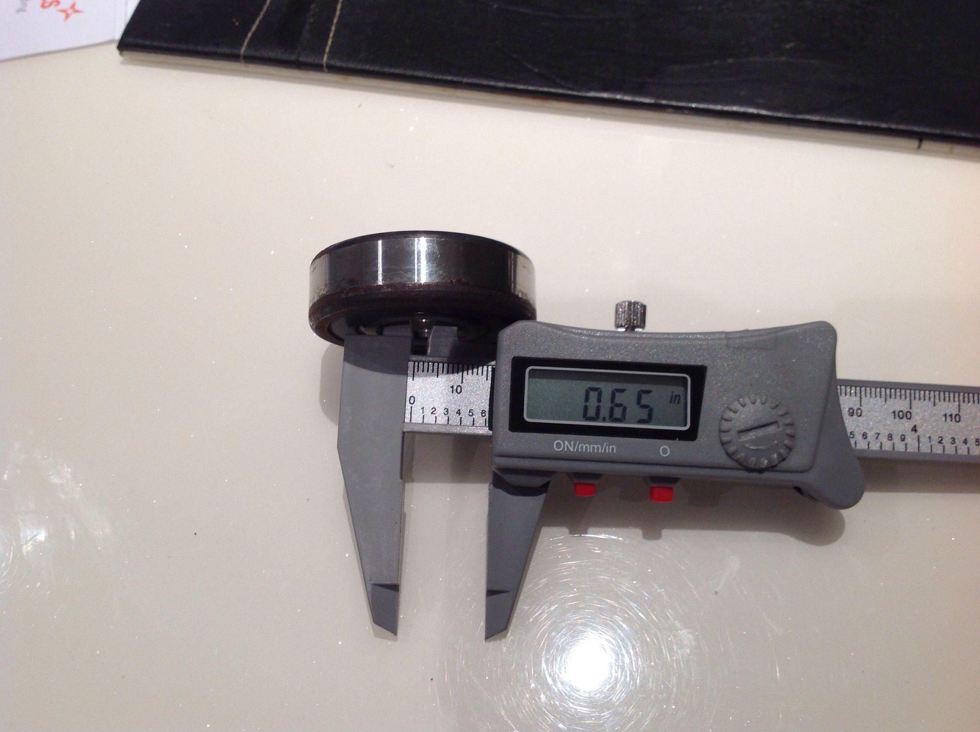

The idler has a bearing that can be replaced just go to a bearing supplier I did this cost me £5 just be careful when replacing it as the bearing does not go all the way in just measure the air gap between the pulley the bearing .The bearing number is hsr s 158 also the best belt is a gator belt put one on mine stopped the squeaky belt

clifton94, I can't find a bearing with that code, the shop I went to told me thay have no record of it. Tried several places. Also tried google, nothing. I tried to school myself on the subject, but the standard denominations are quite different, e.g. 6010 instead of what you said. Could you please help me with that?

This is the idler bearing
Old Jul 10, 2015 | 05:42 PM

Hope this helps my car is a 2006 model but it should be the same as yours

The new type belt supplied by jag has grooves on both sides but you have to fit the new kit before using the new type belt.The bearing I have photographed fits the idler number 2
