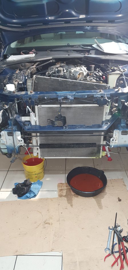

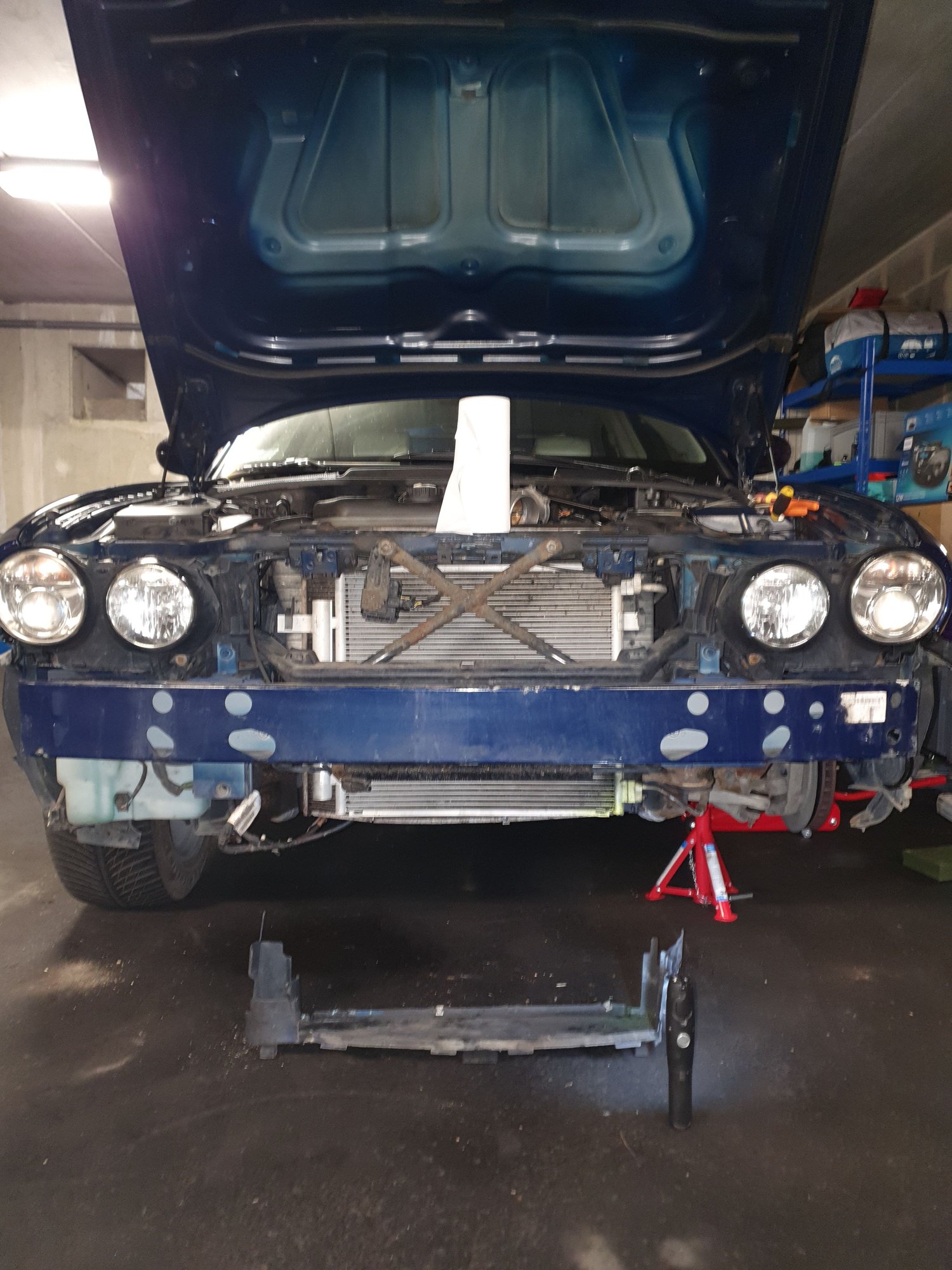

Old Mar 6, 2024 | 07:28 AM
Petz's Avatar
Joined: Jan 2021
Posts: 618
Likes: 144
From: KEHLEN , LUXEMBOURG
Well looks like it is my turn now.
good thing I have a spare car next to the one I'm usually driving with.
in November I had to put a new radiator in the my 4.2 xj8 4.2
As well as all the rubberhoses and the auxilliary pump.
the old radiator was swollen on the bottom
The linse from the climate condenser had to be fixed with M8 instead of M6 screws. some one wrecked the before me.
to bad I cleaned up the transcoolerlines as well as the servo cooler lines before reinstalling. Well lesson learned I ll never do that same mistake again.
i' ll giv it a go and report back soon
