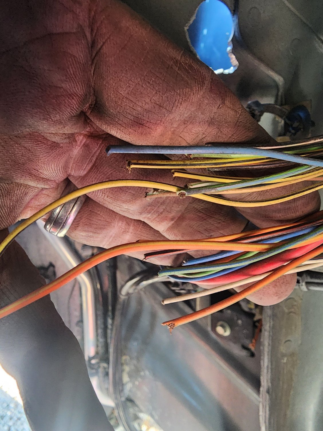

My 2004 XJ8 was attacked by packrats that ate/sheared off the wiring harness that comes from the firewall into the engine compartment underneath the brake vacuum booster. I've tried reconnecting wires by color, but have 6 wires left over.
It is an area where 3 wiring clusters come together, and I wonder if there was a loom, connector, or multiple wire splices there.
Since they ate everything, I have nothing to go on. Does anyone have a picture of the wiring harnesses coming together there?

I managed to re-connect about 15-18 wires by color code, but have 4 wires that come into the area under the brake booster from the rear of the engine that don't seem to have 'anywhere to go' - no wire to pair up with. I don't think there was ever a loom here, but if there were splices, then that would explain why I have 4 leftovers.
Can I ask anyone with a 04 xj8 to take a pic of the wires under the brake booster? (You would need to pull out the large grey foam piece that is probably there).

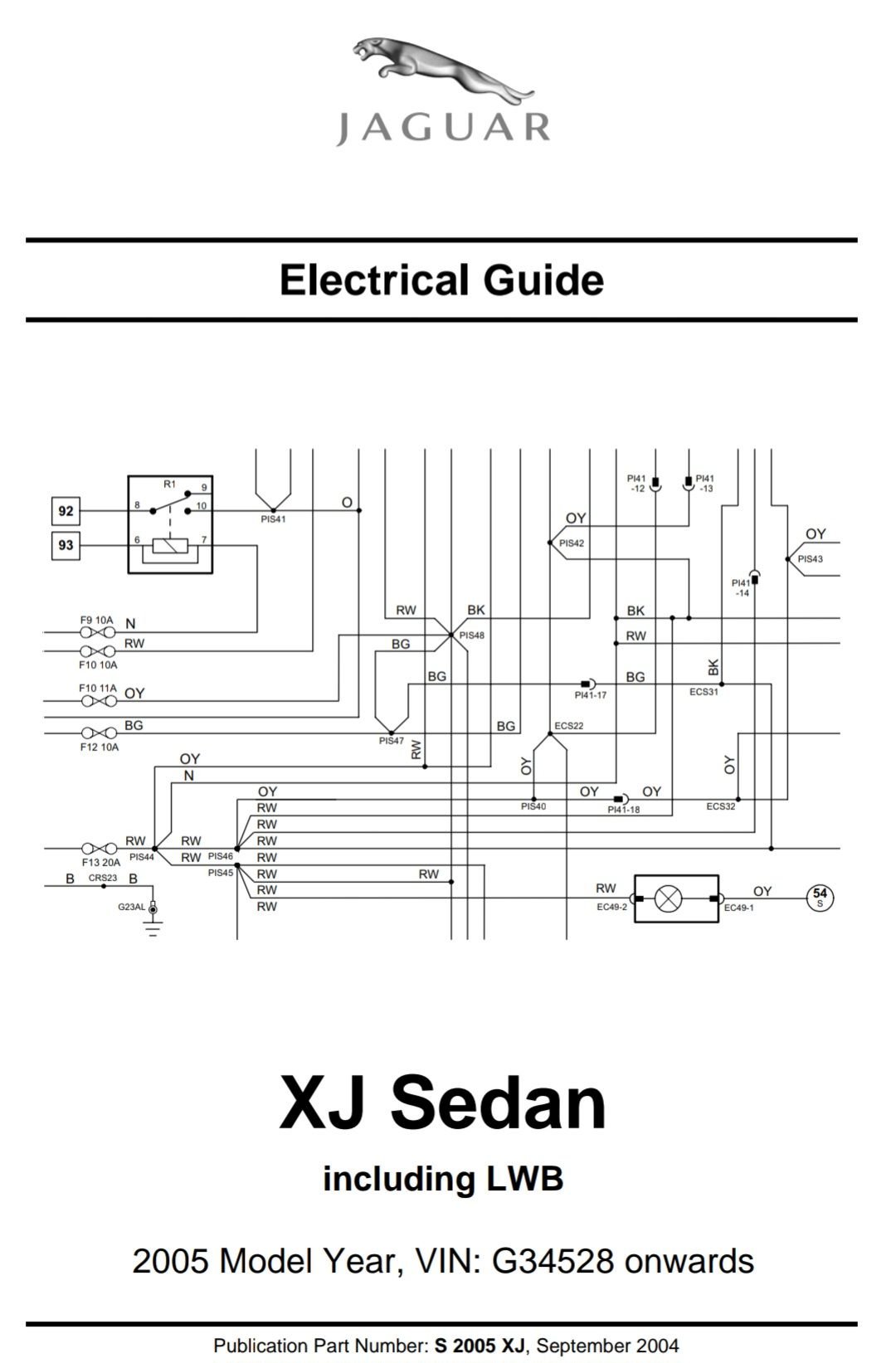

Can you take a pic of the area around the wiring loom that is cut? Like a pic that you would want to see from me so you can compare back to back? I'm working on that area, with my engine out as well, on my early 2005 xj super v8. My car falls under the 2004 MY electrical guide VIN range.

I think you got it now, but to be clear, I've got my harnesses super exposed for great pictures. I'm offering to recreate a picture you take of the section you need with my good harness pic. Or I can throw a bunch of pictures of the brake booster area harness at you haha. I've got no plastic in the way now.
Edit: you're online writing at the same time as me lol. What i sent was the cover for the 2005 model year electrical guide to show the VIN range of that year is after mine. My car should match yours despite being called a 2005, the only exception is that mine is supercharged.

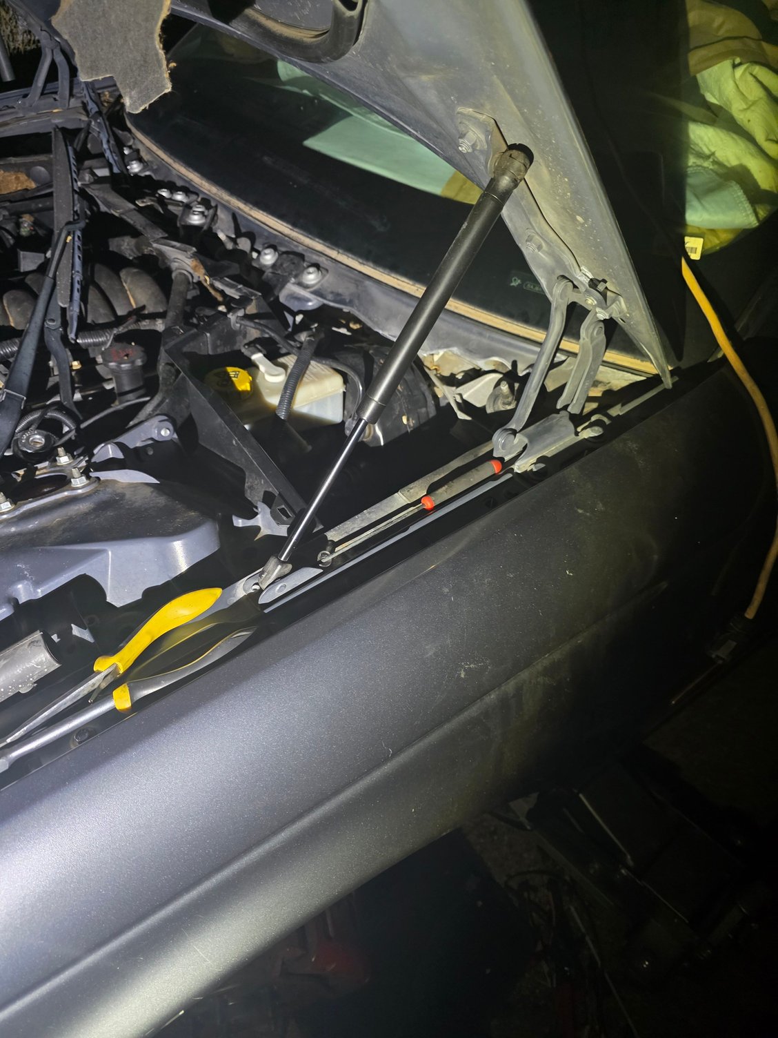

I circled in yellow the 3-way intersection that was eaten by rats.
First, for perspective, I circled in yellow the 3-way intersection that was eaten by rats.

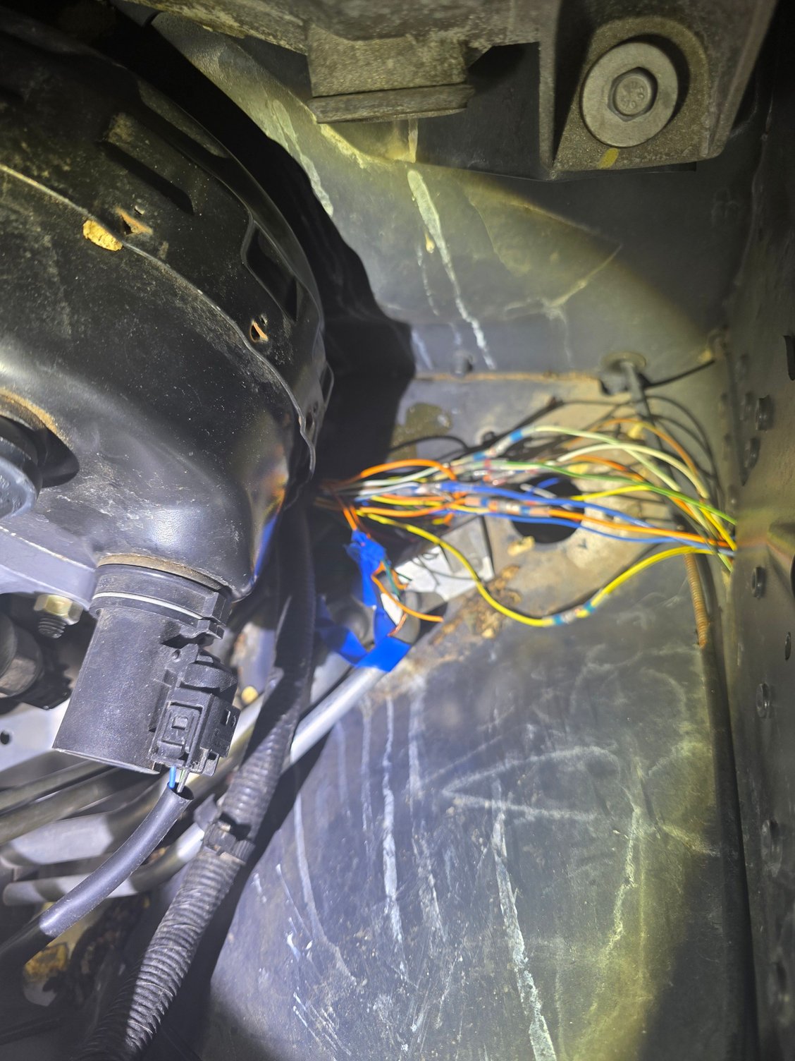

I took some pics at night, with a flashlight. I hope they are visible. Since the wires were eaten, and then I had to re-route the wires, I don't even know how it would look under 'regular' circumstance.
Have to say I can't tell you how much I appreciate your offer to help. Even that diagram may save me.

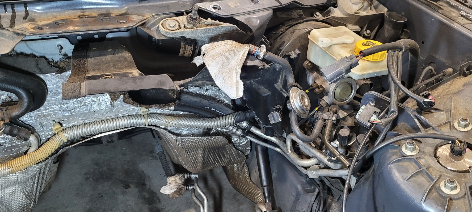

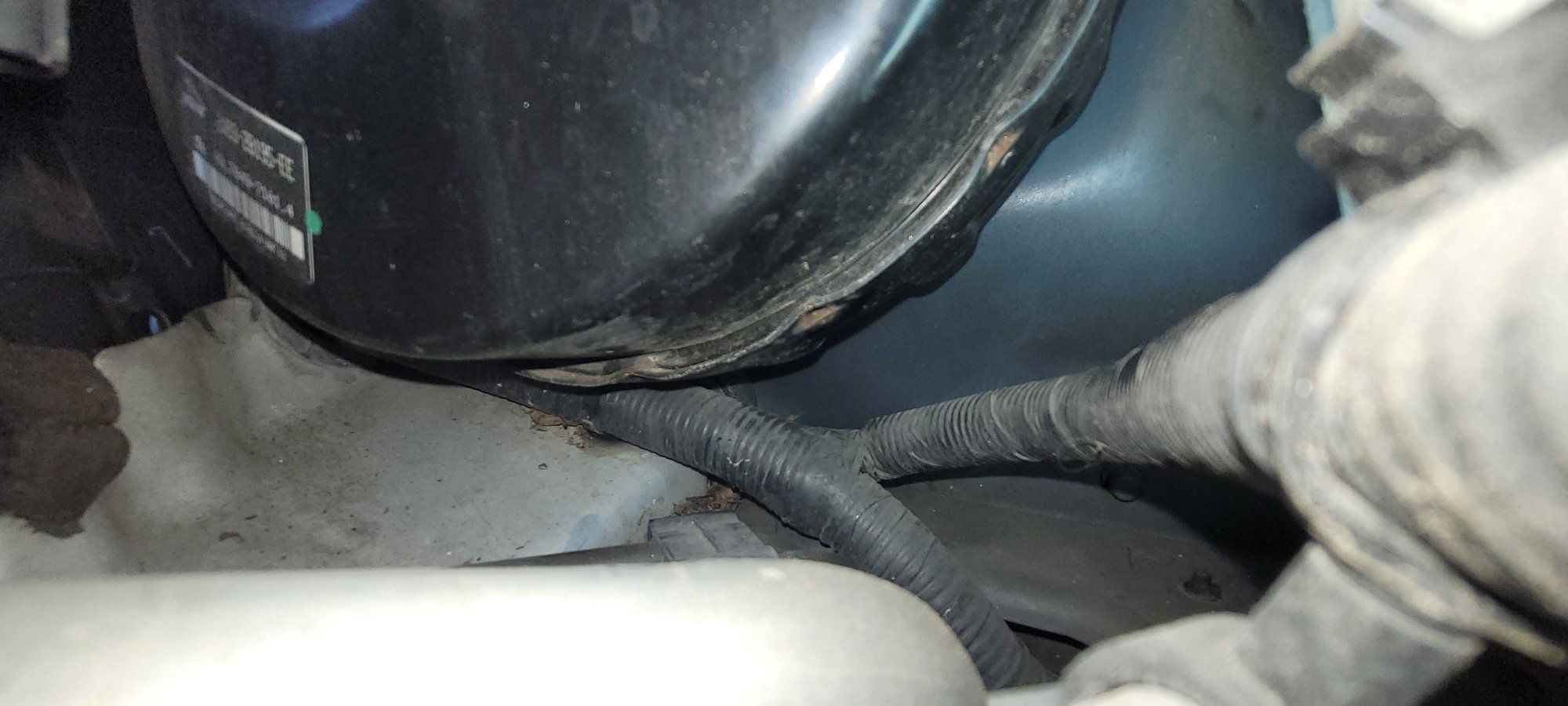

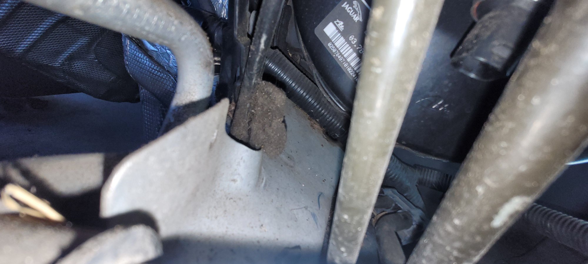

I took a lot of pics, but here are two - one from far away, and one that shows the area under the brake drum where I am hoping the harness may be visible. If I am wrong, then the only other way to see is from inside the wheel well, which would be a LOT of work to expose, and I wouldn't ask that of anyone.
A far away shot to show the area under the grey foam. Sorry about a night shot taken with a flashlight. Just to help orient you.
A semi-close up of area under the booster. in the daylight, a closeup of the wires under the booster, even closer in than this, might help. Again, my wires were re-routed and in a normal car would be a tight bundle.
This second shot is the best I could do at night - a semi-close up of area under the booster. If I put my camera any closer to where I actually need a pic, I don't think you could tell where the pic was taken. To the left of the bright blue electrical tape, which in this shot goes into shadow, is the area I am interested in. In the daylight, a closeup of the wires under the booster, with the camera even closer in than in this shot, would be a great help. Again, my wires were re-routed and in a normal car would be a tight bundle and would have come up from the bottom of the compartment.

PS I used the bright blue electrical tape to hold the 4 'extra' wires without a mate together. They come from the rear of the engine, and I suspect they splice into matching color wires right where the blue tape is. I guess I am hoping you have 3-4 black rubber tubes covering up 3-4 splices in this area. That will tell me where to start splicing.

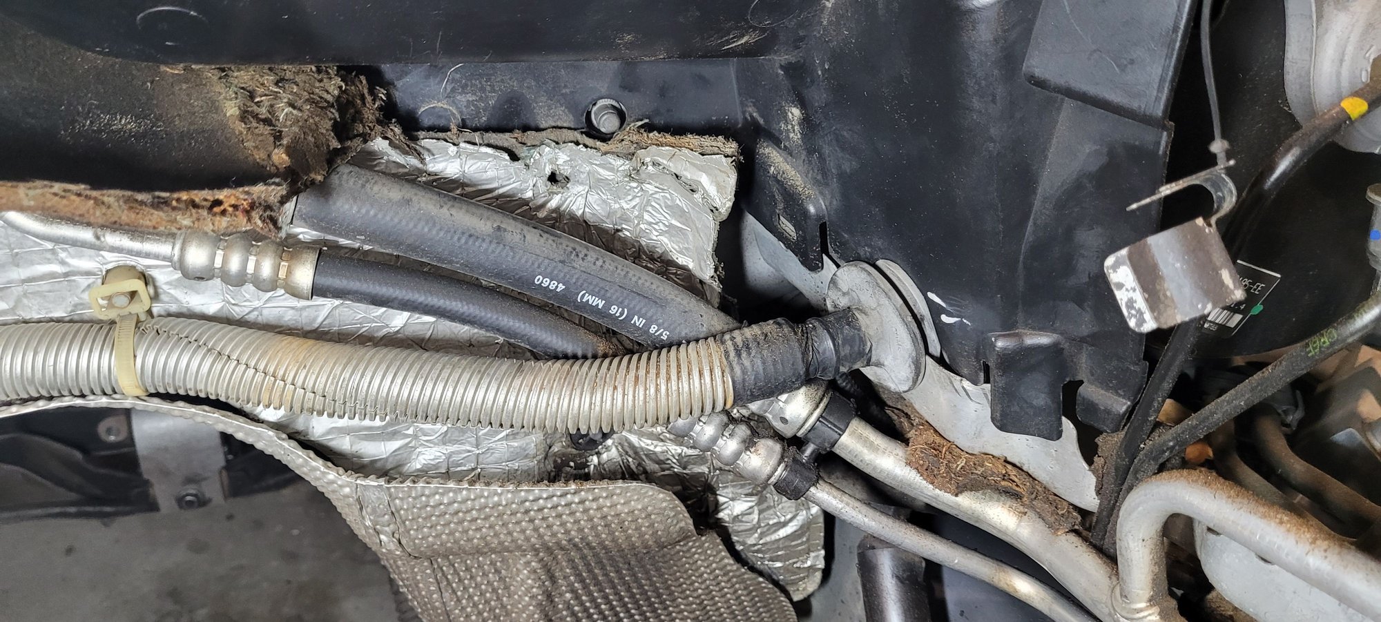

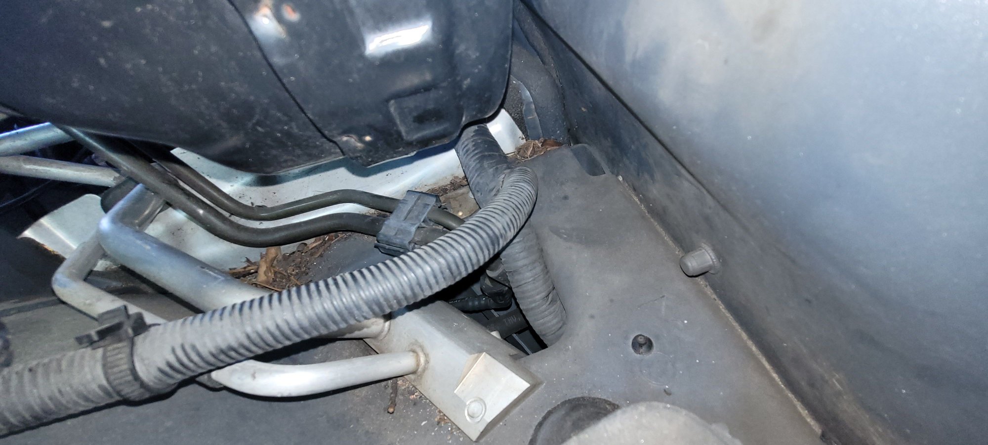

Here's what I have, it's all nice wire looms I'm afraid, with not many splices to speak of. I zoomed in like you did. I'll try to get the wiring diagram I think this shows up on if you want.
I went left to right looking at the booster. If you want different angles at any of these points, let me know.

Actually, that is vey helpful. Knowing that there is NOT another intersection of cable runs lets me know that my extra wires do all have to join up at the intersection.
