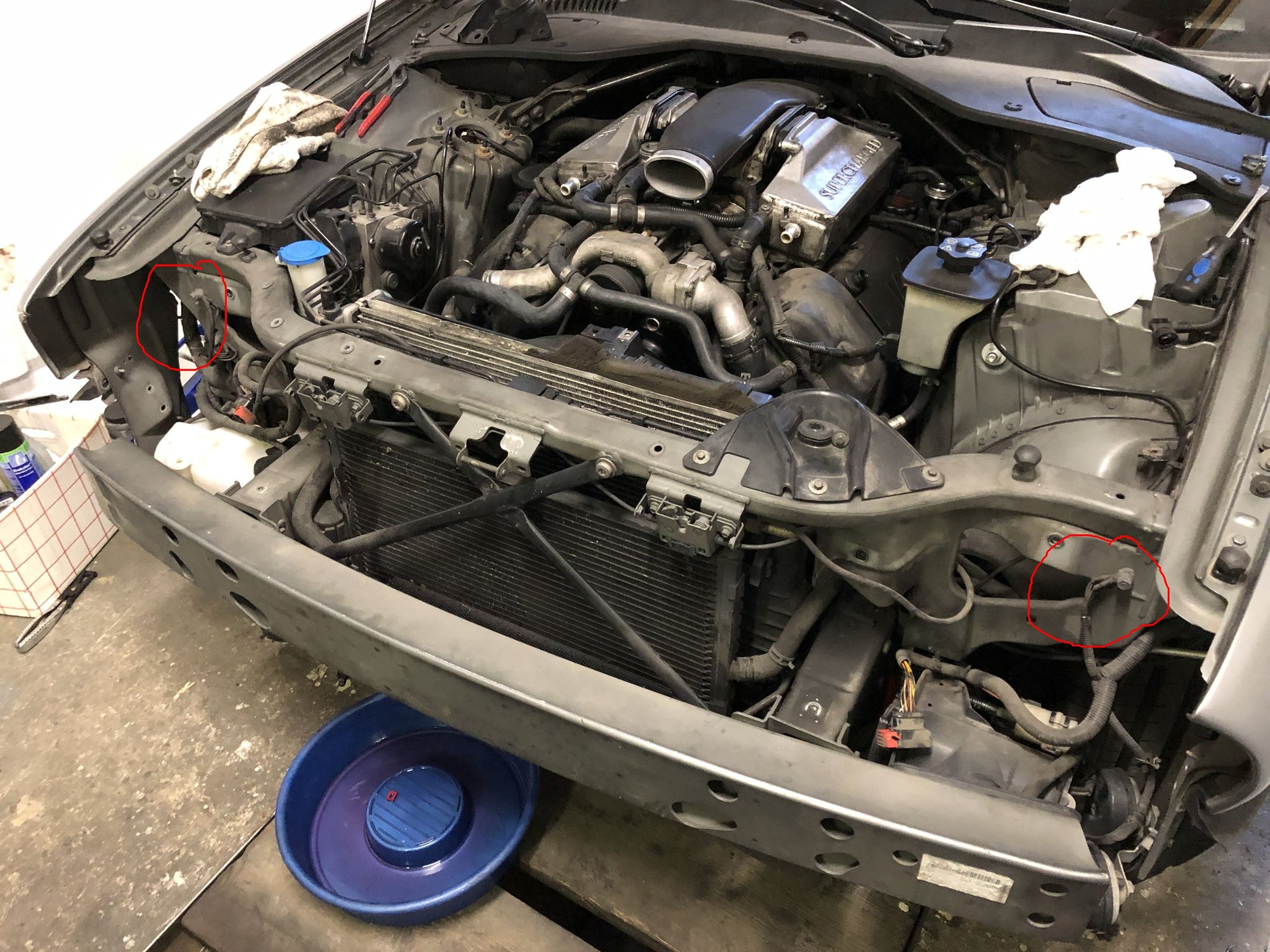

Originally Posted by PeteK812
Thanks Thomas and Paul. Photo really helps. Last night the light worked as usual. Must be a failing connection somewhere, I hope to be able to find it just to prove the fault. I was thinking by 08 the self leveling lights were gone, so ballasts are the same? Could this problem occur with a bad ground? The famous ground studs are in there somewhere, right?
No, the gorund studs are behind the headlights. I circled them in Red in the following picture:
Here's anothe picture with the headlight in place:
Best regards,
Thomas

The ground studs could be another reason for flickering. Those are the 3 mass connection below the engine bay upper front cover . You will reach 2 of the just like that, the 3th on is hidden a bit lower all behind headlight box . Undue carefully tend to break of. If so drill hoses and put in aluminum bolts from behind the frame , do not drill too deep into fuse box . I did it just by removing bumper and headlights.

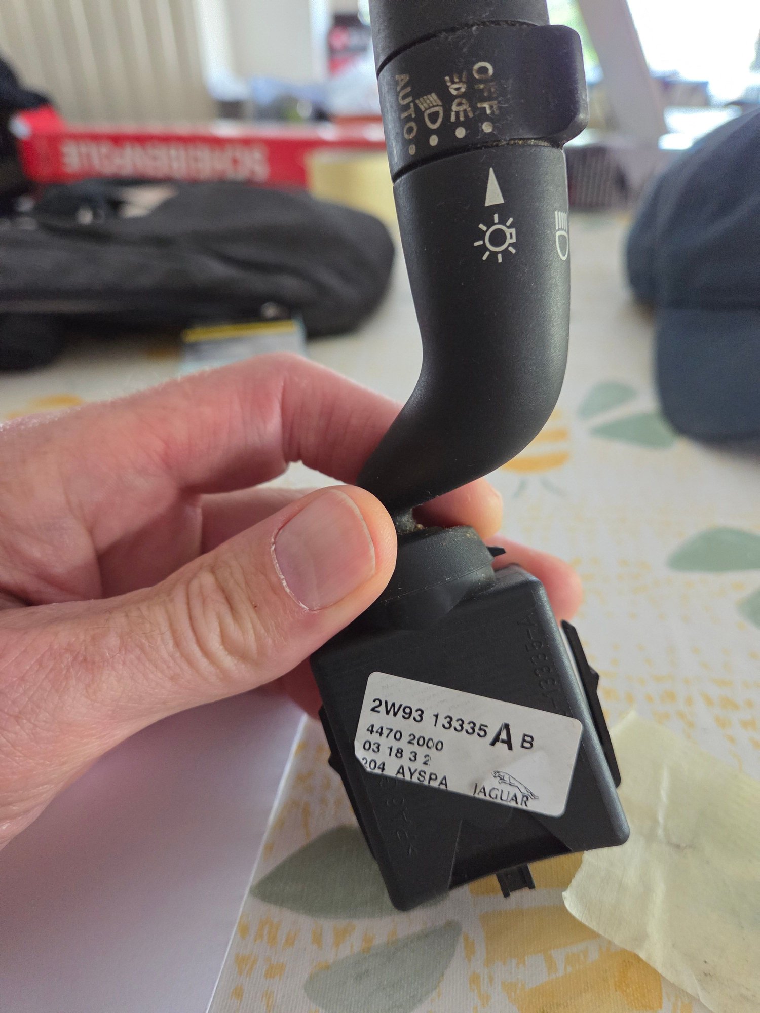

another reason is sometimes the stalk at the steering wheel that has got to be exchanged
