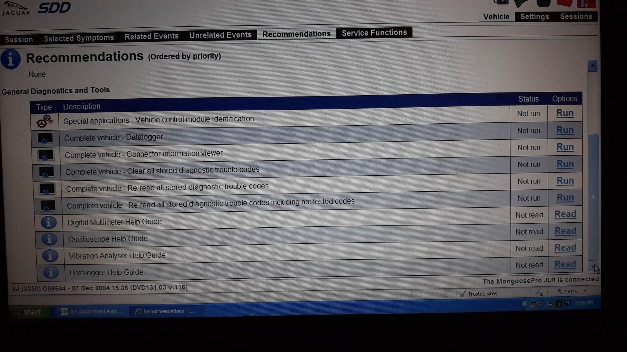

I have asked this question a couple times on this forum, and not only could I not believe that "a major motor manufacturer doesn't have a procedure within its diagnostic software for assisting the bleeding of the ABS block". I couldn't believe that the "Jag Techs" on this forum didn't know either. Well after doing some research, I figured it out. Jaguar did have it in their software, just not in plain sight.
I tried the following on SDD v125 and v131. It should work the same on the other versions as well. This is from v125
Start the SDD/IDS program
1. Select Diagnosis
2. Selected Symptoms
3. Chassis
4. Braking System
5. General Braking System Symptoms
6. Brake Pedal Feels Spongy
7. Continue
8. Recommendations
9. Complete Vehicle Data-Logger
10. Run
11. Brake System
12. ABS Output control-Hydraulic Pump Motor
Haven't ran it yet, but looks promising. gonna bleed brakes tomorrow.

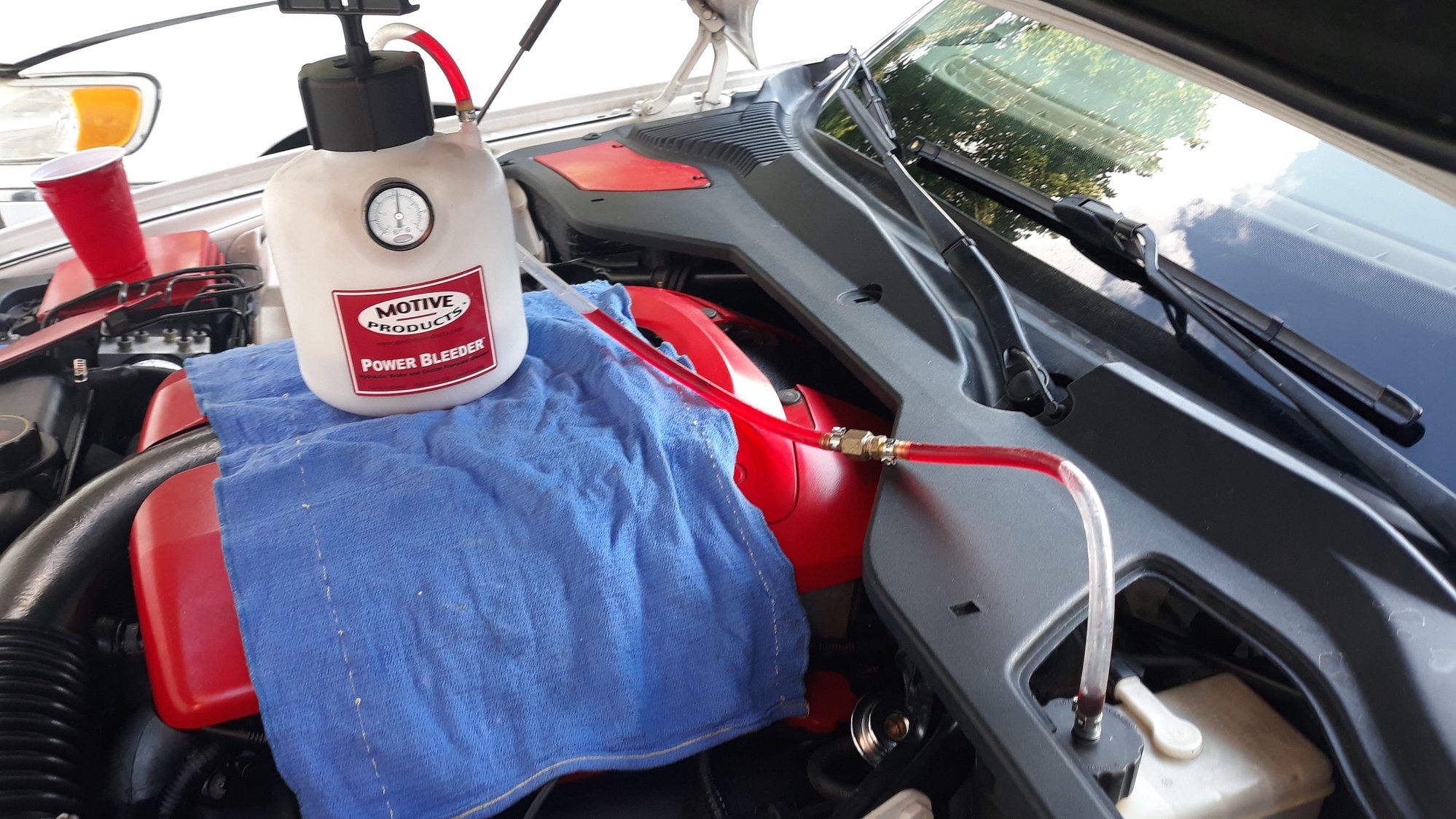

Bleed my brakes today using a Power Bleeder. Didn't bother the ABS, there is no air in it. Put some Hydraulic dye in the fluid. This dye is made for this kind of thing. It looks green when in the bottle, but it dyes the fluid red. Didn't take but three drops to dye 3liters.

Seems all Europeans use the same brake master cylinder lid.
I purchased a European pressure bleeder, it had just one lid included.
Screwed right onto the Jags master cylinder, pumped a little air no leak.

so what is the process for bleeding brakes with the pressured master cylinder? How much pressure? Do you still pump the brake pedal and hold as you open the bleeder? Or does the pressure in the mc allow you to just open the bleeders?
Old Aug 4, 2020 | 04:50 AM
Wingrider's Avatar
Joined: Sep 2016
Posts: 3,475
Likes: 874
From: Stow Ohio
As i understand it, you put in brake fluid, connect, pump to pressurize tank, 10-15 psi, then the master cylinder, then open the bleeder till fluid is clean.

Further to this topic and 'joeleerj' s response regarding the SDD options. Having replaced several rigid brake lines I suspect that I have air in the ABS module (brake pedal is firm after bleeding at calipers but pedal almost reaches the floor with engine running). I have the SDD program (V130) and, following joeleerj's advice, reached the Data Logger section relating to the ABS Module (as per photos). However, correct me if I'm wrong but it appears that it only shows the spec for the unit NOT a path to bleed same - am I missing something ?? If it's not possible to bleed the ABS module via SDD I'll have to purchase one of the scan tools that incorporate ABS bleeding (Foxwell NT630 for example). I don't really want to go down that route as I already have an iCarsoft unit. Thanks everyone - any advice welcome.
