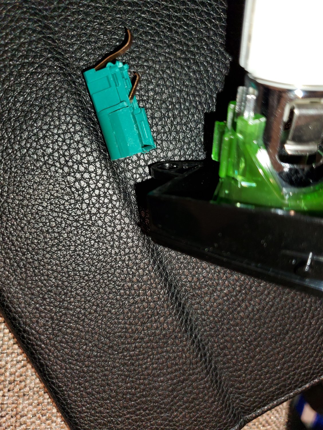

Once it is off, you can see the tabs on which it is secured.

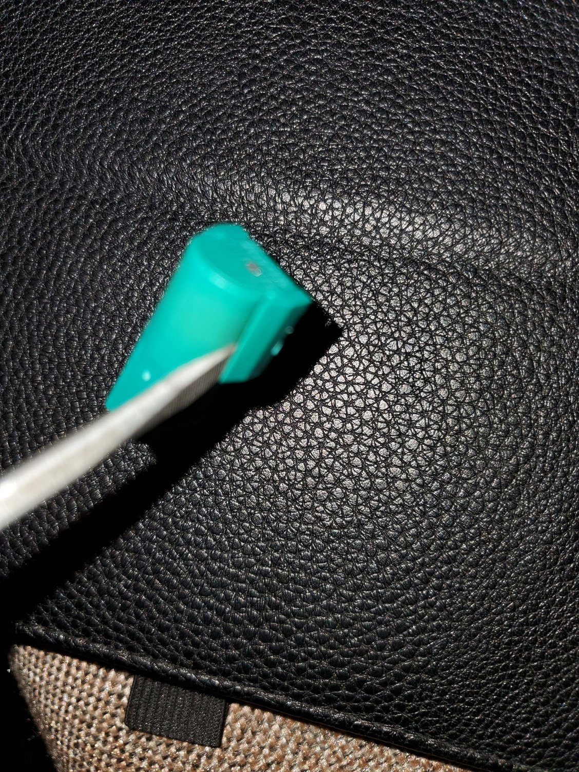

Looking at the bulb holder, it doesn't look like it come apart, but it does. Insert the screwdriver (or prying tool of choice) between the housing as shown, on both sides, and gently pry to release the tabs.
When done, you will be able to see the hooks that need to be moved in the middle. Be careful here, I ended up breaking one, but there are enough clips that it was still functional.
Last, release the hooks on either side in the middle, and pry upward to open the holder.
Once it is open, you will be able to see the bulb, and pull it gently out with needle nose pliers.
