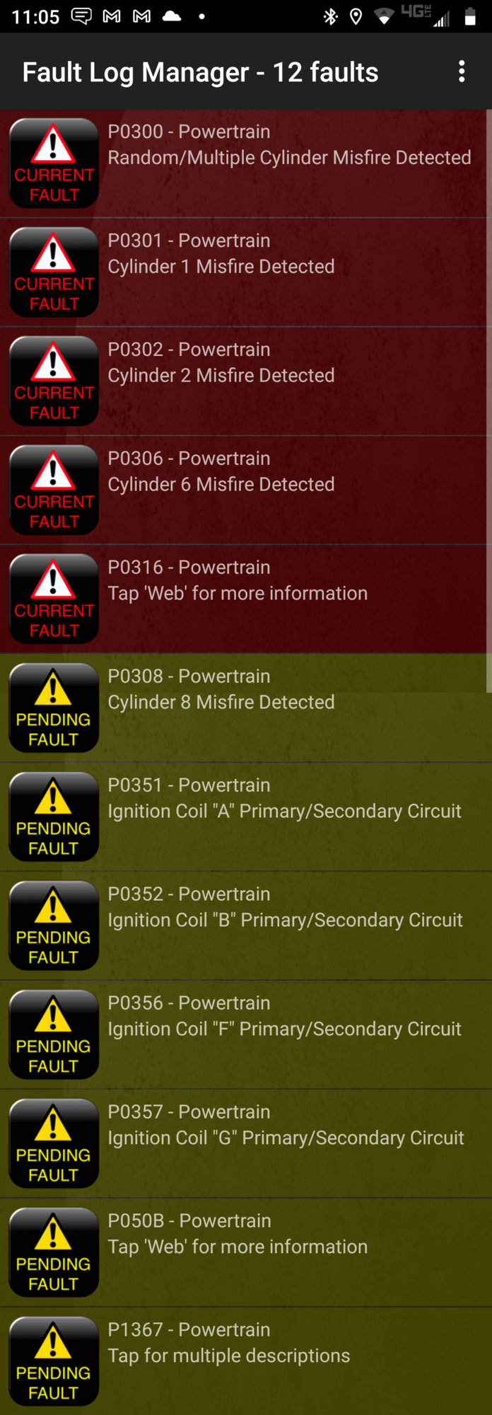

Error codes included P0300-P0308, P0316, P0350-P0358, P1367, P050B, and others. I replaced all 8 spark plugs and coils, then cleared the engine codes. The misfires came back after a short test drive, and I found newly installed coil #1 melting itself. This may have just been excessive dielectic grease.

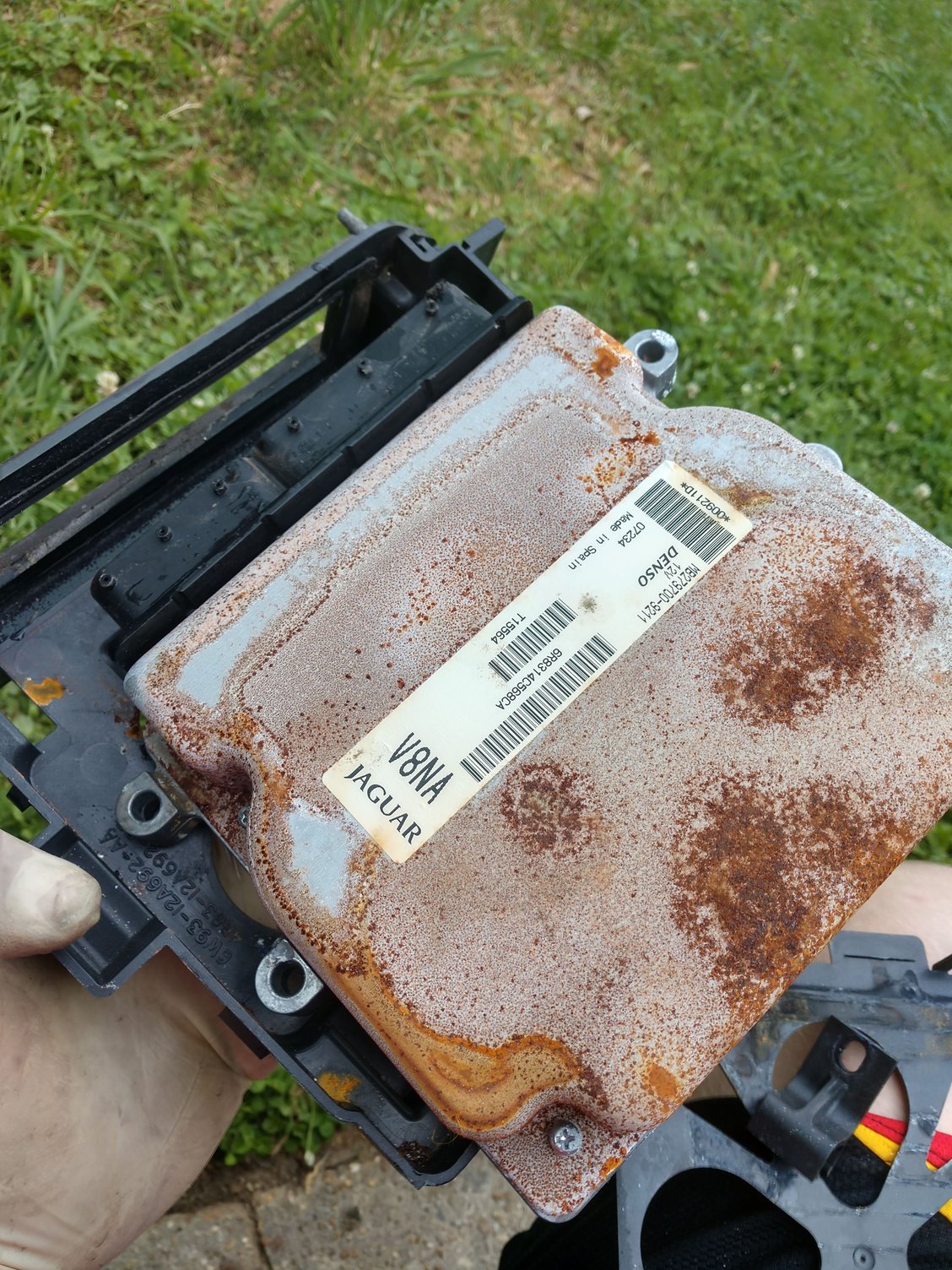

Today I took out the ECU and observed water present behind the firewall seal and lots of rust on the ECU body.

Error codes AFTER replacing all coils & plugs. I cleared the old codes and it still misfired in the driveway. Misfires grew worse after a short test drive.

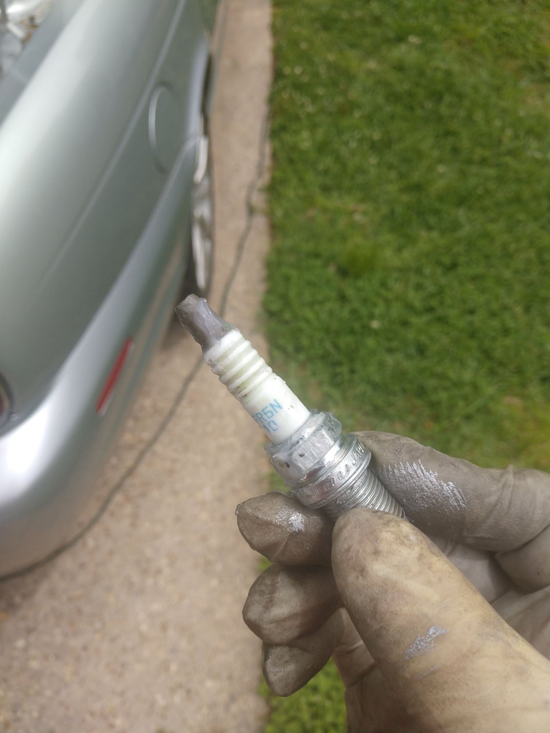

Cylinder #1 ignition coil. Newly installed, but melting itself after a short test drive. Removed excessive dielectic grease from spark plug & replaced with functioning older coil.
Too much dielectic grease on Cyl #1 spark plug. I also filled the ignition coil boot. Would this much resistance cause the melting shown in photo #2?
ECU removed from car, after disconnecting negative battery terminal. Lots of body rust, and some water was still present on the plastic housing. Would the misfires be attributable to a faulty ECU? And, what are some good programmers who could duplicate my current ECU so I can plug-n-play?

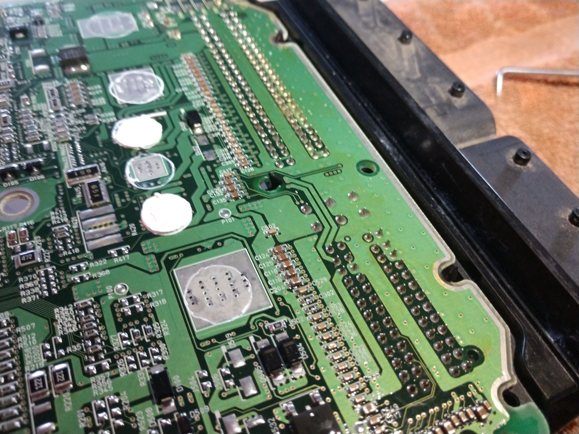

Replying back... I found lots of moisture on my ECU pins but no apparent damage on the board itself. I'm blowing some air over it in an attempt to dry it out. May plug it back in & test
The pins had lots of moisture & some appeared to be shorted by water droplets, but I did not observe damage to the board. It's coated in a shiny, plastic coating which must help with moisture.
The top surface of the ECU showed some discoloration of the silicon near the front edge (behind the connector/firewall)
Discoloration along the top surface, at the front edge. I'm not certain this indicates water damage, but I interpret it to show past water intrusion
