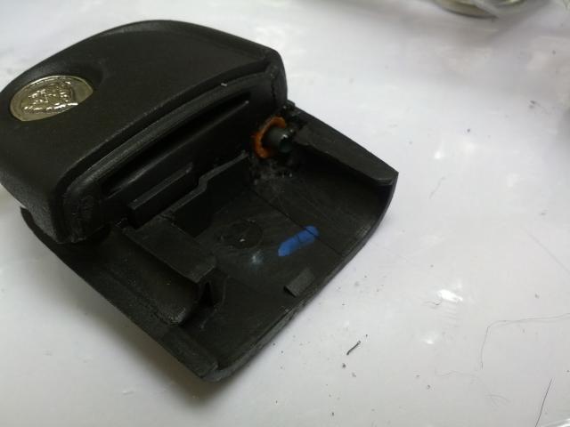

The transponder is sealed in a pocket in the plastic key holder, you can see the end of it here.
Old Oct 31, 2014 | 07:05 PM
hafren's Avatar
Joined: Sep 2014
Posts: 721
Likes: 277
From: Dayton, Ohio USA
Looks like this
Attached Thumbnails Jaguar Key Fob 2001 to 2009 Facts All You Need to Know FAQ-transponder.jpg
