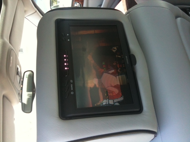

Default Life is hectic with twins but a blessing!
Sorry guys in the delay, hectic weekend with the family. Here are some of the photos for you, I am having difficulties in uploading multiples so bare with me. Here goes.

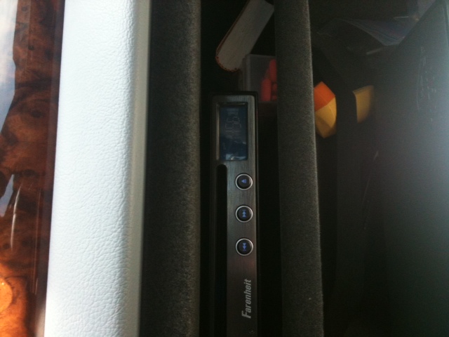

Default Shot of the center console
With control unit
Old Mar 29, 2011 | 08:19 PM
albert328gts's Avatar
Joined: Jan 2011
Posts: 98
Default DVD Player Unit
I can also upload movies from my iphon/ipod with RCA AV cable to the iphone/ipod.

Thanks for the pictures. Do those headrests still work with the XJ electric motors?
Old Mar 29, 2011 | 08:35 PM
Joined: Jan 2011
Posts: 98
Frustrated that I could not upload all photos in one post. Ultimately this exactly what I wanted and its OEM. I know their are probably better units out there but that's what I wanted. I bought my car last year at Silver Star Jaguar in Thousand Oaks California, with 29000 miles, it now has 33xxx, 3 year factory warranty so I plan on keeping it for a while. The Stype headrest are a direct replacement of to the xj series, although the xj seem to have slightly more padding up front.

Default Yes they do
Yes absolutely my motor raises and lowers the headrests.
