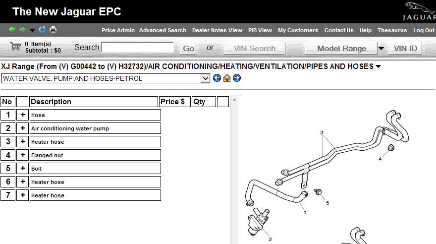

Here is where I backflushed my heater core.
Both of those hose ends are easily disconnected...once you get to them. Depending on the size of your hands and how much room you need, you may have to take off the expansion tank and remove some of the hoses from the aux coolant pump to get good access to them. I used one of the removed hoses to connect it to my garden hose and flushed both in and out of the core. It did help with heat on the driver side.

Dave, in the forums, there are links to download your two biggest 'manual' needs...(1) Jaguar Electronic Parts Catalogue (EPC) and (2) Jaguar technician Information System (JTIS)
both can be downloaded and installed on your computer, no CD or DVD required. They are invaluable if you do your own work and/or order parts yourself
