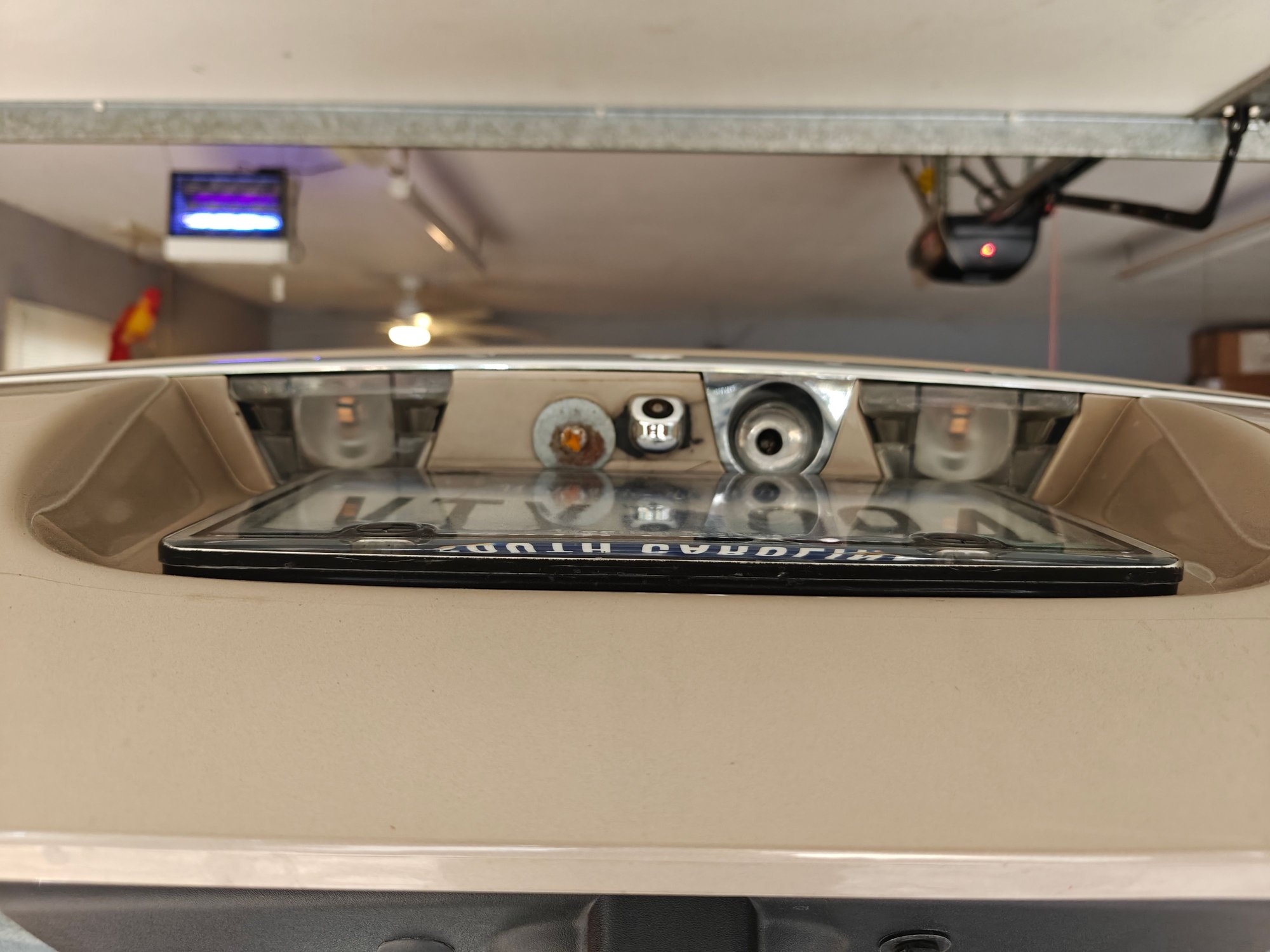

As Koshka sez; to remove the entire chrome assembly, you must go in from the inside (remove trunk lid liner) and then you will see two 10mm nuts the secure the entire assembly to the actual trunk lid. Be very careful, as the bottom section of the lid assembly is actually plastic (like bumper material) and can become brittle with age and cracks easily.
In the attached picture, you will see where a) I retrofitted LED lamps in the housing, b) the small clips that hold the lenses in place for LP lamps, (either side of both LEDs), and where I retrofitted a matching chrome Rear View Camera (to the left of the keyhole for trunk lock). Also note I added a small plate and fastener so that the camera is nice and secure (I did not trust plastic to take stress of torquing down on camera.

In theory, the license lamp assemblies can be removed without removing anything else. In the picture posted by ctsemicon, you can ee where the lamp assembly can be unclipped.but it seems that in his case the license plate itself is in the way and impedes the removal.

The center clips, left and right, can be pressed inward. Take your time and apply just enough pressure to get them to release. It is a pain, but it can be done. DO NOT attempt to remove the rear trunk panel. It us glued and snapped in place and WILL shatter. Don't ask me how I know.
