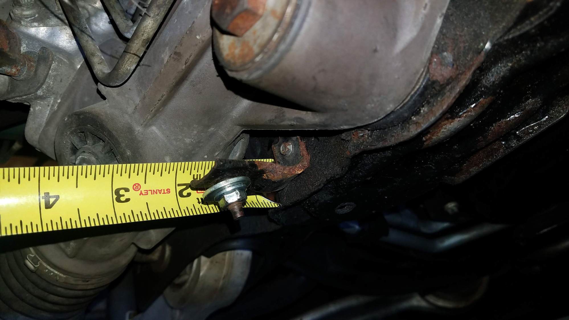

Does anyone know the P/N and or a source for the small angle brackets that hold the middle section of the large belly pan under our cars. (See Photo) One of mine is missing entirely and the other is barely hanging on. I could fabricate something but I'm lazy and would prefer to buy them if I can.
Thanks
Jeff

They are available new from vendors like SNG Barratt:
https://www.sngbarratt.com/us/#!/Eng...E%20UNDERTRAYS
Part number is XR816810.
Dave

Wow, that's exactly it! Thanks for your help. It's special order so who knows but at least I can see what it looked like once!

I replaced both of mine due to the threads being rusted away. There is a spring nut that goes into the sub-frame and I bought those as well as they also rust away. I bought mine from here parts

Thanks to you also! I had wondered how that little screw was gonna go in that big square hole. I called SNG Barratt and they were able to add those to the order.
