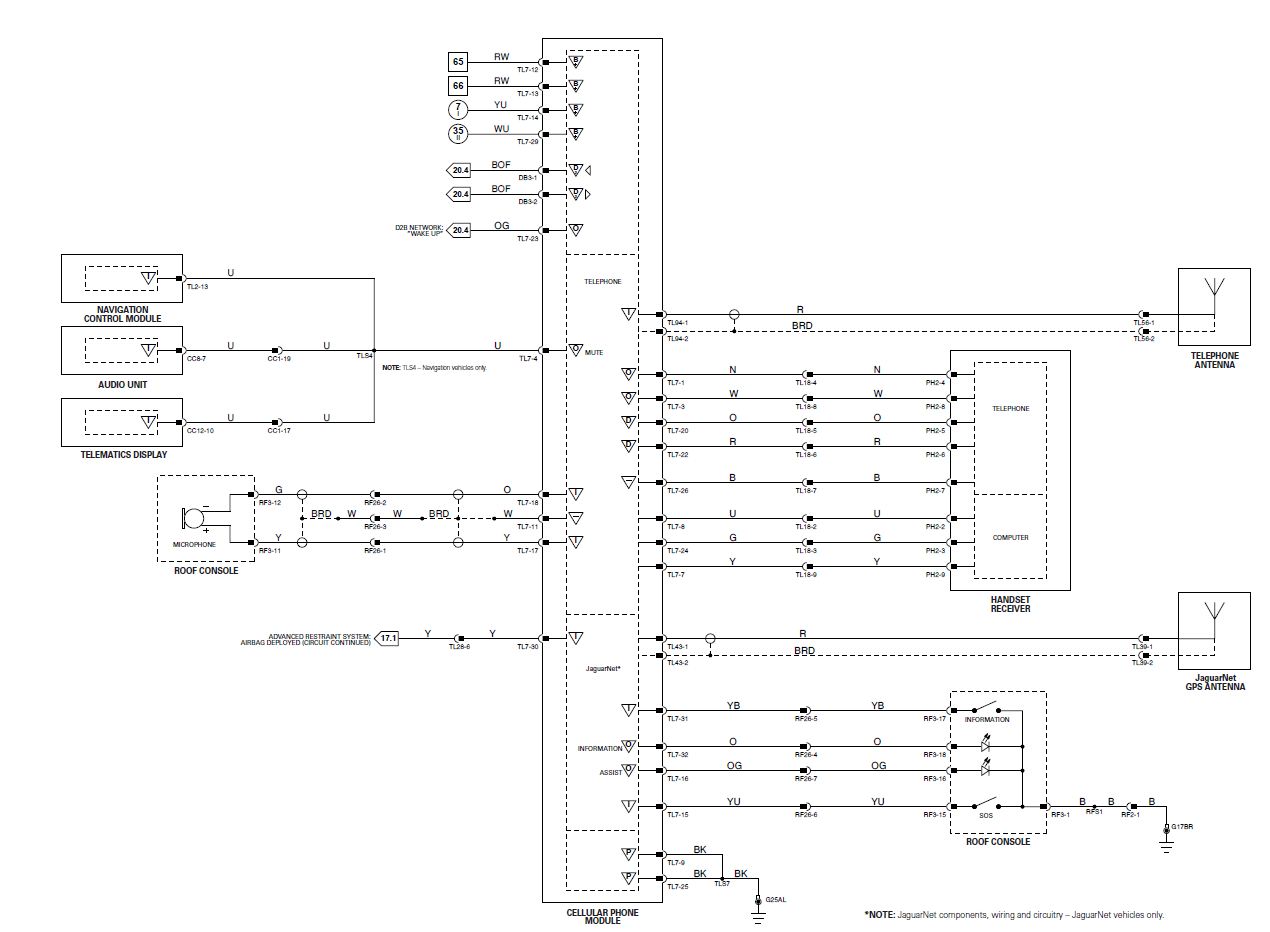

If your headliner has ever been replaced, perhaps the microphone wiring was damaged from the roof console back to the telephone module. I would check for continuity at the mic connector to tele module first. That will tell you ALOT.
