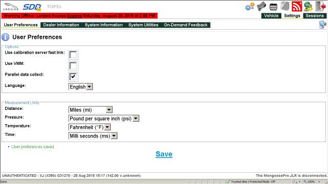

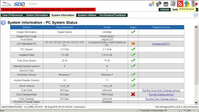

I check some system settings for the PC and get this. I see nothing wrong with this screen and my unit settings screen:
Attachment 118198
Attachment 118199

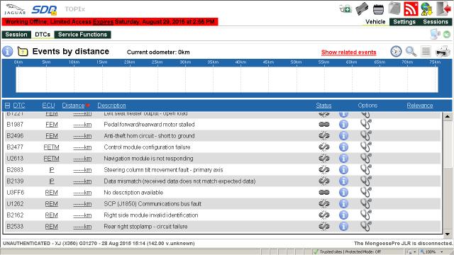

So finally I get to see some DTCs.
Attachment 118201
Attachment 118202
I notice that there are rather a lot of them :-( . One I see is for a suspension issue I just repaired so i decided I would run a DTC reset and managed to figure it out by selecting the next tab and there are two options to "RUN"
