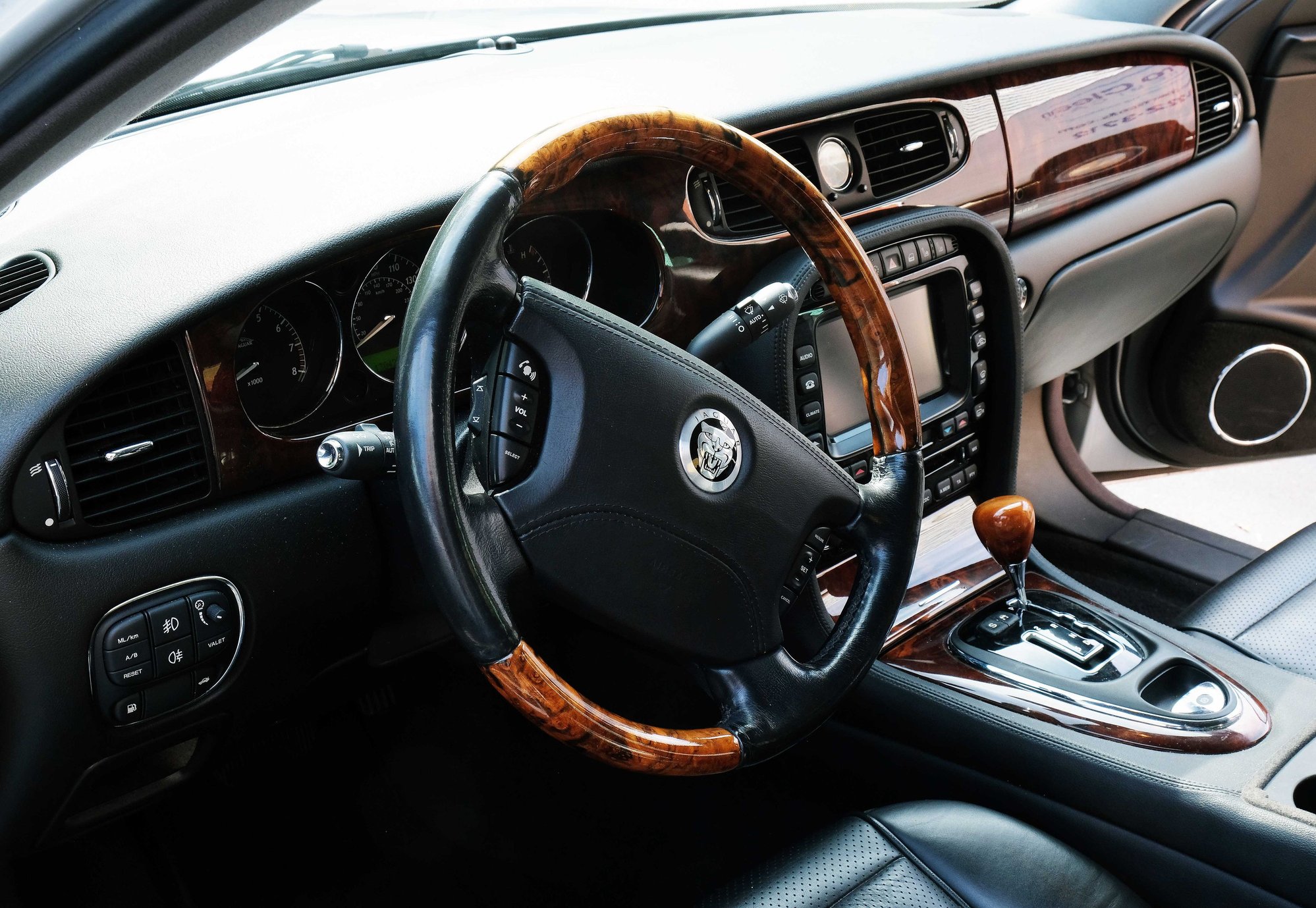

...but the X358 will be your pet Pet.
P.S. with a steering wheel and gear knob like that, who's gonna look up at the headlining?
Agree +1
