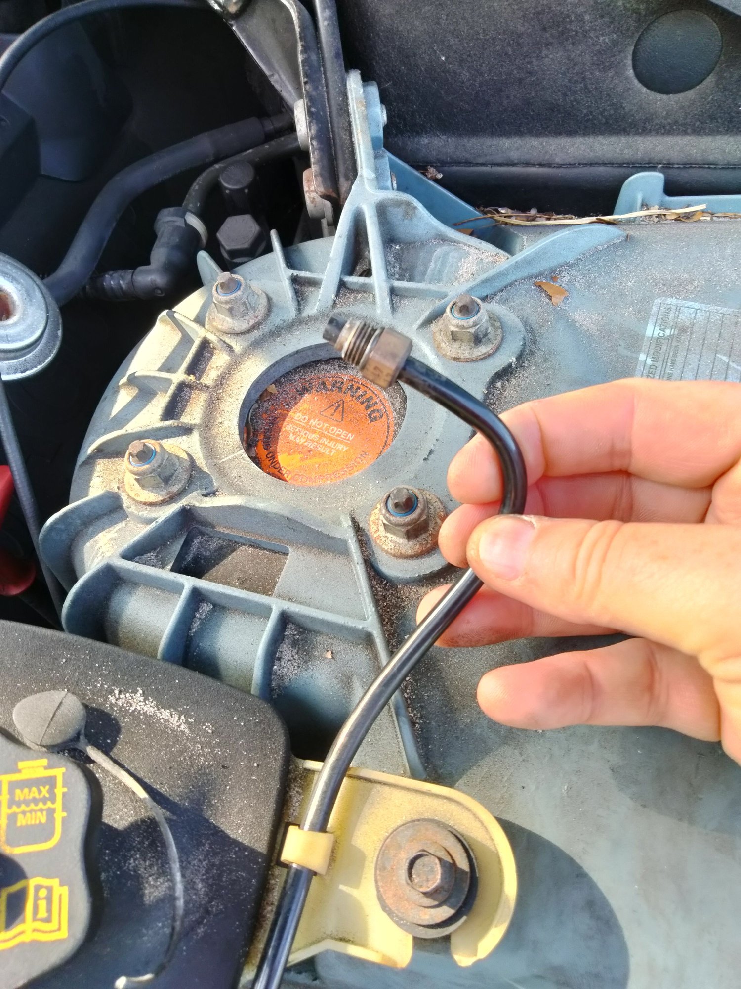

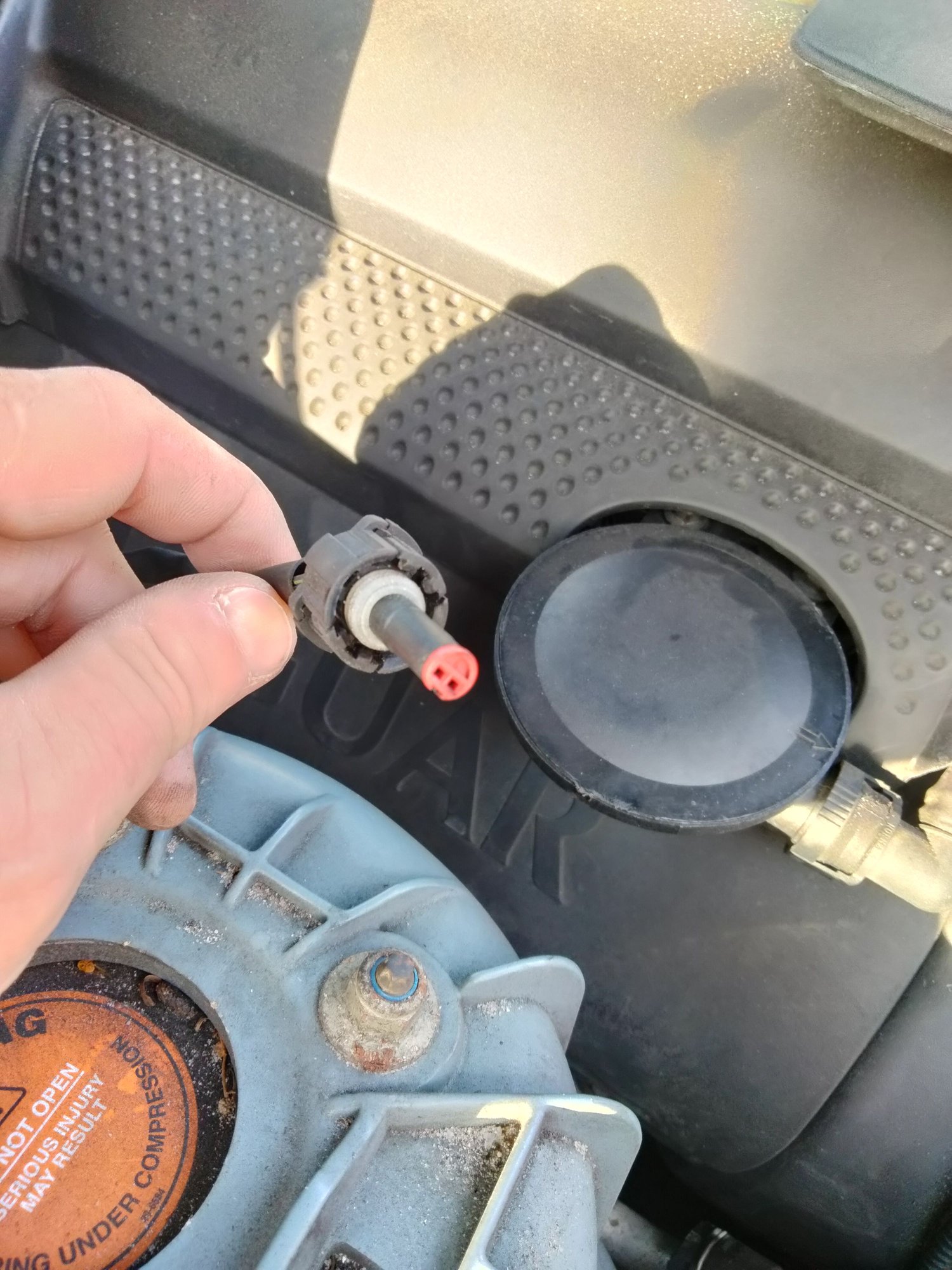

I recently purchased a 2004 XJ8 for my wife. I am giving it the once over and found 2 things that I can't find an answer to. (My google skills must be lacking).
There is one wire near the passenger side front wheel well that isn't connected to anything, can't see where it goes down below and don't see any unconnected fittings.
On the driver side, there is a hose that isn't connected to anything, it has a screw end. Again, I can't find any unconnected fittings there aw well.
Any idea what these are? Appreciate any help.
Thank you.

You are posting in the wrong forum but......
Your suspension has been converted to steel coil springs.
Nothing for the pipe and wire to connect to.

As you have already been informed, the air hoses you found originally connected to the air spring bladders, and the electrical connectors connected to the ECATS solenoids in the tops of the shock absorbers for the Enhanced Computer Active Technology Suspension, which had the ability to change the damping rate of the shock absorbers between Firm and Soft during cornering, acceleration and braking. The coil conversion kit does away with this capability but it also does away with the problematic and leak-prone air springs.
