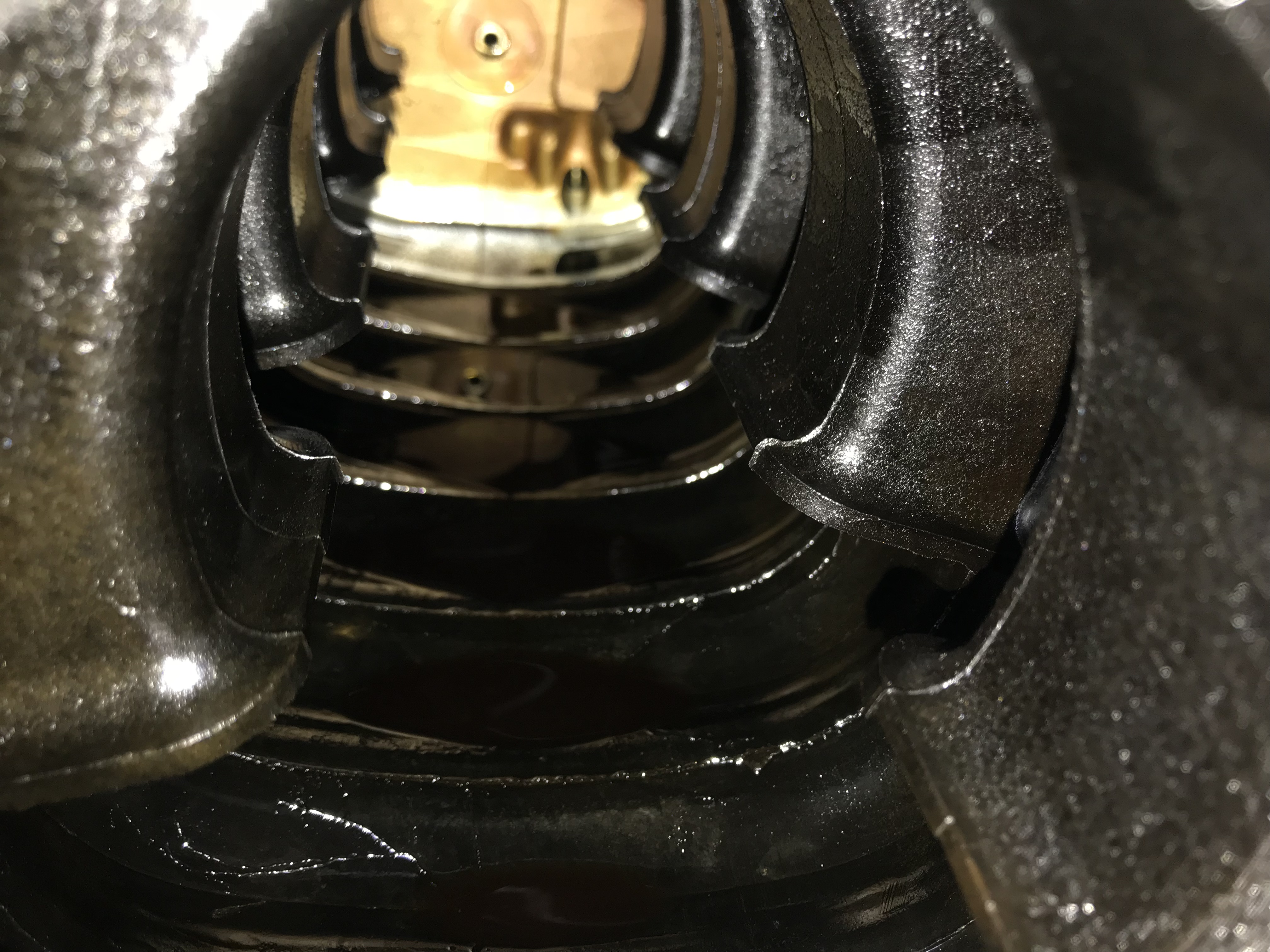

Dear Forum,
I have been posting on this forum for some time regarding the occasional huge plumes of grey smoke pouring from my exhausts combined with a strong smell of burning rubber. One of the steps I have taken is to fit an Oil Catch Can between my PCV Valve and my inlet manifold. Yesterday I drove 140 kilometers (87.5 miles) and it collected 200 ml's (a little under 1/2 a pint) of oil!!
Apart from this, my 100,000 mile engine seems okay and to have plenty of power? Surely if this is being caused by blow-by this level of blow-by wear would result in poor performance?
Any ideas, please?

That is a heck of a lot of oil Esray.
Have you done a compression test?
That would possibly alleviate piston ring/bore wear.
If no ring/bore wear then you possibly have very high pressure in the sump for some reason.
I should add that if a cylinder has low compression you need to inject some oil into it and if there is still low compression it is something to do with the valves and not the rings.

Thanks John - That'll be my next move.
Puzzling, though - there does not seem to be any power issues? I would have thought that piston ring blow-by sufficient to cause this amount of oil loss would also result in power loss? However, I do not know of any other causes of excessive blow-by other than valve seals and piston rings/bore wear? I will be interested to take a good look at the oil separator under that Cam Cover when I remove it (AGAIN)!

My next big job (will have to be deferred until I sort this out one way or another) was to be replacing the Timing Chain Guides, because I think worn guides are the reason for my very slight engine 'tremble' at idle and for a 'whining' noise coming from the timing cover. Every now and then, I think my timing chain slips in or out of the 'groove' it has created for itself, and in so doing, alters the timing fractionally?
Is it possible that the effect this (possible) timing issue has on valves opening and closing (perhaps fractionally out of sync with the Camshaft Sensor) could be contributing to this excessive crankcase pressure?

XJ8JR & Don B, thank you for your responses. I have already replaced my PCV Valve. Any thoughts on my suggestion that a slack timing chain may be affecting my timing sufficiently to be a cause of excessive blow-by, please?
Blowby is the result of worn piston rings. Nothing at all to do with timing. The only determental effect of a worn timing chain is either poor performance or the valves crashing into the pistons (on an interference engine).

Proper testing has to be done both wet and dry for compression. (and the difference between them) Cylinder leakage tests must also be performed at TDC for each cylinder. I am suggesting however, that the AJ8 doesn't normally suffer issues with excessive blow-by, and the normal operation of this engine, as with all engines, does have some oil usage. Moral of the story is, it is normal for some oil mist to pass into the intake under normal conditions.
Okay, the compression tests are in: 5 cylinders have 148 psi and three have 135 psi.
The mechanic I asked to conduct the test is saying that this is okay?
Any comments, please?

Everything I have read about compression tests would confirm those readings are all within accepted tolerances.
Did you do a "wet" compression test as well? With some oil injected into the cylinders.

Thank you John.
I have asked if a wet test was done. Communication is a little tricky, the mechanic is Syrian and does not have much English and I must admit, my Syrian is a little rusty; in fact, corroded beyond repair would appear to be a better description!
I am having the timing chain guides/tensioners looked at. There is a tiny miss; a 'tremble' at idle and occasional chain noise. My inexpensive Syrian mechanic (ex Jaguar Dealer employee here in Dubai) believes that the Timing Chain Tensioner Blades have a groove worn into them which allows the timing to fractionally slip from time to time, as it goes in and out of this groove. I have asked on this forum if this could cause excessive crankcase pressure through (say) a valve temporarily being miss-timed with regard to the Camshaft Sensor and (perhaps) allowing compression to escape into the crankcase, but was informed that there can be no link between timing and excessive Crankcase pressure.

Just to end this post the problem was a 'Drum'? in the gearbox that was cracked nearly in two. When the trans got hot, the crack expanded, leaked oil and locked the third (I think) gear up. This intermittent 'seize-up was also what caused the billowing grey/white smoke out of my exhaust! I must admit, I still do not understand why a fault in the gearbox should cause smoke from the exhaust - But since the problem has gone away, perhaps I shouldn't care?
