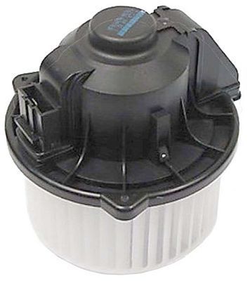

As I said, new rad, new hoses etc. even new blower, flashed system no loss of coolant
What do you mean by, even new blower?
Well, there is little fan that pushes hot and cold air in saloon to keep it comfortable
inside in the summer and winter commonly called "blower" which we have to replace
because it has bad bearing.

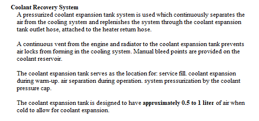

I am fairly certain the cooling system in the Jaguar automatically removes air. I have had my system apart a few times and never had to do anything other than run the car a bit after I had the system connected, and gradually add coolant after a couple of drives. AllData states that it can be done both ways. The only special bleeding instructions are if you drained the SC system. I would argue that if your system is not purging air automatically then you have a block somewhere that is causing some additional headache.
In fact, here is some additional info as it relates to the expansion tank:
