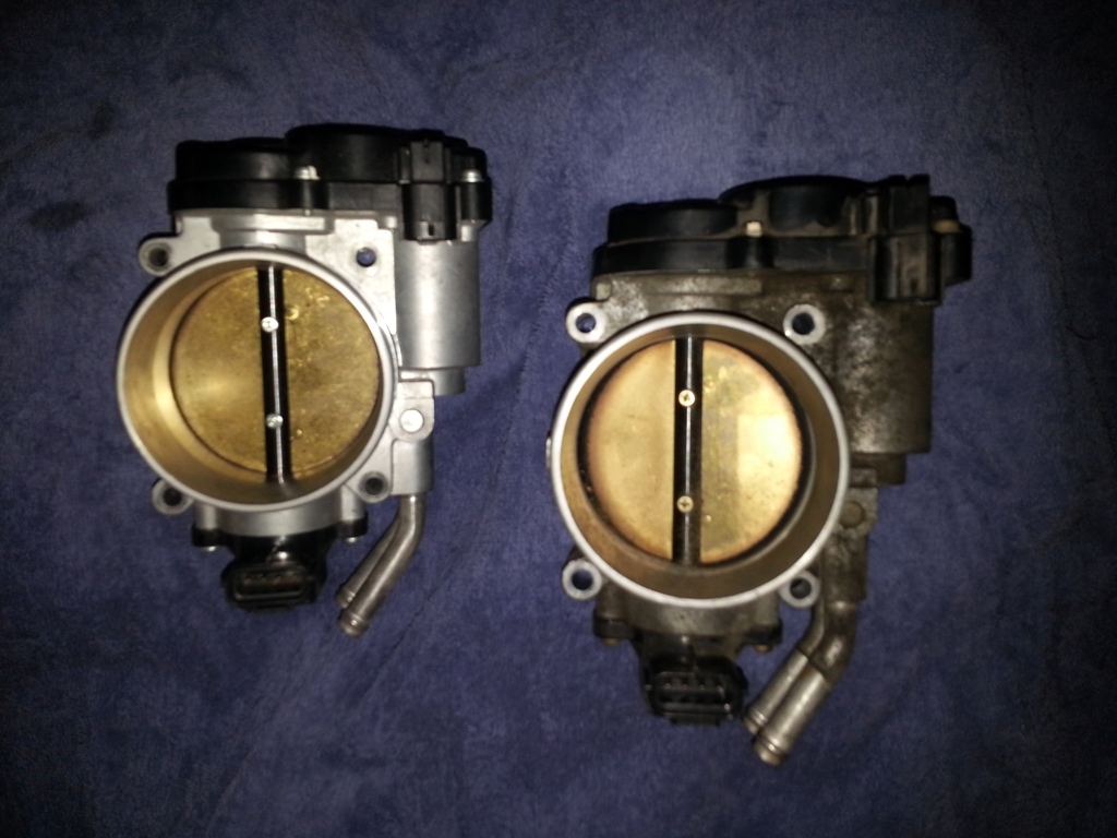

Well that's a job I don't want to do again....
I was hoping to just swap the TPS, but you can't get to one of the 5-point Torx bolts while it's still in the car (hoses in the way) so I swapped the whole throttle body...
There's just no room to get in there...
Didn't take any pics, was too busy getting on with the job, but here you can see my old throttle body, compared to the complete replacement which I bought 2nd hand.
The dirty one is the one that came off my car...LOL
Hopefully the TPS in the replacment is OK, it looks to be much newer.
ECU reflash went without a hitch, started up OK and no codes, just about to go for a drive to see how it goes, wish me luck...
