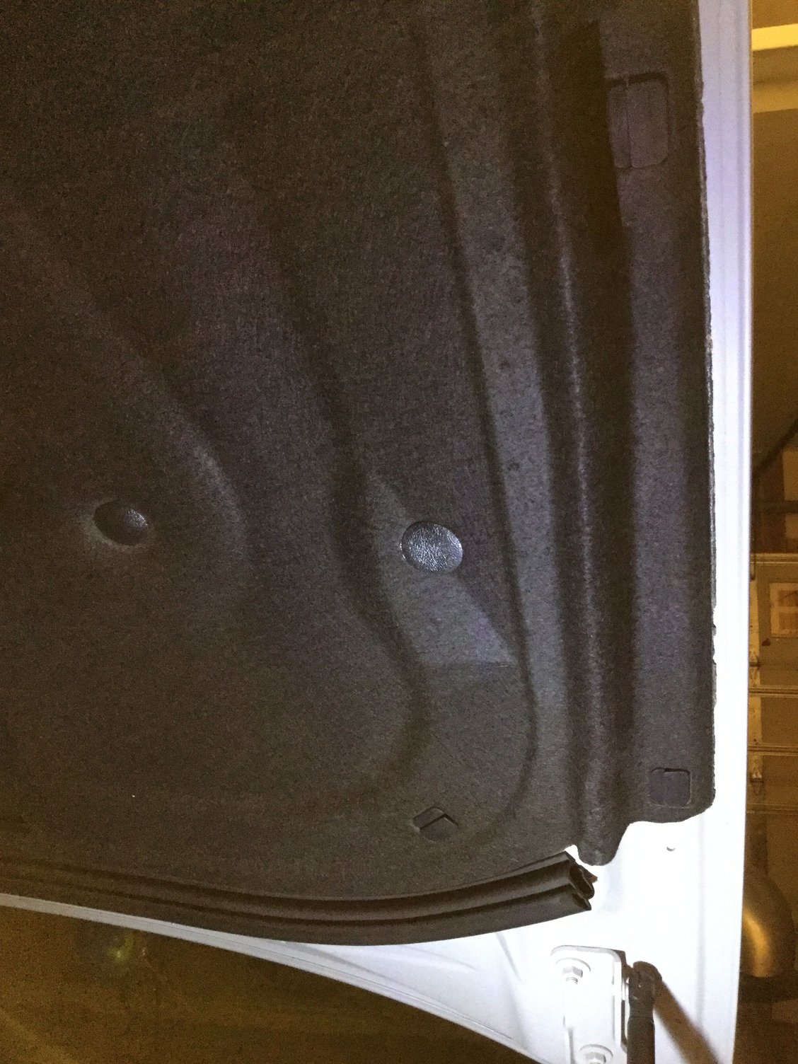

A few days ago, I noticed the padding from the bonnet hanging down on the drivers side of my 2005 Jaguar XJ8L. Actually, I'm not sure what kind of adhesive I could use to secure that padding. Any tips or suggestions? Thanks.

This is your hood Insulation, and i is held up with clips, no glue that I know of. Hope this helps.

No clips that I could see on the part of the insulation that's hanging down.

Old May 8, 2022 | 10:28 PM
Luke2004xjr's Avatar
Joined: Feb 2015
Posts: 136
Likes: 53
From: Georgia
Right above where it is hanging, it is attached/ How is it attached? When I loo up the parts for the car, it show clips for it. Here is a picture. It shows some round and rectangle clips. Hope this helps. Be kind and think of others
