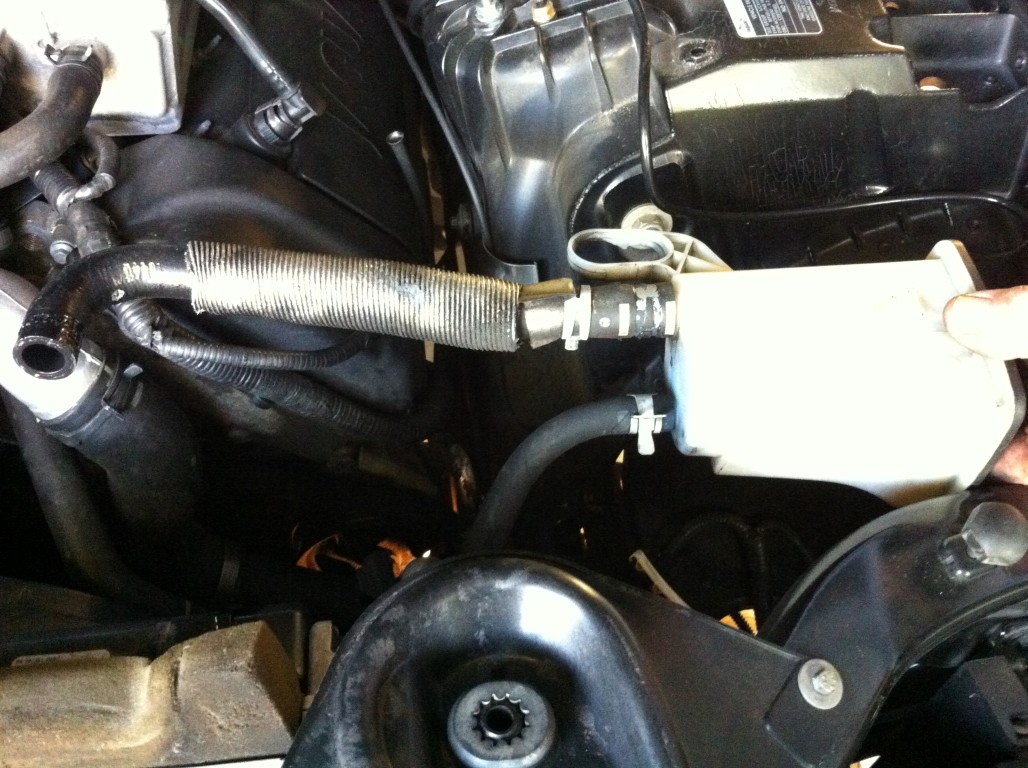

Hello-
Am looking to replace the hose from the power steering pump to the resevoir.
Using the resources here on the site, and speaking with a parts supplier and local jag parts department, it is unclear (to me and the others) what the part number for such hose would be.
Using a forum favorite parts supplier, I had them ship me a hose. The hose that was delivered connects from the base of the reservoir down toward the pump. The issue is that this hose (C2C6157) is about a foot long, takes a right angle and ends there.
I was expecting a hose that runs completely from the ps resevoir to the nub on the drivers side (US) of the power steering pump.
Would anyone have the part number of the hose that travels from the ps pump UP toward the resevoir? Or any other advice regarding replacing this...
Please see pics for reference.
-or-
Can a couple feet of hose from the local NAPA work just as well?
Any secrets to a successful 'clamping' on the power steering pump end of the hose?
Thanks in advance
-mag
Attached Thumbnails Power Steering Hose - Part Number-img_1155-medium-.jpg   Power Steering Hose - Part Number-img_1156-medium-.jpg

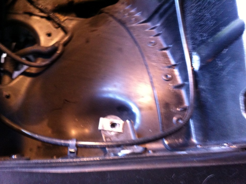

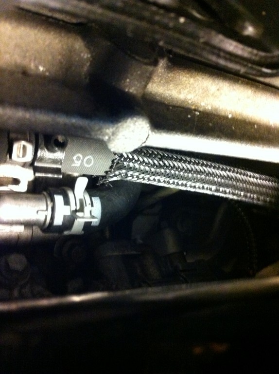

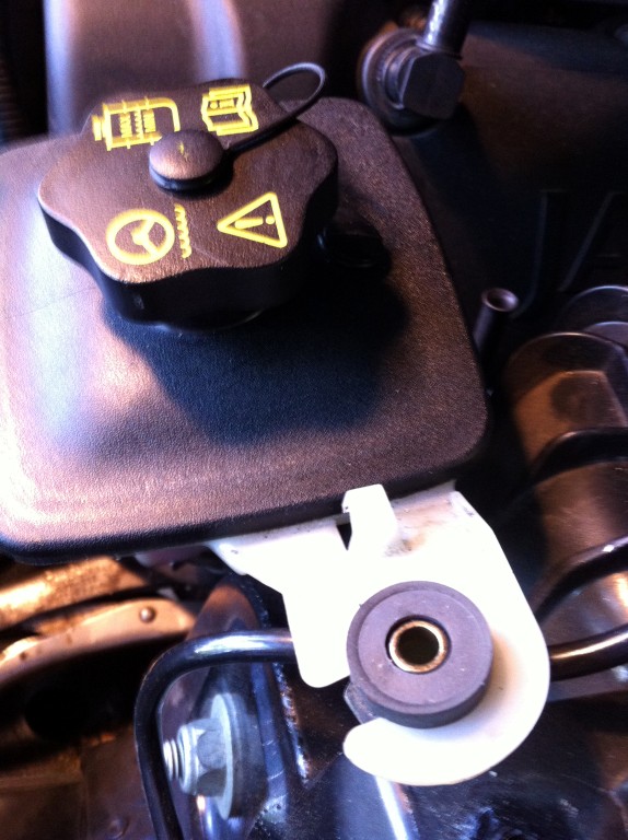

OK, as it turns out C2C6157 is the proper hose and contrary to what I (mis)understood, it is a single piece from resevoir to ps pump.
Here are some pics from the replacement.
-mag

Get a universal power steering hose from the local autoparts store. I got two feet of hose from autozone last year. The trick to the bend is to cut the hose longer so that it loops without a kink. Switch out the heat shield from the old hose and fill her up with mobile 1 ATF. I've been rolling like this for over a year no problems at a cost of about $6.
