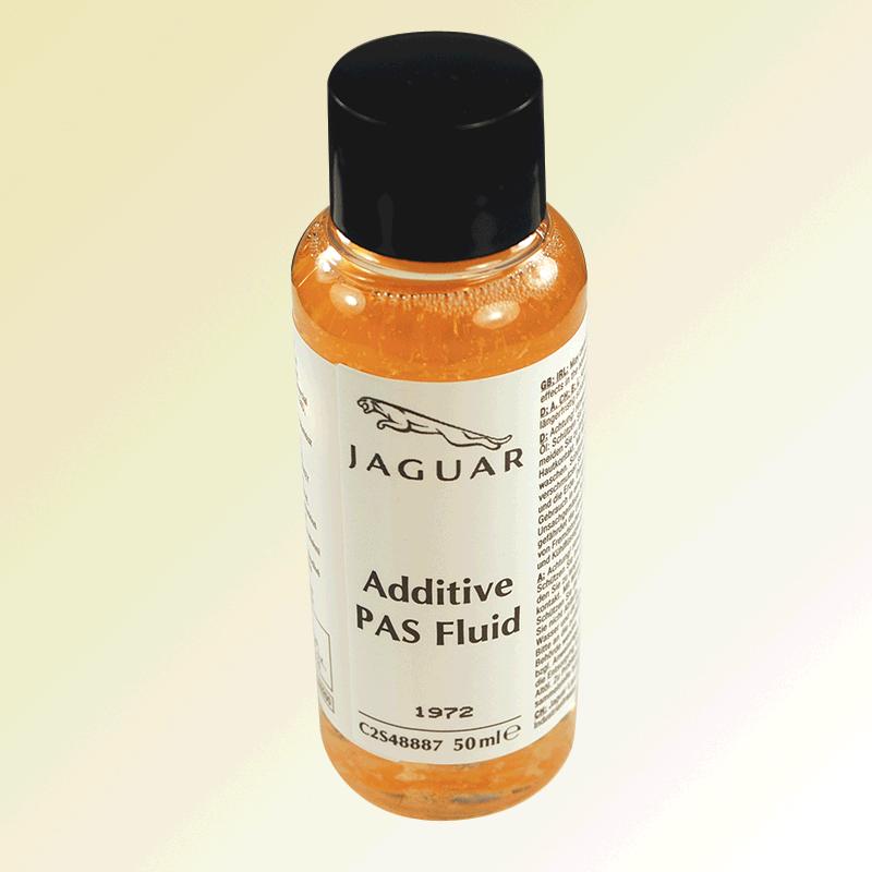

Here is Jaguar's TSB regarding power steering squeek noise. The Jaguar additive is JA-C2S-48887 - P/S Additive Power Steering Additive and cost about $9.00 for the 50ml bottle.

From: Woodhaven, NY
Thats the additive i put to no avail unfortunately. i just ordered two bottles of it and hope that this time with twice the amount, it will rectify the issue.
