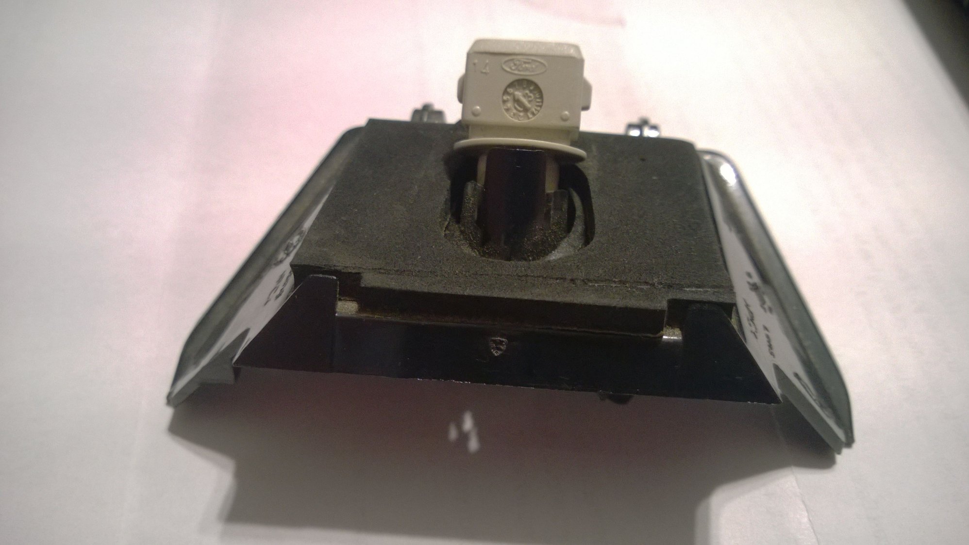

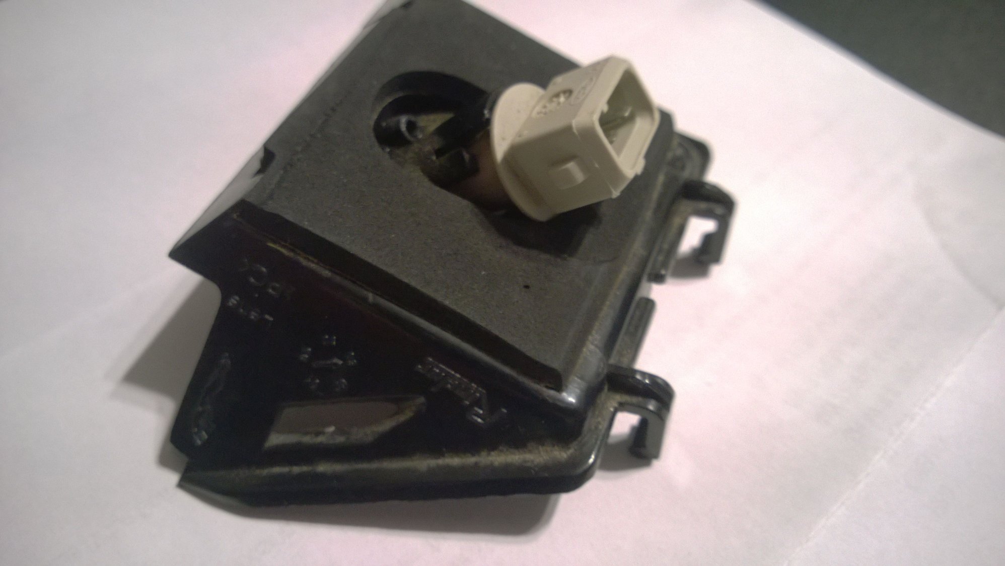

G'day, Has anybody had issues with the number plate light globe holders and mounting melting (please see attached photo's)? And does anybody know how to get the black mounting section off the trunk please? I have removed the liner from the trunk lid and the plastic trim (with JAGUAR lettering). Still cant see how to get the mountings out. Kind regards Gary

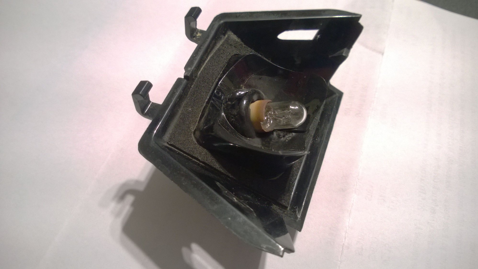

Not sure if this will help, but here are a few pics of my spare assembly. Looking at the hooks, my guess is that the wide side needs to be popped loose first, then hinge outwards.

Hi Dave, Thanks for the photos. I note that the bulb holders shown heat marks - must be a common problem. I will fit LED globes when I replace mine to reduce the heat. Regards Gary

No problem Gary. I installed LED's in most of my LED lighting(including license plate lights), and I am happy with the results. I bought that assembly pictured for the lens, as my car was missing the lens. I only noticed it fell off when I went to open the trunk and burned my finger on the bulb. Luckily, I had plenty of LED bulbs laying around, so I swapped them in.
