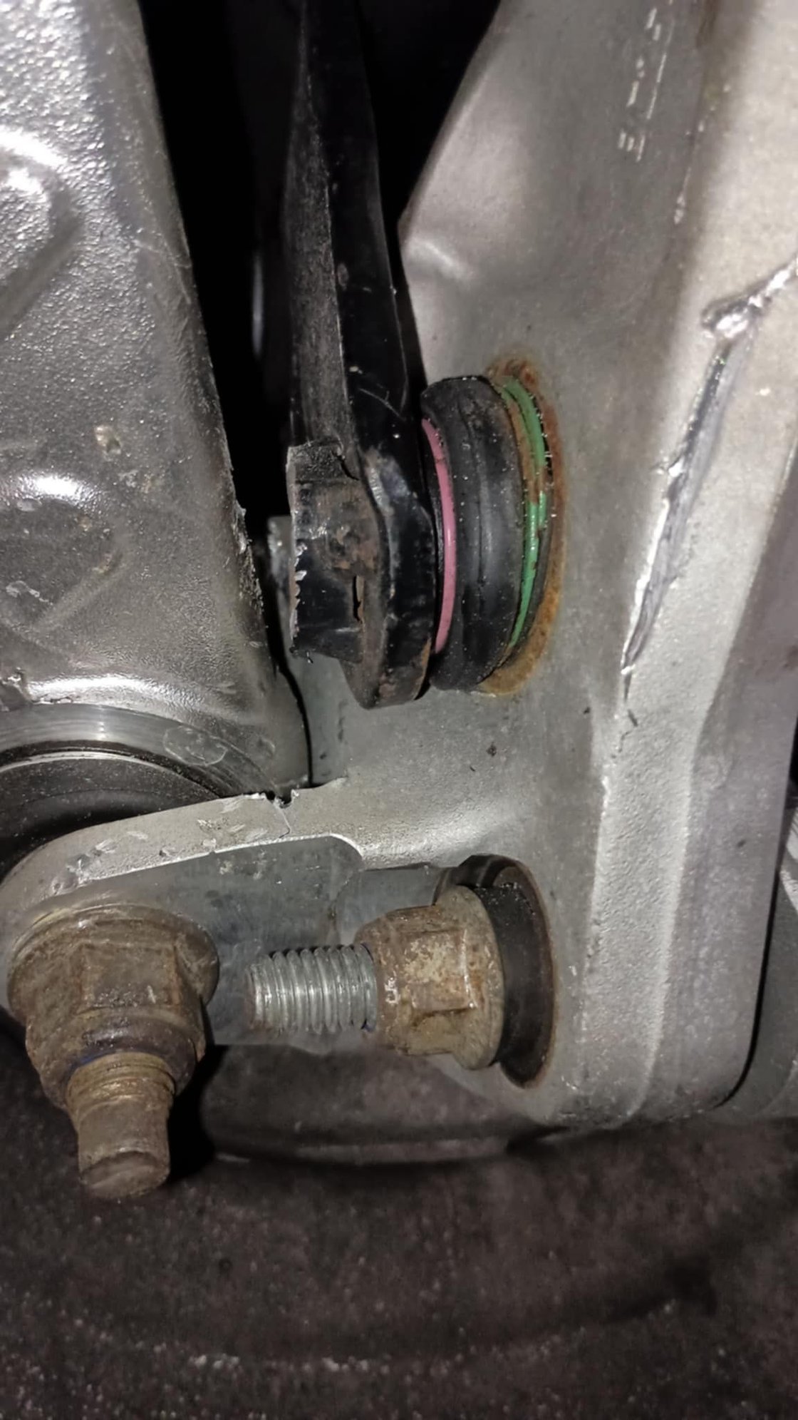

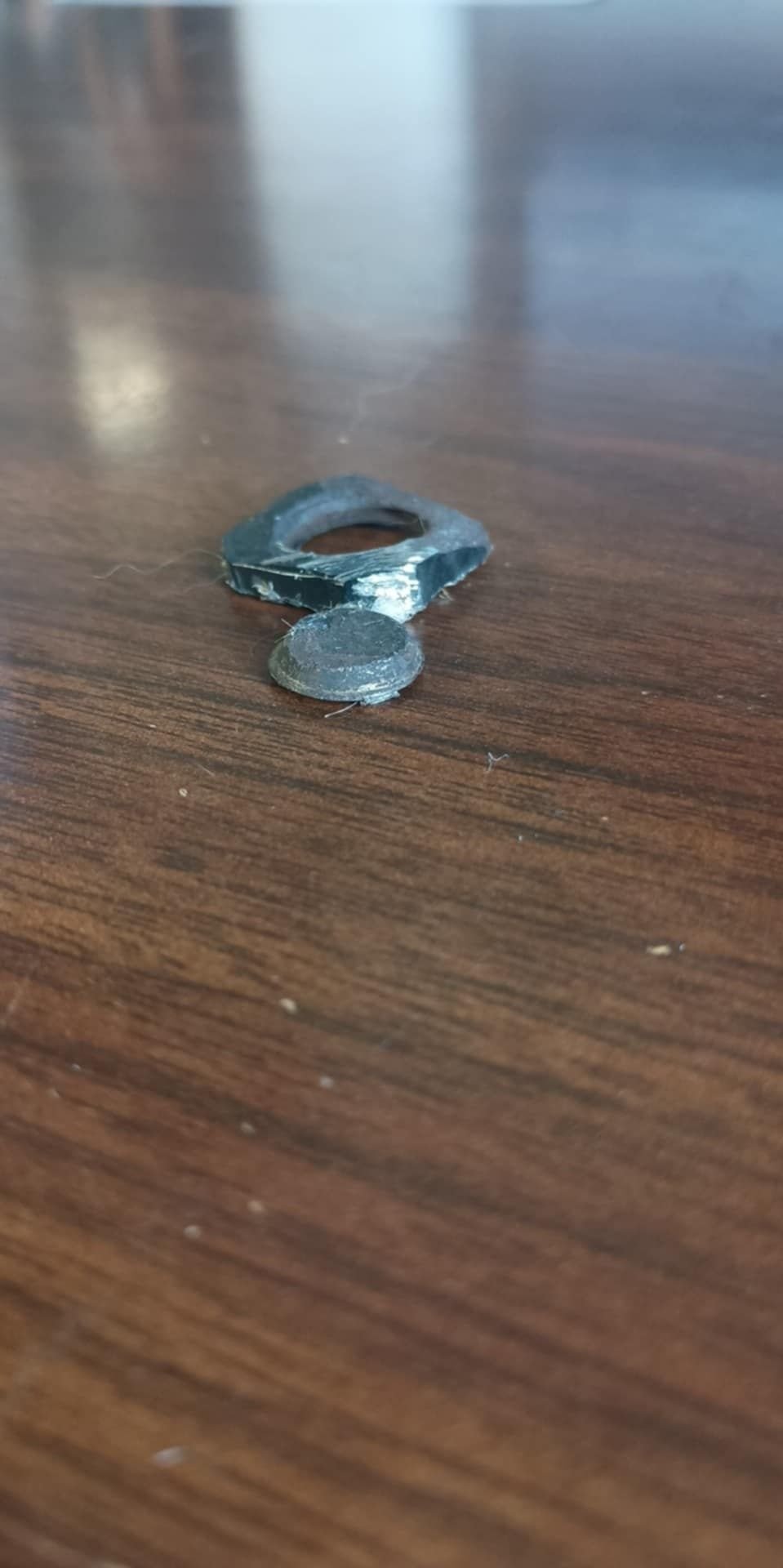

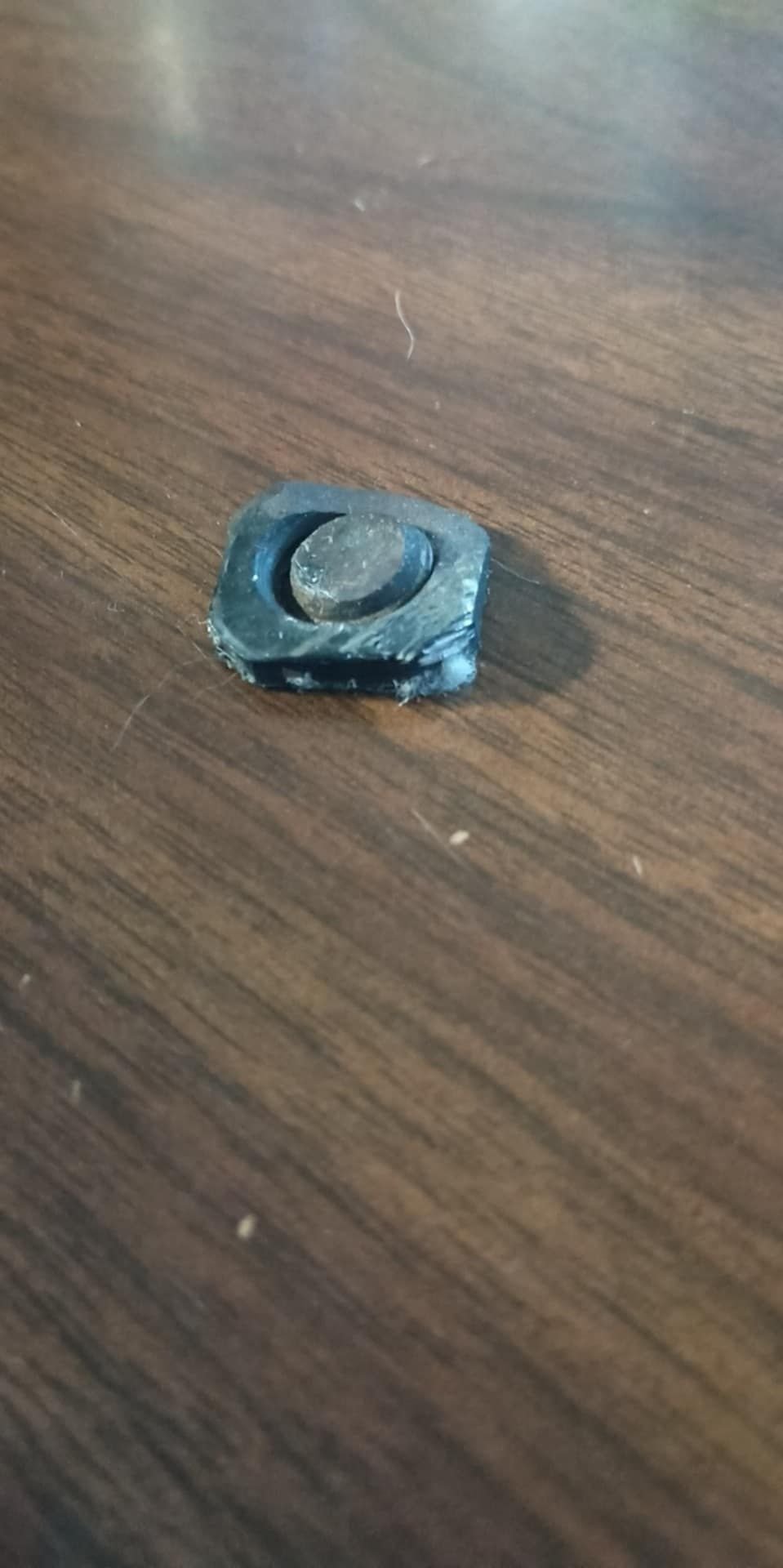

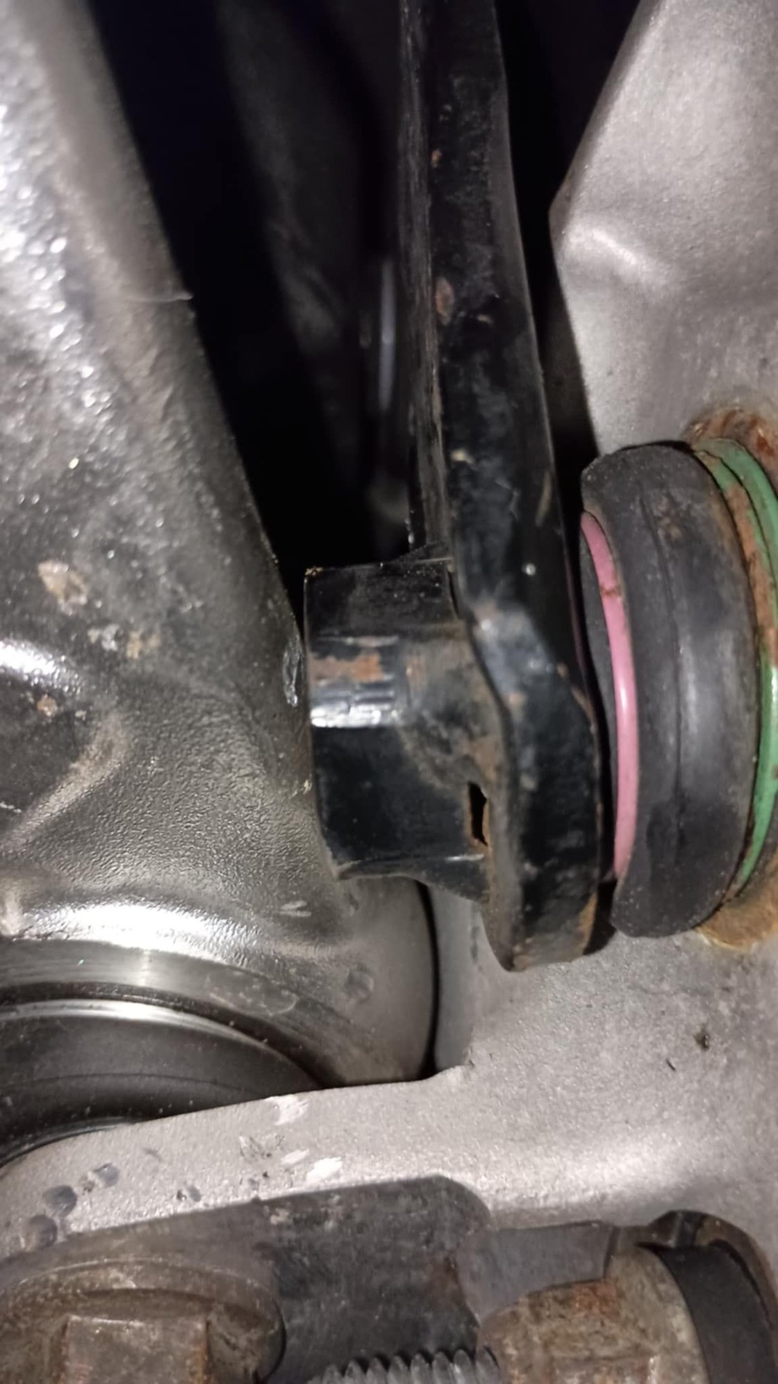

Figured out I had the welded fixed square nut on the struts rubbing on the banana arms BAD I cut off the area that was rubbing on one side took away most of the noise ill do the other side tomorrow. Still have the steering wheel wobble lol

Cutting off part of the thread is something I definitely would not have done, mainly for safety reasons because it weakens the connection. I would not like to have it breaking at any speed...
The car was not designed for the two parts to be touching and creating noise, so if that happened, I would have checked whether everything was put together correctly, or whether some new part was defective.

Never in a minute. lol look how much was removed, not even a full thread. Its all properly put together I have been wrenching all my life. Seems the nut was not seated onto the strut all the way before they welded it.

Even so... my reasoning is that the car did not have the problem when it left the factory, and it should not have the problem after replacing the suspension.
Yes, not much was removed, but it would still be too much for me. I fear a weakening due to higher corrossion in the long run, for example. But then, I often do take my car to speeds well above 200 km/h...

I agree maybe an issue with aftermarket struts.
