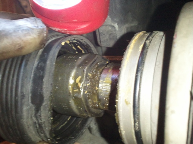

finished the inner tie rods they were relativly easy remove the tie rod end from the hub then take off the retaining clip that holds the rubber boot on the inner part of the steering rack then I used a big cresent wrench to loosen and remove the inner rod piece of cake. one of them was extremly easy to move around and the other one was not as bad but replaced both anywayone of the original tie rod ends was frozen on so to get the plastic boot off I sawed it in half being it was junk any way. This was the inside boot of the one that was really loose looks bad but not sure what it shouldve looked like I marked and measured the rod end to try to get my alignment as close as possible before taking it to get aligned hope everything is good now
