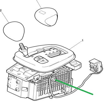

Here is the manual override for the gearshift interlock.
It looks like a wingnut, and supposedly pressing down on the forward "wing" will release the shifter. I am getting this information from another post.

So you have the beeping, this means the j-gate assembly is getting GND. Next question, is it getting 12 VDC? It will probably be different for your XJ, but the fuse on the s type for that 12 VDC is F15, a 5 amp fuse, in the primary junction fuse box. This fuse is also for the transmission control module and the generator.
This is where the wingnut is located. You should be able to turn it with a long skinny screwdriver.
