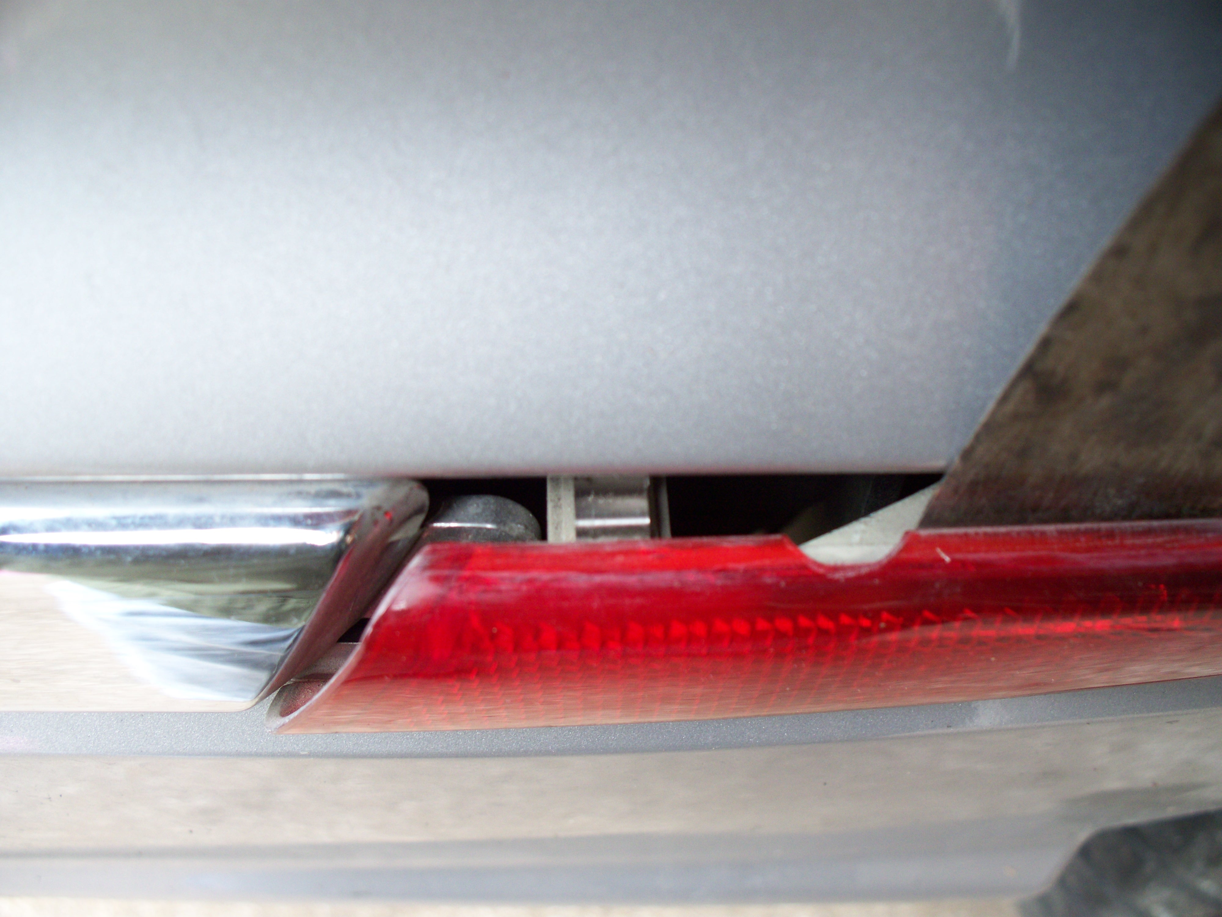

I tried it again. I had just trimmed my fingernails so I tried a 3 " wide putty knife. The right front still doesn't want to give at all but I was able to pry the right rear out a little with the putty knife and another pry behind it but I still cracked the top of the lens when I tried to get it farther out. It appears the rear spring clip would come out at the back, but the front clip must be bent up inside the bumper cover and holding it in. Looks like I'll have to pull the wheels and fender liners and come at these from the back to replace the lamps. Darn!
Now that I've voilated my cardinal rule of DIY which is "First, do no harm" I just hope I can glue the little crescent of plastic back on this rear lens. So far it's not been my best day.

OK, the lens is glued - not perfect but passable. A little superglue, some wet-or-dry, and some swirl remover and it is probably not noticable except to the dummy who did it.
I'll try not to do this again.
