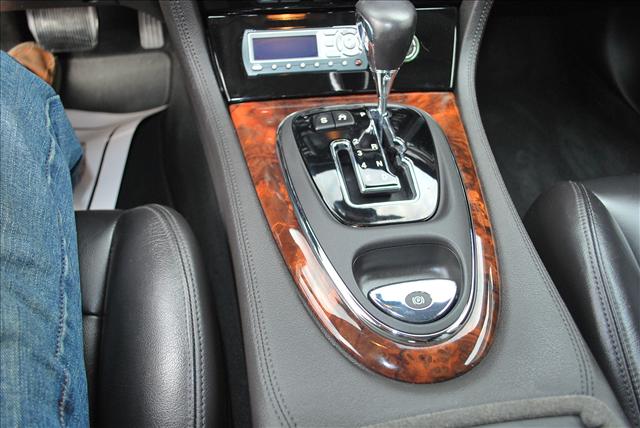

Greetings....new here. Just recently purchased a 2006 XJR with, what I'm assuming is a factory-installed Sirius Sat. Radio. I reside in Hawaii and sat. radio doesn't work here. Does anyone know how the sat radio connects to the rest of the sound system? I believe I can use the same connection for an Ipod fm transmitter. I believe it is wired through the radio antenna, so adaption shouldn't be a problem.
My big question is, How do I get this center panel out....I can't figure it out. Did a search here with no luck. Any help is appreciated.

The Sat radio uses FM modulator and is connected to the antenna of the regular radio. There is no RCA input. You can get the same resuts with any after marked FM modulator for iPod - you dont need to connect it to the antenna, the radio will pick it up. Jag sells an iPod connector module, if you want to go that route.
For the best instructions. Go to the sticky post on the top of this forum, where you can download the user manuals. From the list on the left select "accesory installation", then you can download the install manual for the sat radio.

If you are removing the center console, be careful - there are two springs on the top and they may scratch the wood veneer when you pull back and the front goes up then the springs are unlocked.
It's best done by two people.

Well, to simplify the install, I used and adapter for the sat. radio FM transmitter (already wired in) to hook up the Ipod controller. Works like a champ. The display unit and the controller are just temp mounted with 2-sided foam tape until my ashtray cover comes in, then I'll install the display unit in that like the sat radio is in its own panel.
