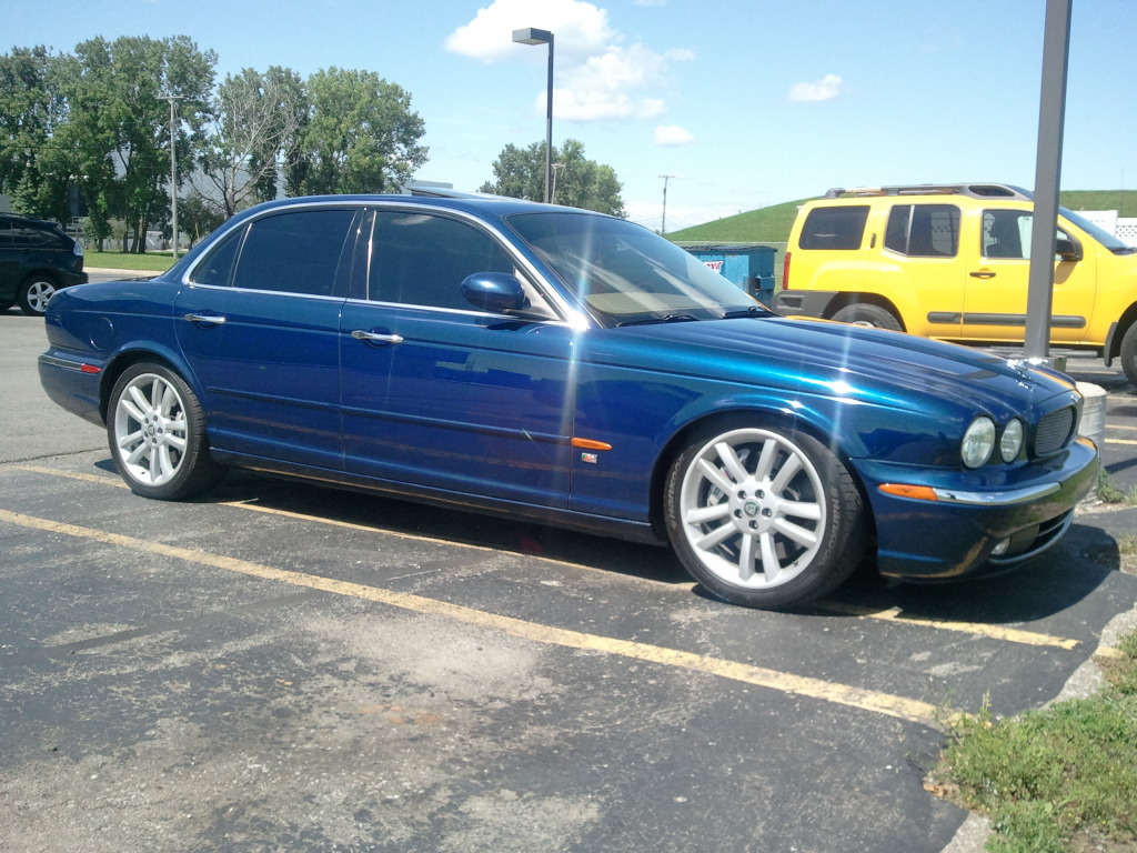

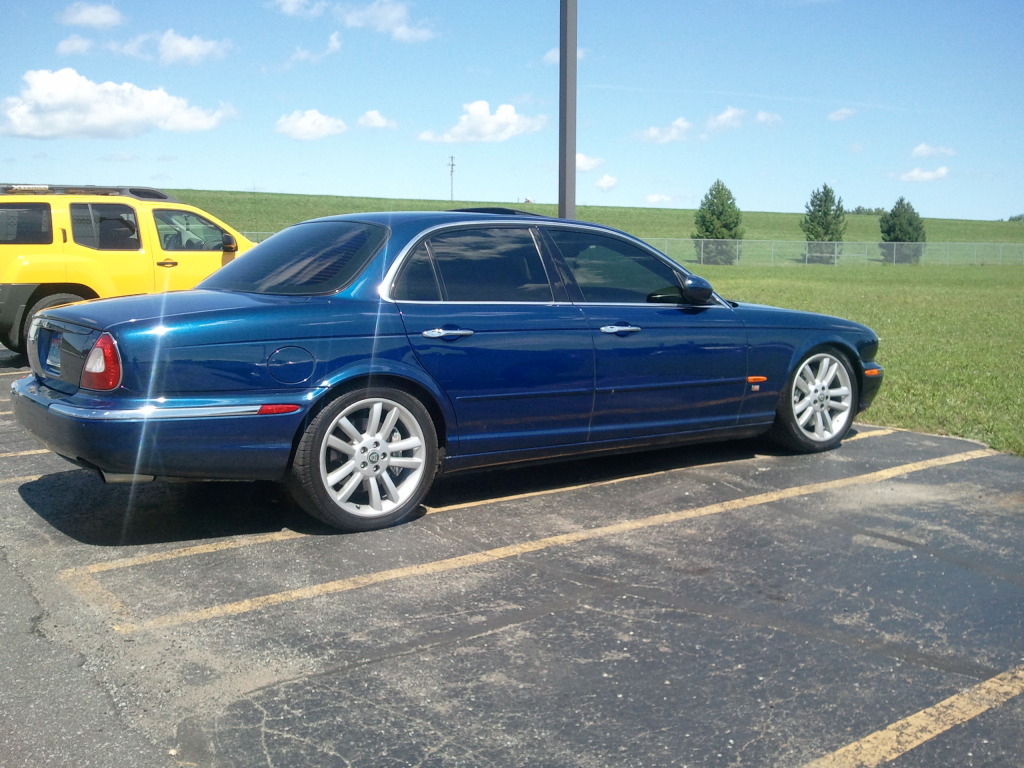

Blew passenger side of the shock yesterday...

I haven't found any oil leak yet. What it does is when it's siting like that, and I proceed to start up the car, it'll pump up to a certain level and then once it pass a certain height and you'll hear the hissing sound and car car will be dropping slowly despite the pump is still running.
When the bag blew we just park the car and me and my wife heard the sudden hissing sound like the air purging sound but this time it's couple times louder and couple times longer. Regular purging sound is more like 0.2-0.4 second type of purging but this time it's like purging for 2-4 second type and that corner drop down pretty rapidly, and a moment later the driver side dropping too I'm guessing the car trying to maintain the ride height and balance and the dash came up with the fault message and light at that moment too.
Order the shock thru Arnott today and should be here in a few day. Luckily it happen now because this weekend I have a 600 miles roundtrip drive and guess it'll be the wife's car instead of my Jag.

Don't start it or drive it like that if you can avoid it. You will damage the compressor. Basically it's tantamount to you trying to fill a balloon with a hole in it, and keep it filled. The compressor isn't designed to constantly run. Simply to make adjustments based upon load.
The shock is a pretty straightforward swap. Make sure you disconnect the battery and then restart the car once everything is back together. You may get an air suspension fault at the first startup cycle because the resevoir will be empty, and it may take the compressor more than the 300 second threshold they have allowed to get the car to operating pressure. (That's what 90% of the air suspension fault errors are especially when it's cold out). It should go out on the second start cycle.
