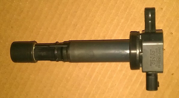

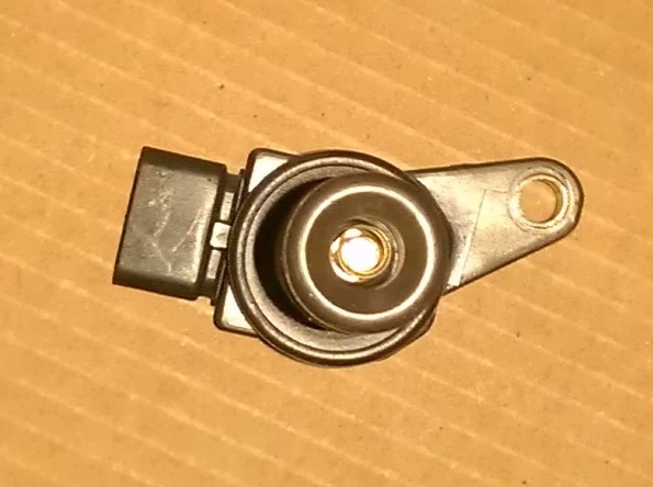

Old Feb 1, 2012 | 08:20 AM
reyesl's Avatar
Joined: Nov 2011
Posts: 817
Likes: 258
From: Saint Robert, MO
Some photos of the Ignition Coil.
We'll, getta go....
Attached Thumbnails Spark Plug Replacement - Help-coil-pack.jpg   Spark Plug Replacement - Help-top.jpg   Spark Plug Replacement - Help-plug-boot.jpg
