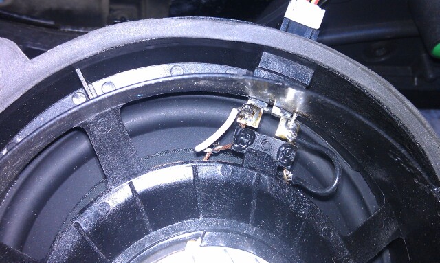

I had the same problem on my '04 XJR with the Alpine speakers. To test, just use a jumper wire from the speaker harness connector to the wires going to the voice coil. If the speaker works, you have a bad connection.

Here's a picture of one of my door speakers. The bad connection is the black one on the speaker basket. The white and black wires are the ones I added to bypass the faulty connections. I wrapped the ends around the wires going to the voice coil and soldered them, and soldered the other ends to the silver terminals from the harness connector. Tip: tilt the speaker so that any drops of solder DO NOT fall on the speaker cone.
