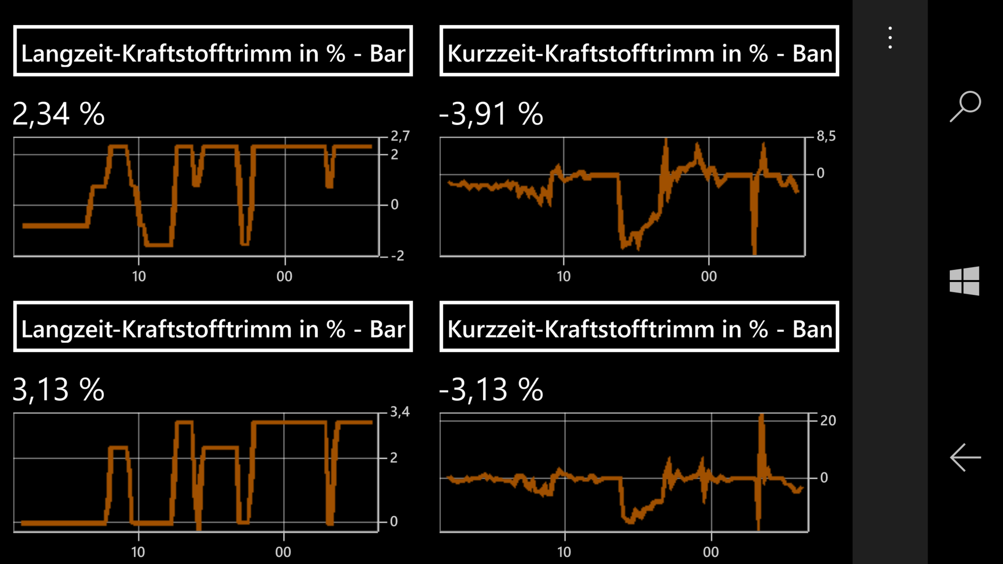

During the "test"drive (well, more for fun probably) the readings of all FTs were (sorry, German, but top is bank 1, bottom bank 2, left are LTFT, right are STFT):
@ 80 km/h
@ 170 km/h
and @ idle
Said conditions are of course always only the right end of the plot.
Amazing picture for a 15 year old lady with 200.000+ miles.
@ 80 km/h
@ 170 km/h
and @ idle
