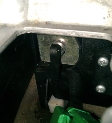

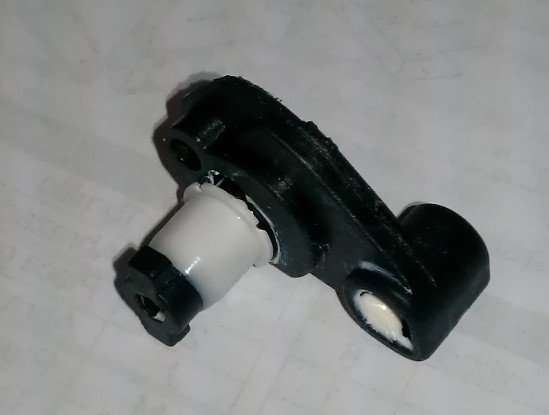

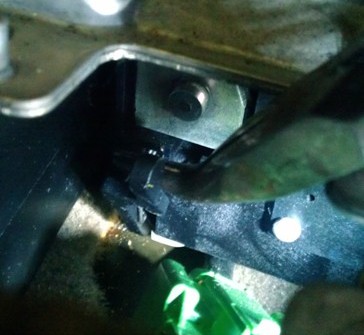

It could also be the levers and brackets that are actuated by the solenoid, attached photos. If I am correct, power has to be applied to the solenoid to shift out of park? Anyone?

So I tookthe entire console apart this afternoon.
The original owner did an amazing job killing the car.
The entire console area is covered in coke or coffee. Because it was so thick, I guess they jammed the shifter and the base broke into pieces. On top of that the parking brake switch also shows open circuit.
I pulled code for transmission it's showing shifter fault. Also EPB shows all kinds of switch open circuit fault. It also showed anti theft code.
So new EPB switch and shifter is on the way. Hopefully this will resolve all my problems.
